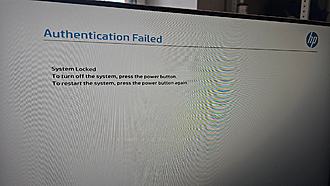

                I have a hp prodesk 400 g6 mini with locked bios.
                trying to unlock the bios but still stuck at the first steps.
                I got a CH341A programmer and a SOIC8 clip.
                The bios chip was not detected by neither neoprogrammer nor asprogrammer , and I could not find the chip model on their "supported chips" list.
                bios chip model GD25B256E
                Any kind of help would be appreciated !
                Thank you

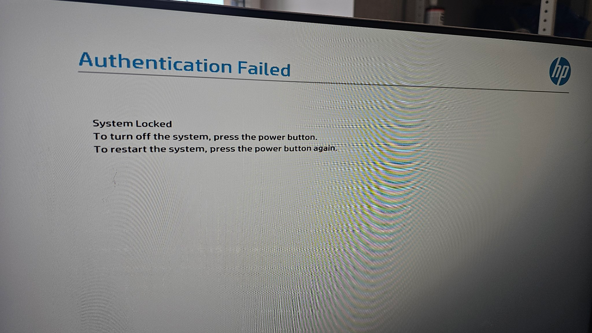

                      Hello and thanks for help.
                      But now I have another problem
                      I reflashed bios that you gave me and get this error.
                      When pc boot, first i see it is.
                      Click image for larger version  Name:	image.png Views:	0 Size:	3.06 MB ID:	3693011

                              After reflash with last file i have 5 long and 7 short buzz.
                              • evgental
                                • Jul 2025
                                • 10
                                • Kazakhstan
                                #55
                                YEEEHAAA!
                                Thanks for help for this PC.
                                The problem why I get 5 long 7 short buzz, is bad flashing.
                                Change programmer and usb port, reflash - bingo.
                                PC starts, bios unlocked.

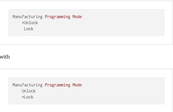

                                  Biggest cheers to you!!!
                                  With this file I reflashed 2 devices.
                                  This is step by step how I did that.
                                  1 - Run HP BIOS Configuration Utility (BCU) - to backup original ID's.
                                  1.1 - hpbiosconfigutility.exe /getconfig:"backup_id.txt"
                                  1.2 - store it somewhere where you can take it when it need.
                                  1.3 - Edit backup_id.txt, find inside string starts "Manufacturing Programming Mode" replace
                                  1.4 - Save with replace.
                                  2 - Desolder flash from motherboard.
                                  3 - Put FLASH chip to programmer (in my case I used CH341A (green version))
                                  4 - Dump original BIOS(UEFI) and store it in safe place
                                  5 - ERASE FLASH!!! (In my case this is very important, if not - flashing will false)
                                  6 - Flashing the HP ProDesk 400 G6 Desktop Mini.rar
                                  7 - Soldering flash back to motherboard.
                                  8 - Run system normally, you will see the " Manufacture Programming Mode is in Unlock" in top left corner.
                                  9 - After windows starts, we should upload the ID's back to the system to do that - Run hpbiosconfigutility.exe /setconfig:"backup_id.txt"
                                  10 - After all done, reboot the system.
                                  11 - Et voila, you are perfect.

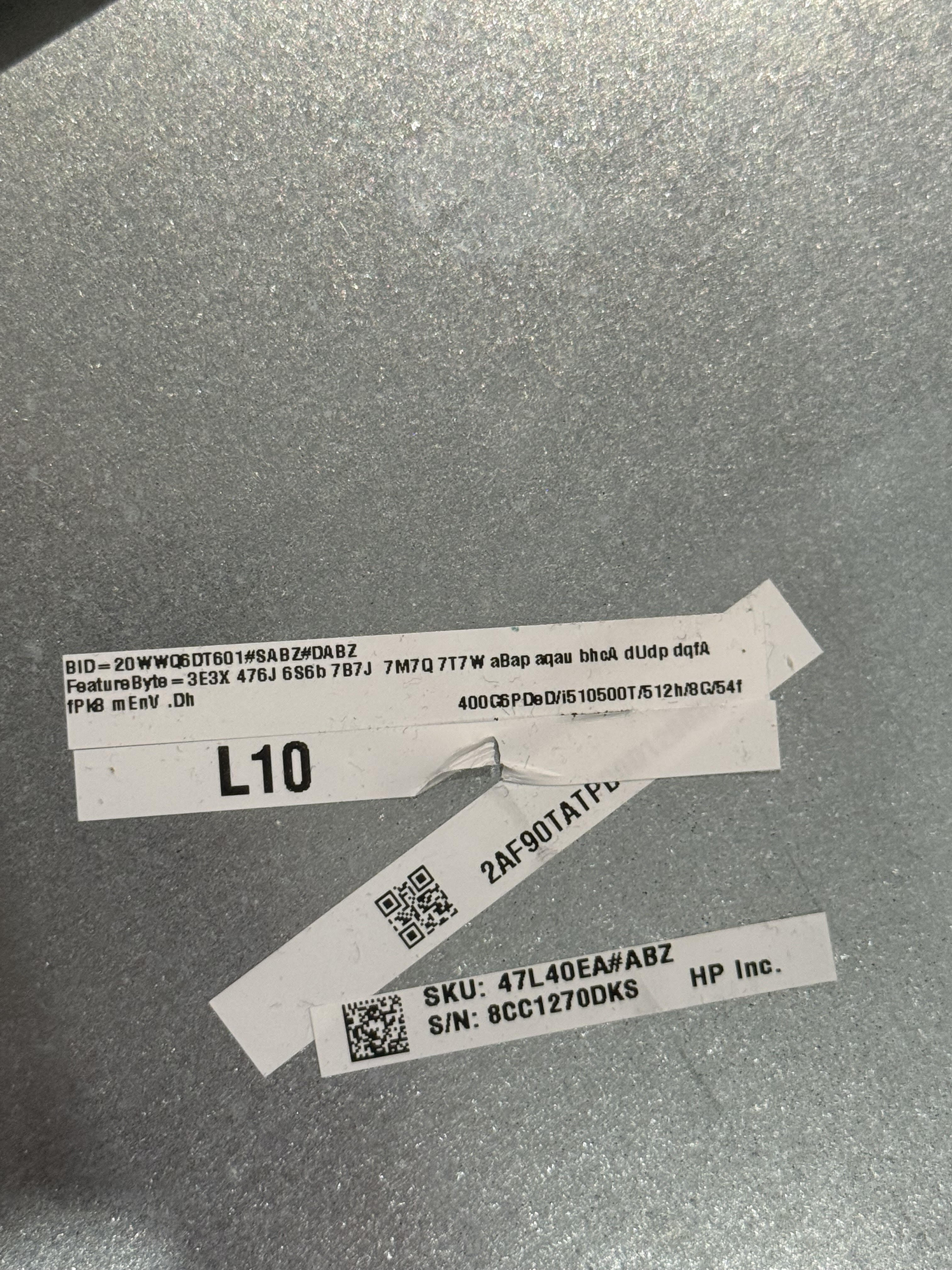

                                        Sorry forgot to add the serial number and cannot edit my post so I am adding them here:
                                        BID = 20WWQ6DT601#SABZ#DABZ
                                        Feature Byte:
                                        3E3X 476J 6S6b 7B7J 7M7Q 7T7W aBap aqau bhcA dUdp dqfaA fPk8 mEnV .Dh
                                        Not sure about the bytes.
                                        SN: 8CC1270DKS
                                        SKU:47L40EA#ABZ
