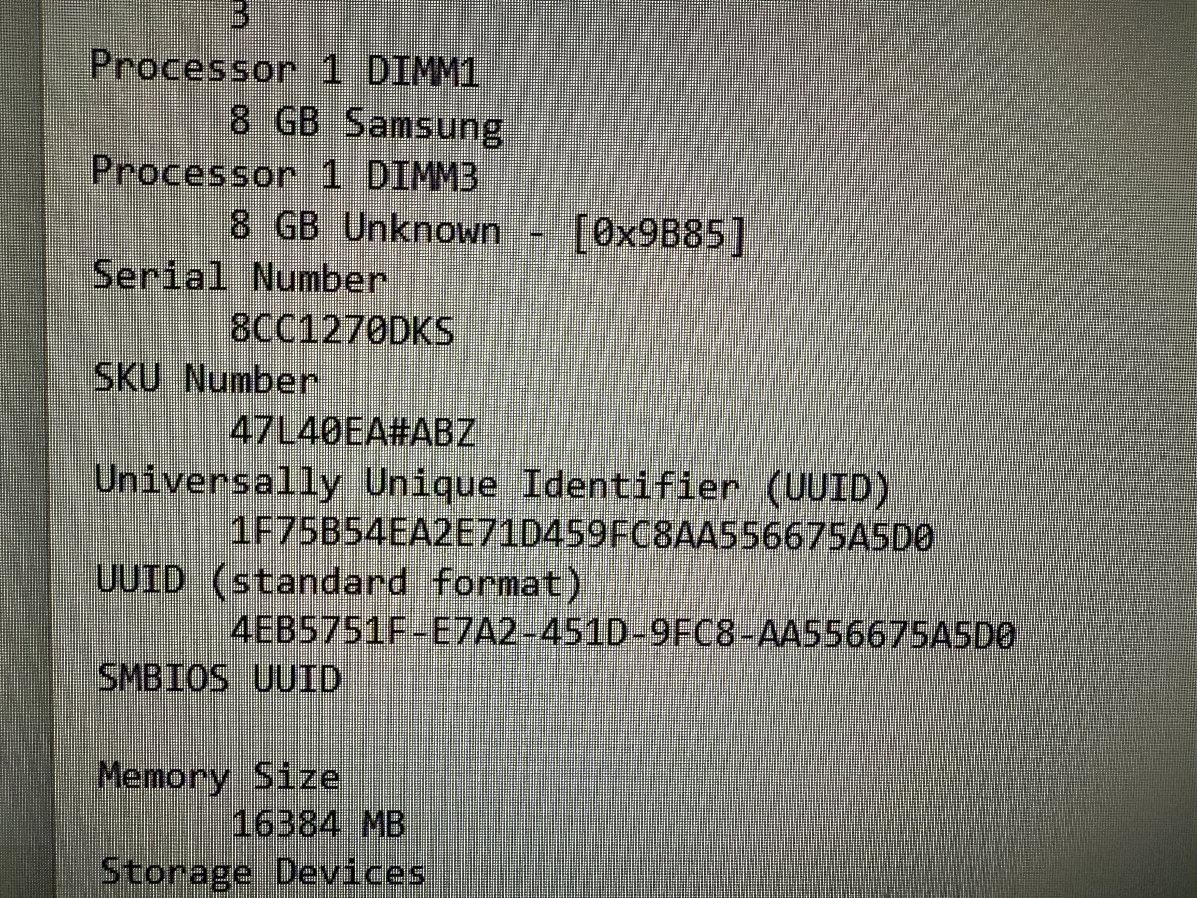

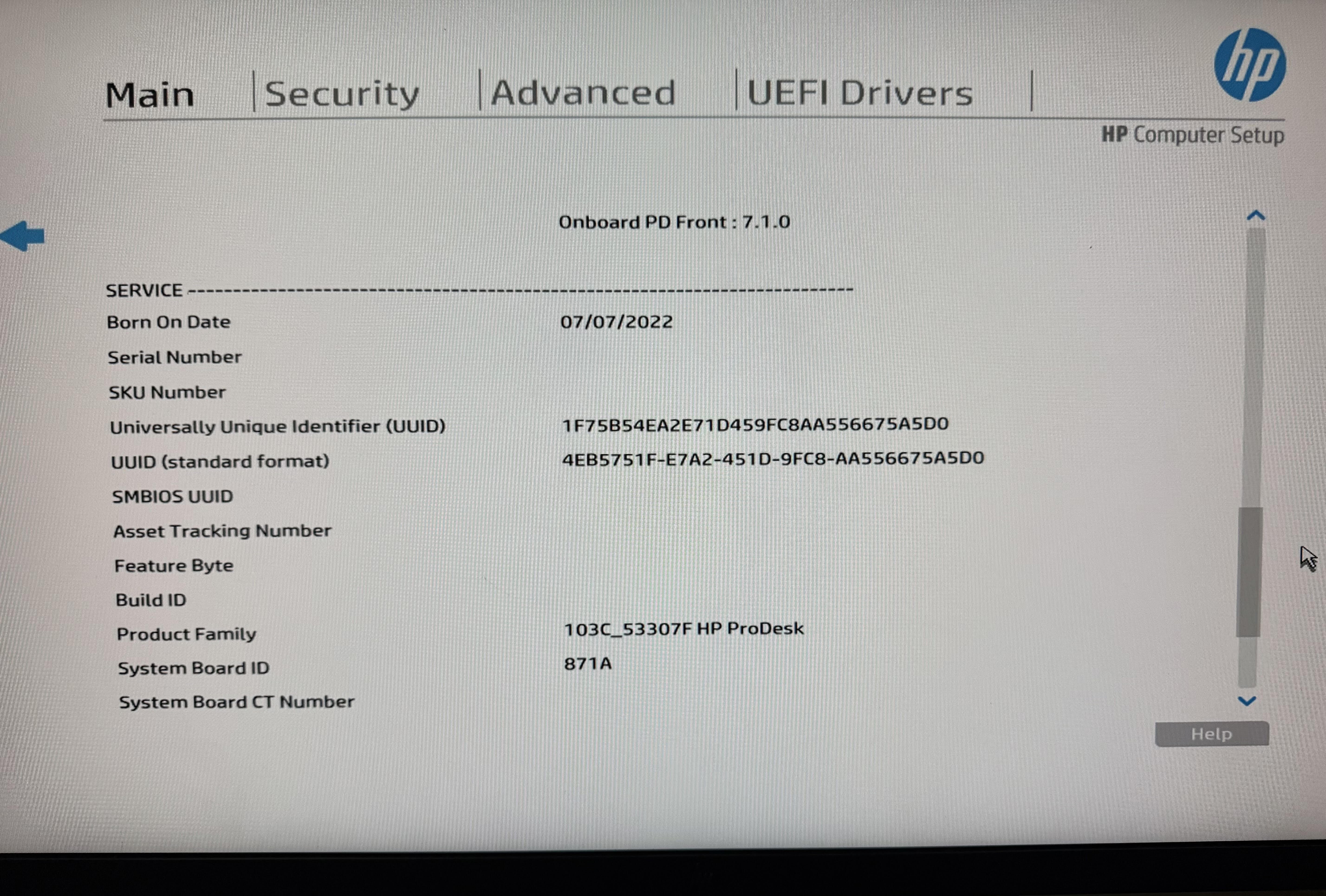

              I have turned the Pc on and just installed Windows.
              In the Bios some info is missing:
              Code:
              HP ProDesk 400 G6 Desktop Mini PC
              Serial_8CC1270DKS
              Sku_47L40EA#ABZ
              Build Id_20WWQ6DT601#SABZ#DABZ
              Fearture byte_3E3X476J6S6b7B7J7M7Q7T7WaBapaqaubhcAdUdpdqfAfPk8mEnV.Dh

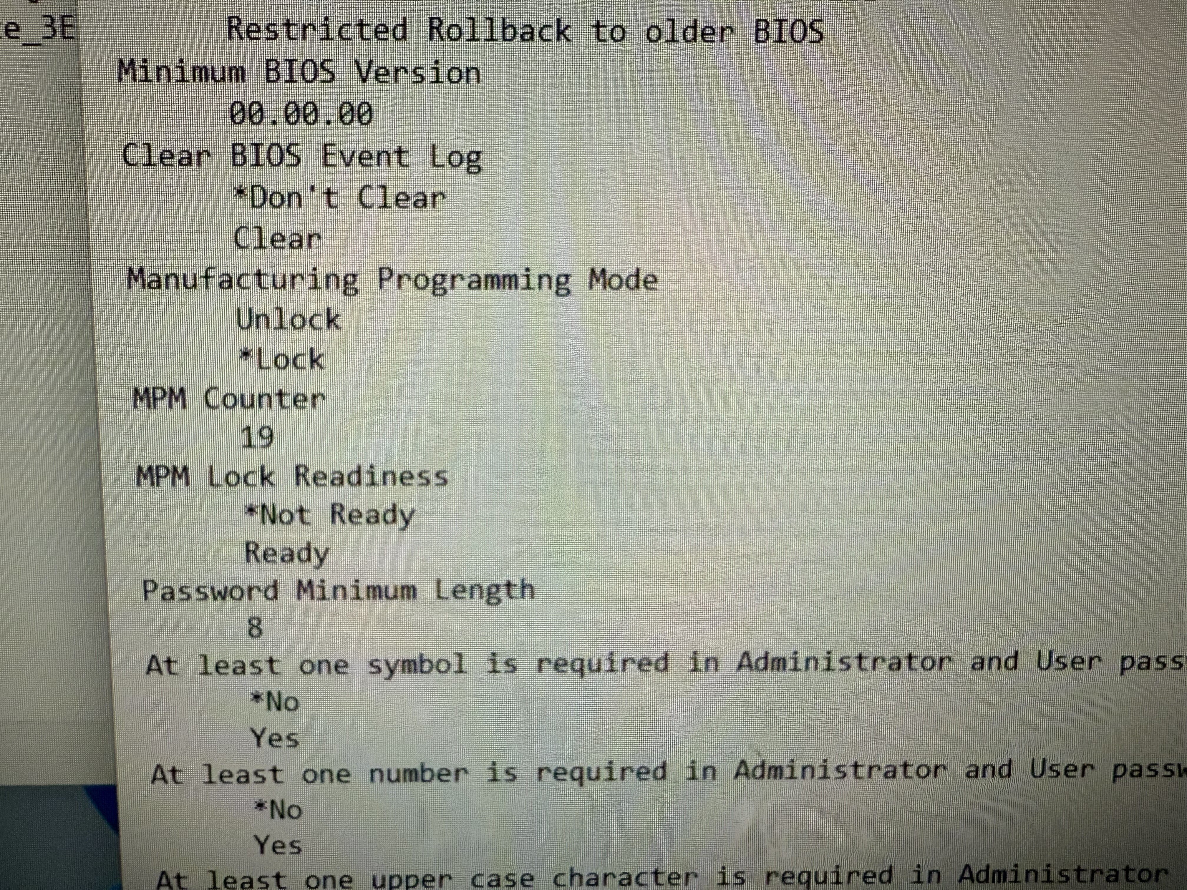

              also there is a red text while booting:
              Code:
              "SYSTEM IS BOOTING IN MANUFACTURING PROGRAM MODE 10"
              I quickly read that with the HP tool I can turn the message off, but can I add the other info with this tool?

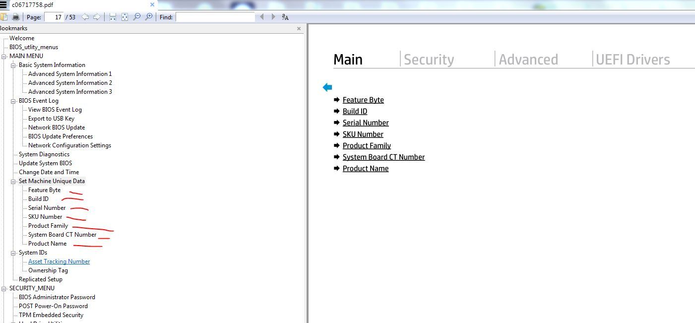

                With some models you can enter the missing info directly in bios settings.
                Interactive BIOS simulator HP ProDesk 400 G6 DM - https://h10032.www1.hp.com/ctg/Manual/c06717758.pdf

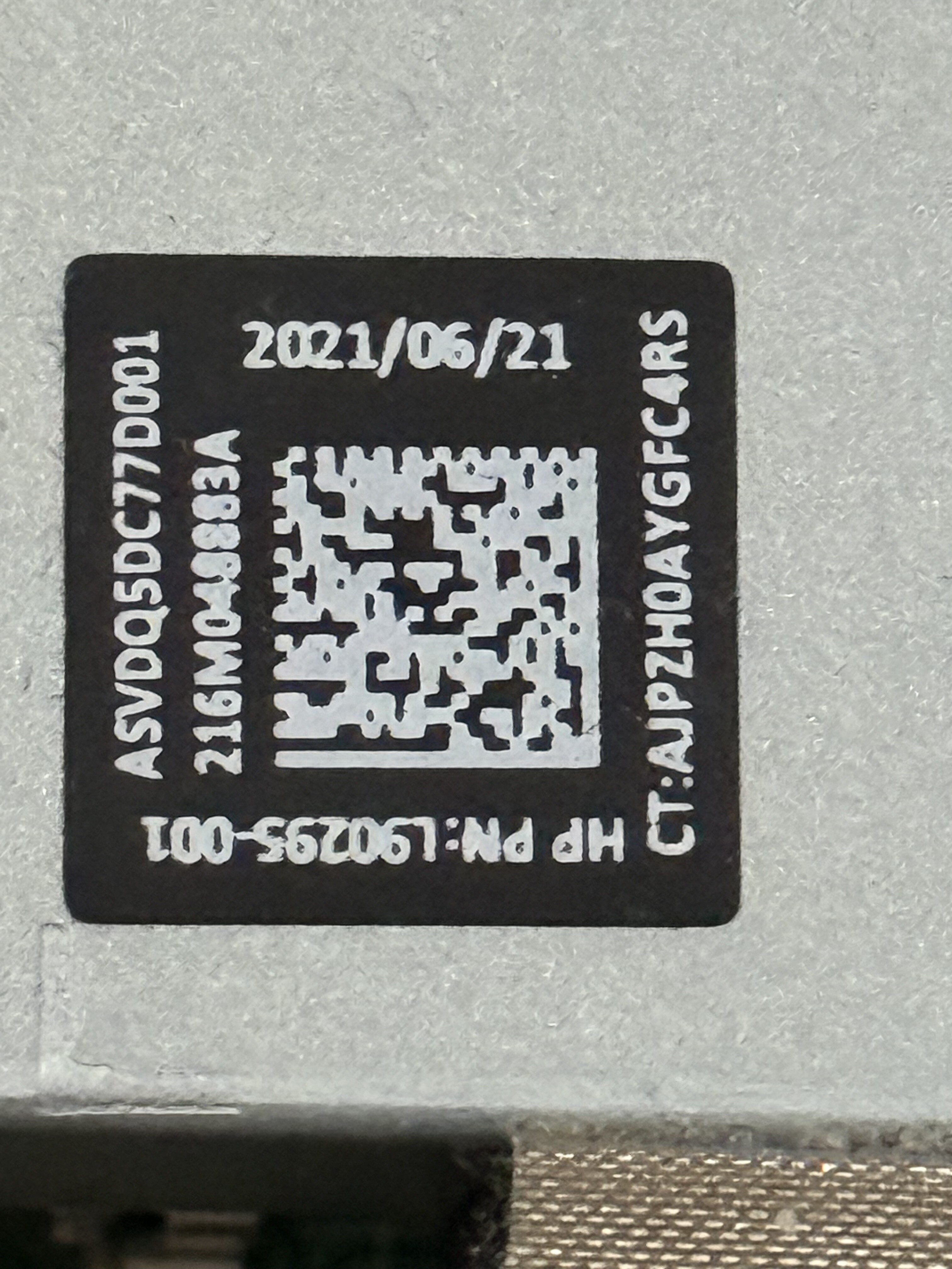

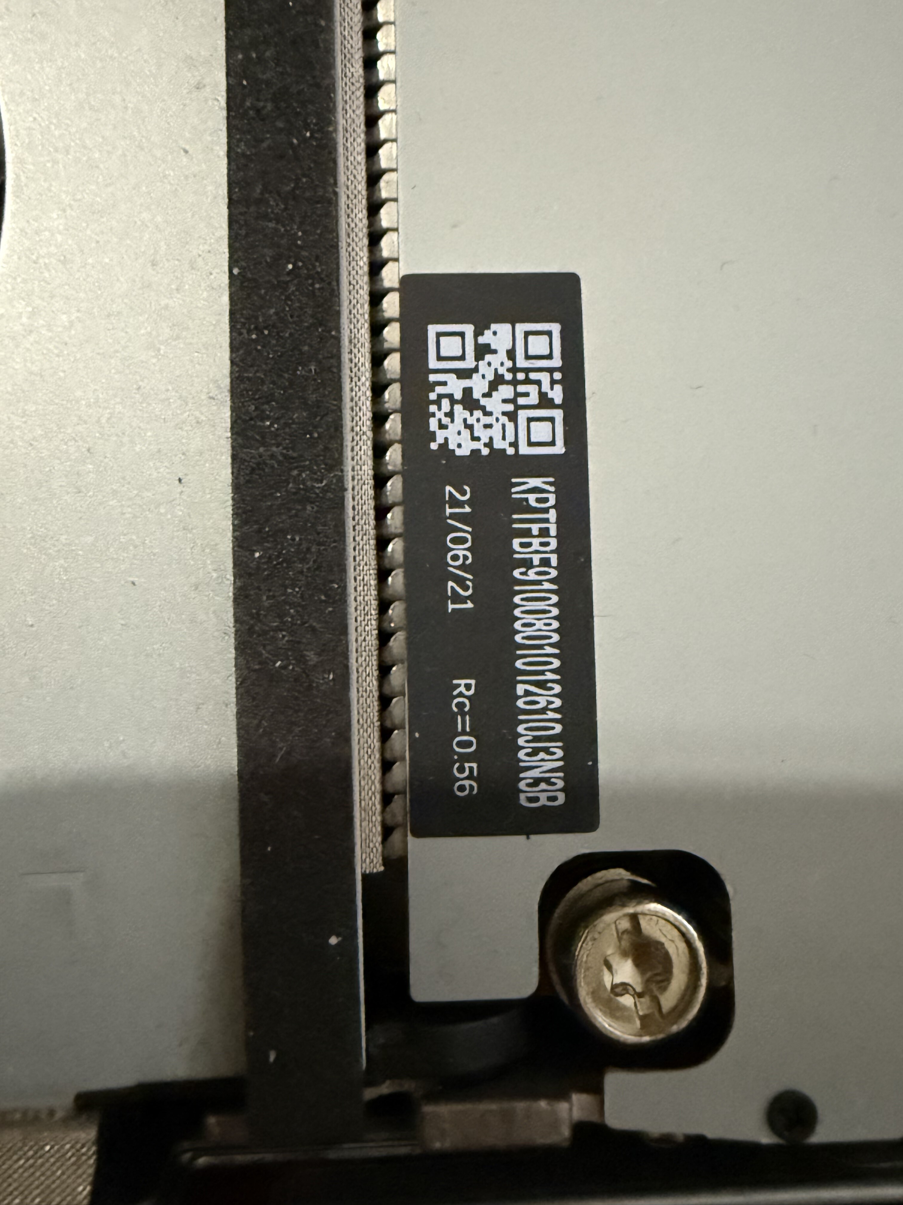

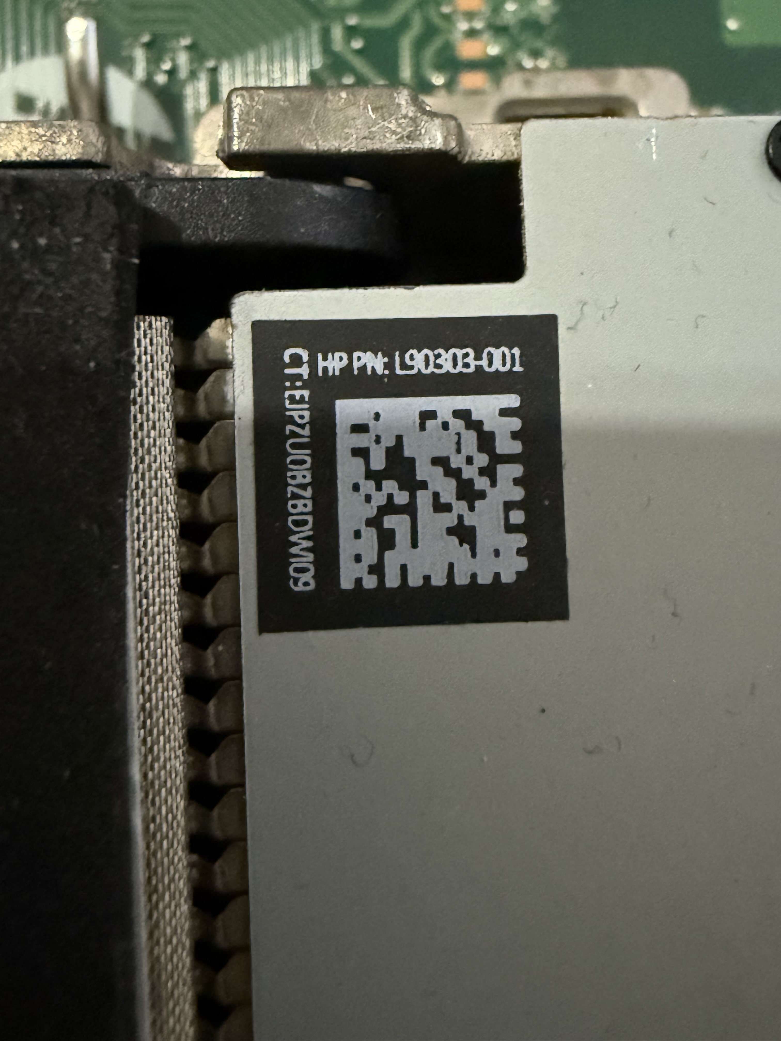

                  I actually entered almost everything into the bios from the info @hoaca388 has provided, but the "system board CT number" not sure which one is it(i have the stickers still) and then the "smbios uuid" cannot find it anywhere? Maybe should be auto generated when i enter everything?
                  If not maybe it's still into the dump file, which i am not sure what number i am looking for. And to stop the message I changed the MPM from unlocked to locked but still get it? I have two more options for MPM maybe have to change them as well?
                  I used the HP tool for the BIOS get and set the data.
                  Will attach the config and the stickers maybe you can tell me which number actually is the CT number because there is more than one CT. Also how to stop the message (the read one that i am in manufacturing mode )
                  Click image for larger version  Name:	IMG_7831.jpg Views:	0 Size:	1.02 MB ID:	3708673 Click image for larger version  Name:	IMG_7832.jpg Views:	0 Size:	1.12 MB ID:	3708674 Click image for larger version  Name:	IMG_7833.jpg Views:	0 Size:	1.30 MB ID:	3708675 Click image for larger version  Name:	IMG_7840.jpg Views:	0 Size:	4.36 MB ID:	3708676 Click image for larger version  Name:	IMG_7841.jpg Views:	0 Size:	5.34 MB ID:	3708677
                  EDIT: Amm after few times editing the confing asked me to confirm the data in the bios(everything I entered) i selected yes and now no problems and autogenerated everything. So not sure if I used the right CT number but don't care anymore. I must say big thanks to everyone and especially @hoaca388 for unlocking my BIOS! I have two more so after 2 weeks probably will post my other BIOS for help But if have time please check my previous post with the questions, they stay still! Thanks again

                    #69
                    Remove password, please:
                    Code:
                    Serial_8CC1270DH6
                    SKU_47L40EA#ABZ
                    Board ID(CT Number ?)_PJLJB0B8JFDEML
                    BID_20WWQ6DT601#SABZ#DABZ
                    Name_HP ProDesk 400 G6 Desktop Mini PC
                    Future bytes_3E3X476J6S6b7B7J7M7Q7T7WaBapaqaubhcAdUdpdqfAfPk8mEnV.Dh
                    I hope I extracted everything correctly and the CT number is Board ID number?
