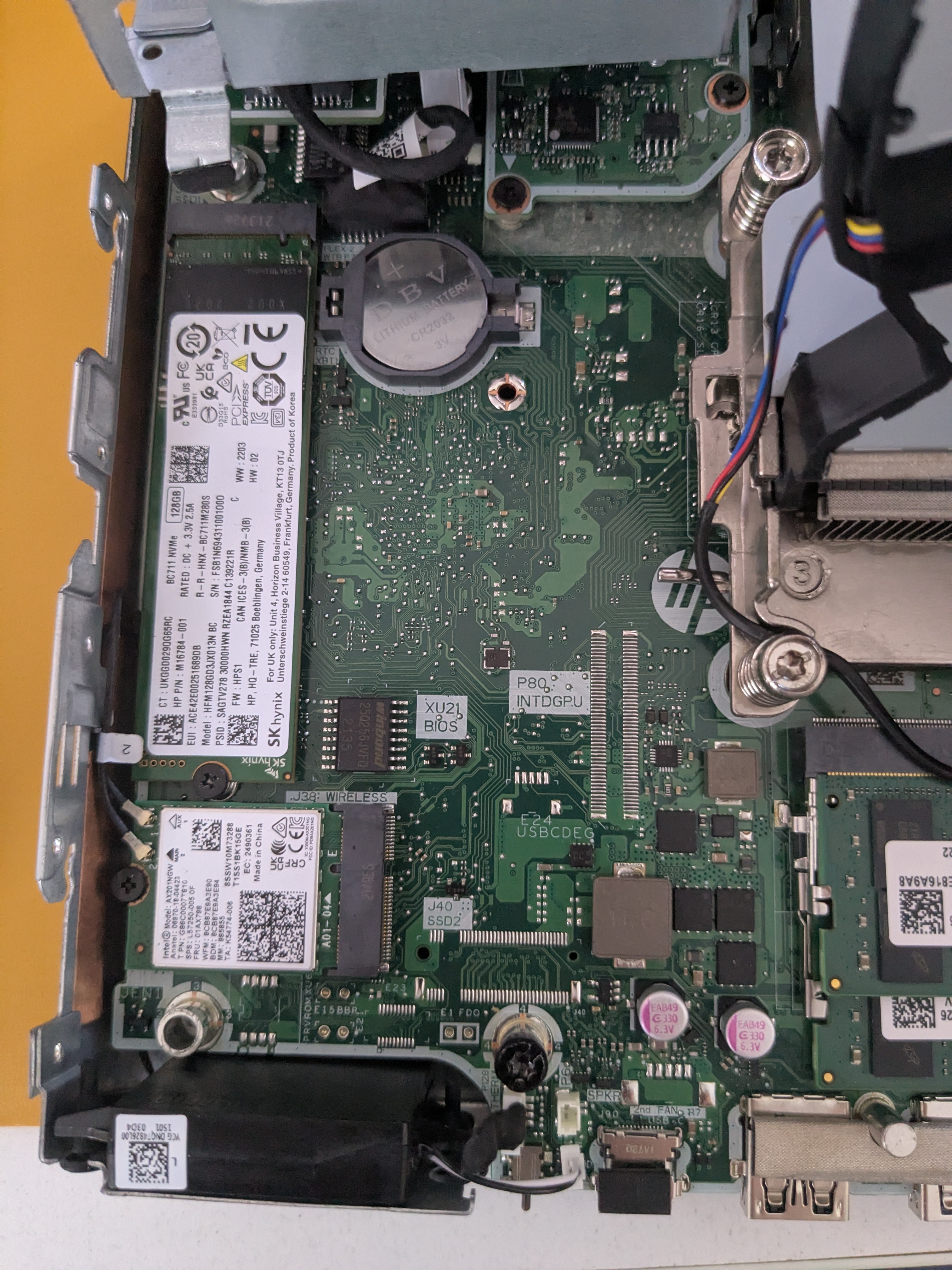

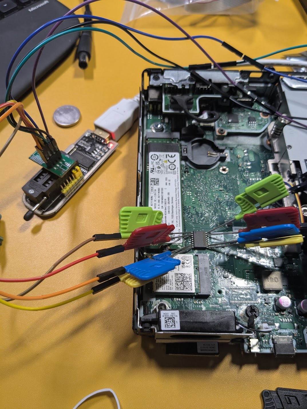

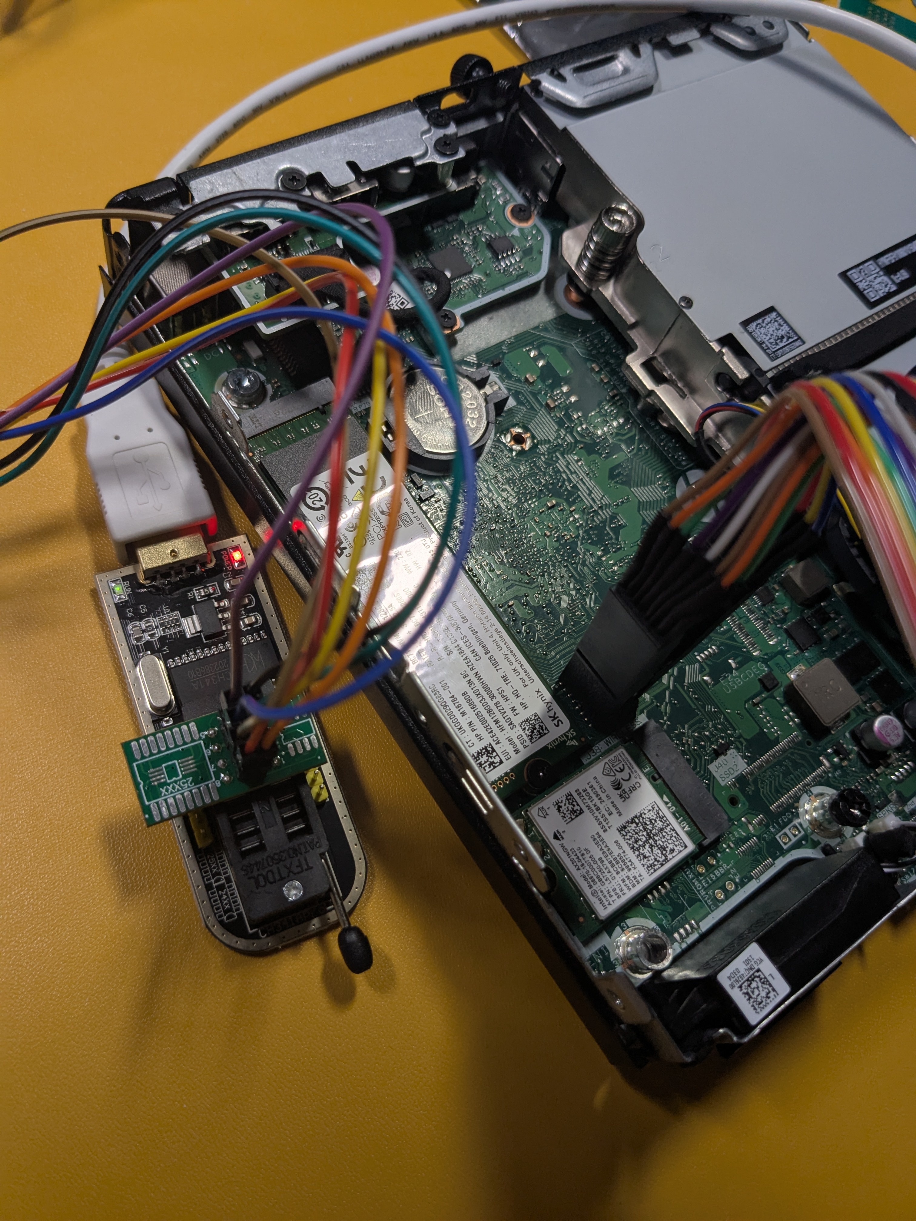

        I am have a similar problem. I have HP ProDesk 400 G6 DM.
        Serial Number: MXL2083TCW
        Product Number: 9AG51AV
        The BIOS is locked and I would like to update it. I've bought a CH431A programmer, a 16pin clip and IC clamps. Using Netprogrammer and AS programmer, I cannot get the chip to read out. I've tried a number of things but including using the IC clamps rather than the clip. I have a number of questions, if anybody has a few moments I could use the help and would greatly appreciate any advice.
        * Should the PC be plugged in when I am reading the BIOS?
        * Netprogrammer doesn't detect the IC and when selecting the chip there is number of variants for W25Q256, mine is W25Q256JVFQ. Is there a significant difference between the sub types? Do I need additional files in the programmer to read out and write back the data?
        * I've looked the data sheet and found a post that matches the pins from 16 to 8. Is the mapping correct?
        BIOS Chip Pin 2 (VCC) -> CH341a Programmer Pin 8 (VCC)
        BIOS Chip Pin 10 (VSS) -> CH341a Programmer Pin 4 (VSS)
        BIOS Chip Pin 7 (CS#) -> CH341a Programmer Pin 1 (CS)
        BIOS Chip Pin 8 (SO / IO1) -> CH341a Programmer Pin 2 (MISO)
        BIOS Chip Pin 15 (SI / IO0) -> CH341a Programmer Pin 5 (MOSI)
        BIOS Chip Pin 16 (SCLK) -> CH341a Programmer Pin 6 (SCK)
        BIOS Chip Pin 9 (IO2) -> CH341a Programmer Pin 3 (WP)
        BIOS Chip Pin 1 (IO3) -> CH341a Programmer Pin 7 (HOLD)
        * I don't have another computer with a compatible BIOS chip (thinking about buying a chip to debug the programmer). Is there anything I am missing to debug the CH431A?
        Thank you in advance for any assistance.​
          * Should the PC be plugged in when I am reading the BIOS ?
          No , all power sources must be isolated from the motherboard.
          * Netprogrammer doesn't detect the IC and when selecting the chip there is number of variants for W25Q256, mine is W25Q256JVFQ. Is there a significant difference between the sub types? Do I need additional files in the programmer to read out and write back the data ?
          ​Since I don't use CH341A, I'm not sure but CH341A is the cheapest but not the best.

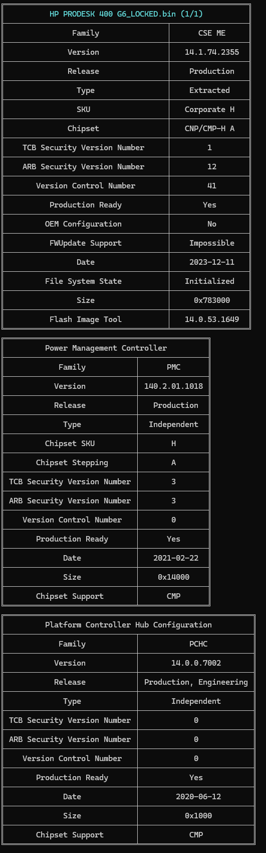

            I managed to download the BIOS. Can somebody help me remove the admin password? Many thanks in advance!
            • hoaca388
              Badcaps
              • Jan 2022
              • 11279
              • Viet Nam
              HP ProDesk 400 G6 Desktop Mini PC
              Serial _MXL2083TCW
              Product_9AG51AV
              Build Id_20WWQ6ET601#SABA#DABA
              Fearture byte_3E3X475K6J6b7B7J7M7Q7T7W9AaBapaqaubhcAdUdpdqfAfPk8mEnV.qQ

                Thank you for the response! I really appreciate it! Sadly, I've tried flashing that bin to the computer and it refused to boot. Afterwards, I flashed back the old bin and it started up with the password as before. In addition, I've also tried following some tutorials and downloaded a clean CSME 14.1, placed it into the region and regenerated the image. The resulting image also didn't remove the BIOS password. If at all possible, could you take another look?
                • hoaca388
                  Badcaps
                  • Jan 2022
                  • 11279
                  • Viet Nam
                  Clear ME FILE

                      Thank you for generating another BIOS. I flashed the BIOS with it and just like the previous one, the computer doesn't POST with that bin.
                      • hoaca388
                        Badcaps
                        • Jan 2022
                        • 11279
                        • Viet Nam
                        #31
                        Flash again with the original file (lock file) to see if it can be posted ? If it can't be posted, you have accidentally damaged the hardware
                        • Ben Sun
                          • Feb 2025
                          • 6
                          #32
                          Thank you so much for continuing to assist me.
                          Tl;dr: The very first bin file you sent worked!
                          I flashed back to the original saved bin and it didn't work until I realized the write wasn't working. I erased the IC and was able to flash to original bin onto it and it worked. After doing that I erased the IC again and put the very first bin you sent in response and it worked like a charm. Apologies for not investigating this more before asking for help.
