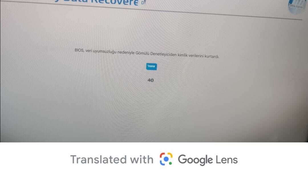

                              Hello, I copied the bios from another healthy device and made it clear, it displays the image once, it gives the error in the picture, it shuts down and does not display the image again, please help.
                              Premium supporters get full download access and other benefits.
                              • hoaca388
                                Badcaps
                                • Jan 2022
                                • 12713
                                Again

                                • bilal046
                                  bilal046
                                  • Aug 2017
                                  • 26
                                  • Türkiye
                                  • Notebook tamiri
                                  Originally posted by hoaca388
                                  Again
                                  thank you for writing
                                  3 red 2 white LEDs gave error​
