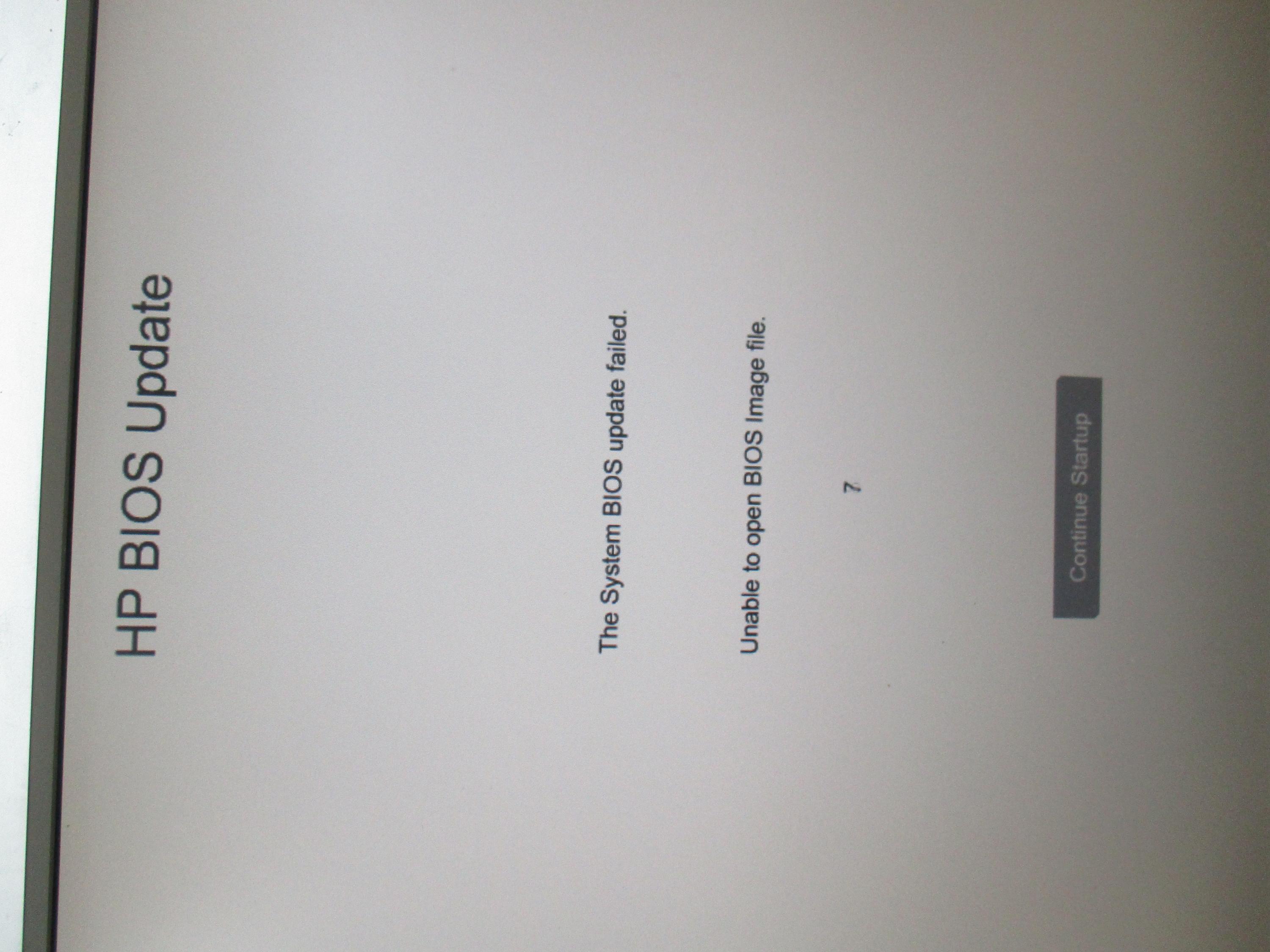

    got a system, crashed meanwhile BIOS Update.
    Attached, the broken BIN and the EXE from HP Site, which should contain the new BIOS, but I'm unable to extract it for some reason.
    Would be could if someone can fix that for me. Thanks a lot!

          Re: HP ERICA5 87D7 Mainboard BIOS bricked
          Originally posted by hoaca388
          HP Pavilion Gaming Desktop PC TG01-1000a (2W847AV)
          Same as before. Without SSD, it does not even POST.
          With SSD connected, it shows the following in a loop:

              Hello. Found a solution to the problem? I have exactly the same problem. Without SSD there is no post. BIOS update error with SSD.

                  just need to plug USB key with BIOS updating files
