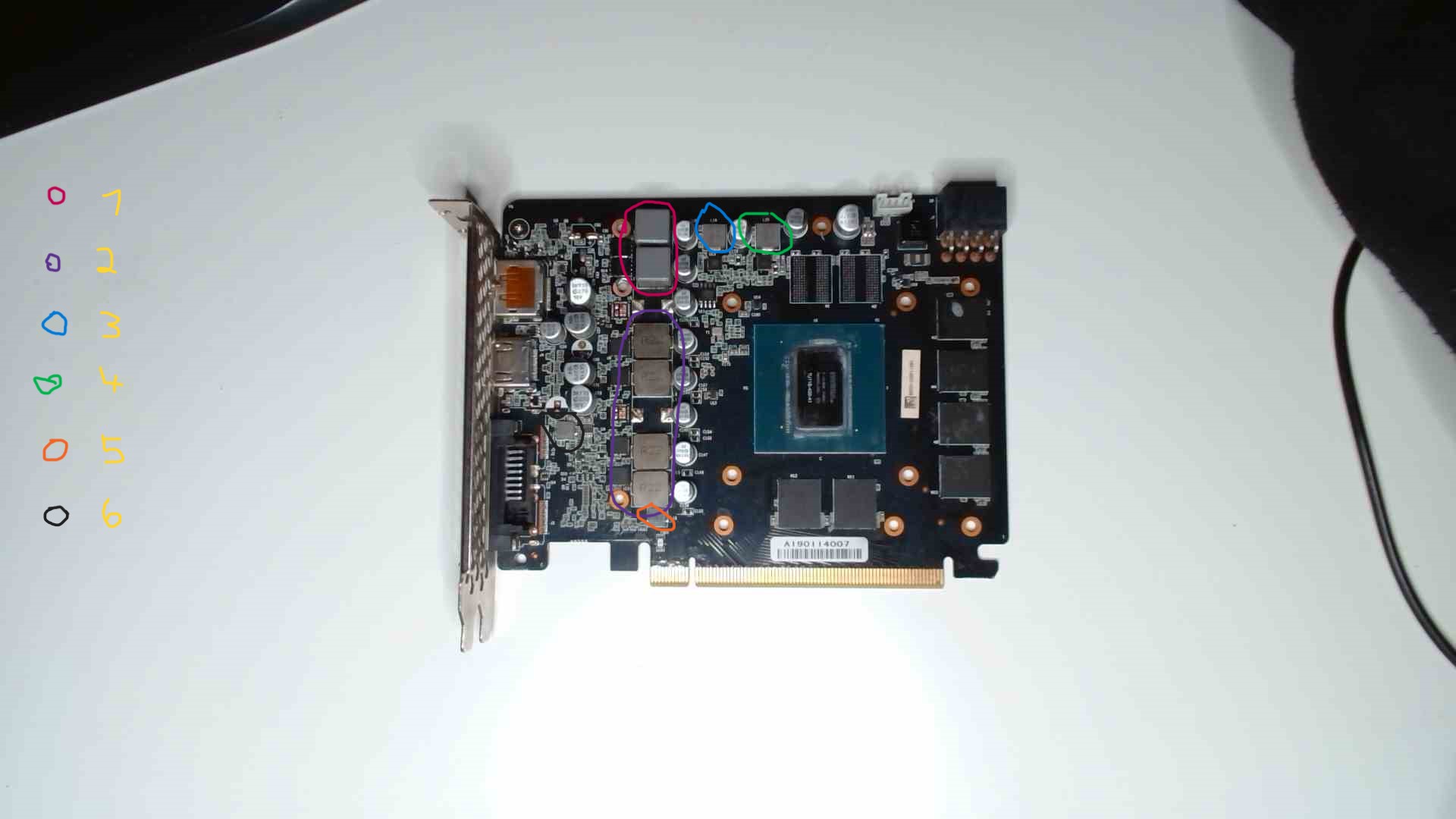

    hello friends,
    I need your help!
    1: Vmem = 5.45 ohms - 1.5V I find 5.45ohms too low but the card works
    2: Vcore = 0.25ohms - 0.785V
    3: Pex? = 22.47 ohms - 0.95V
    4: 1.04KOhm - 1.75V
    5: 12V PCIE = 0.80KOhm - 12V
    6: 5V 0.9KOhm = 5V
    The card runs perfectly in desktop mode.
    In the benchmark, it goes out immediately.
    mats/mods gives me a pass.
    mats gives me a pass at ( ./mats -e 20 ).
    When I want to run ( "mods gputest.js -test 178 -test 118 -dramclk_percent 100 -fan_speed 100 -matsinfo -oqa -run_on_error -ignore_fatal_errors" ) the card goes straight off.
    Do you have an idea?

    Re: GTX 1660ti 6GB Gainward
    bad vram

      hello, sorry if I understand bad English is not my native language, but did you mean that the card loses video? if so, can you verify that there is no absence of any of the voltages when it happens?
