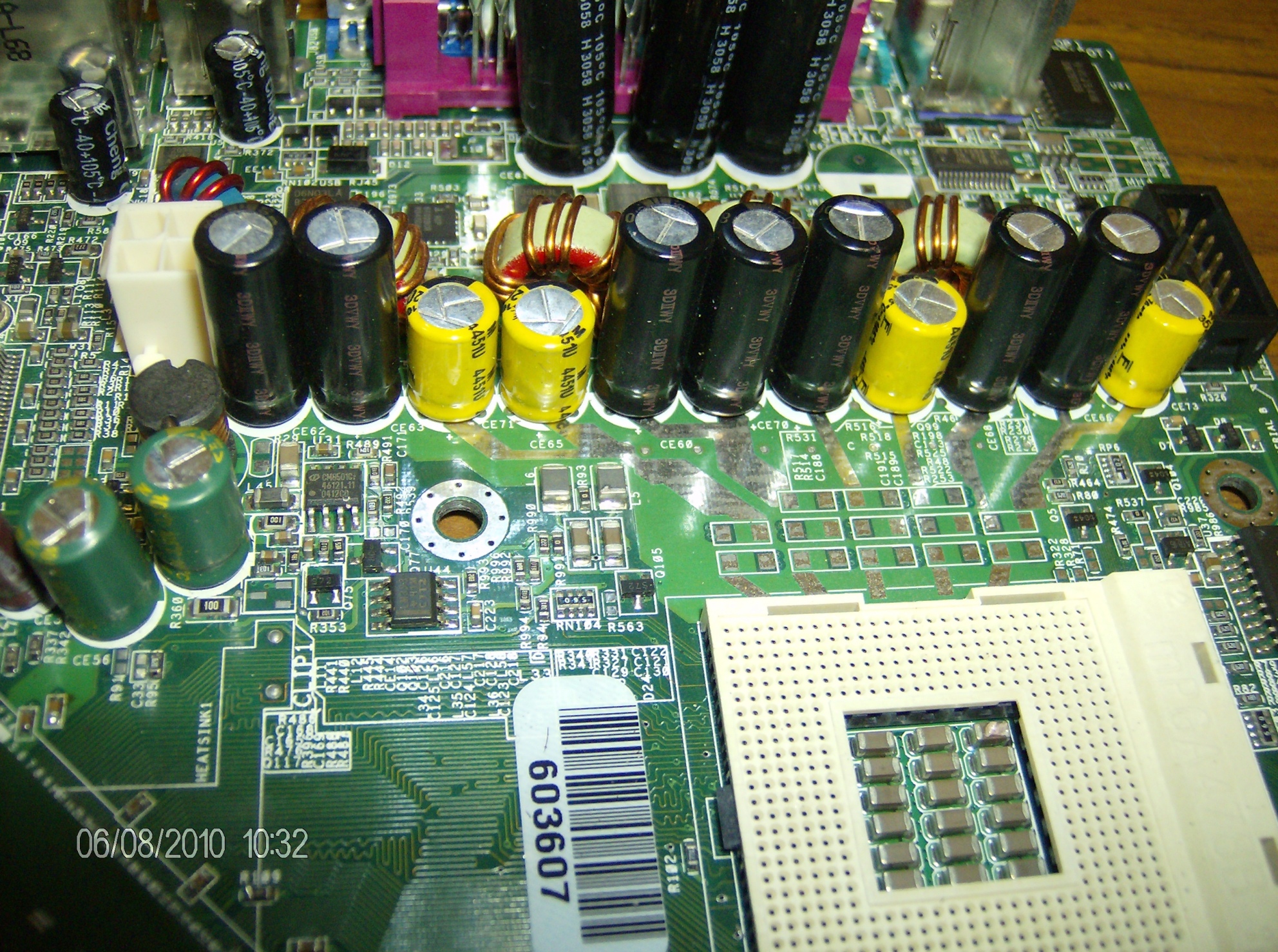

    Hello all.

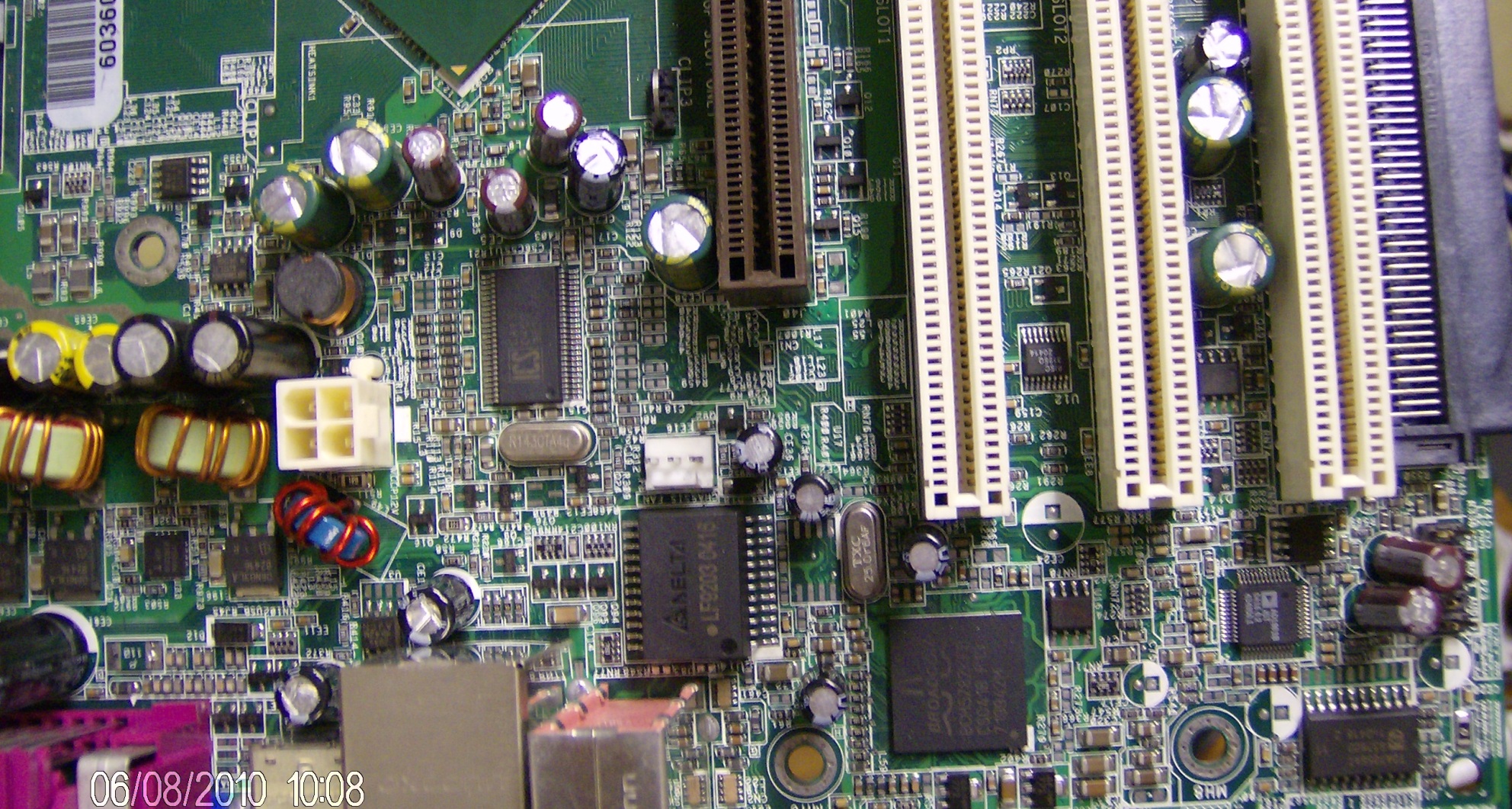

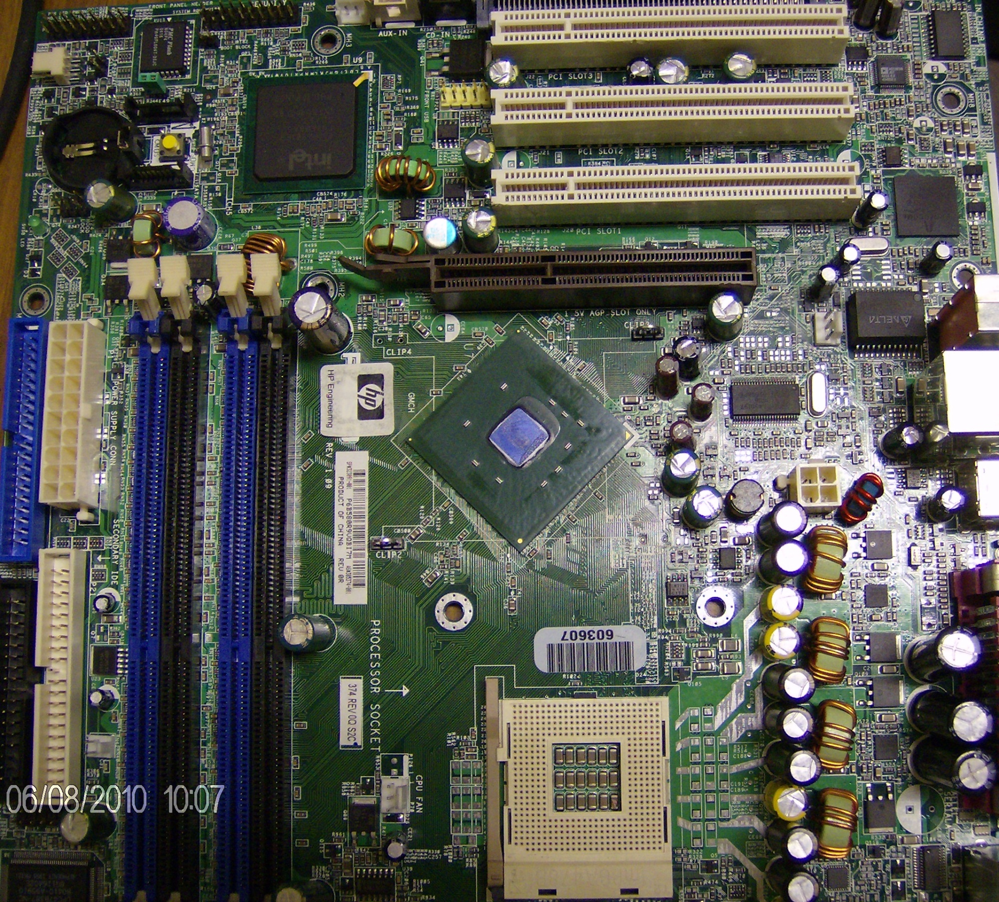

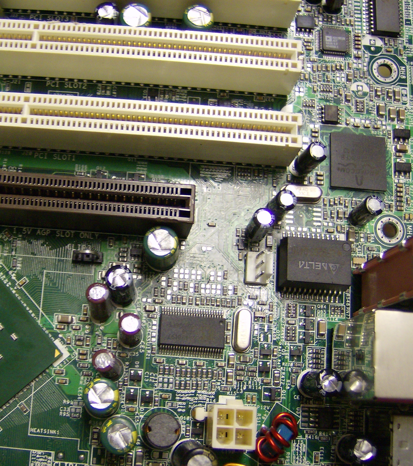

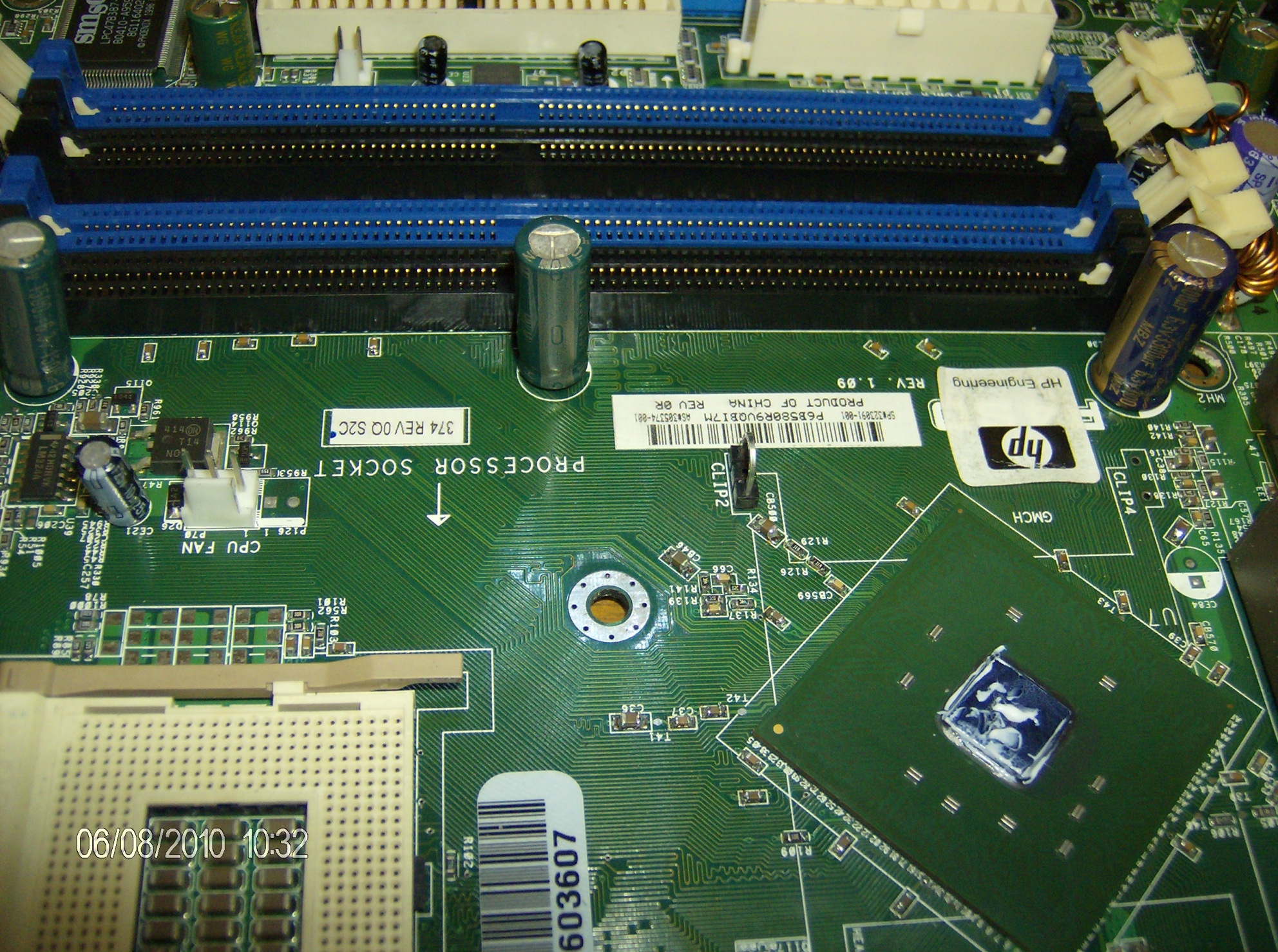

    I recieved this board monday and i cant figure out what is wrong with it.
    even before recapping, the caps it had looked good (IM noob O) but still since i finally got some caps (crappy but still caps, and thats all i could manage to get around here) i decided to try out.
    the board keeps shutting down abruptly, sometimes it takes longer, sometimes it wont go after the first bootup screen....
    i found a pattern: it last longer (or sometimes not even fail) if i physically leave it in its laying down position and not on its standing positiong. Does that make any sense? I cant find nothing wrong with the board, I recapped it and still doing the same, one of those days i left it running mprime laying down and it was working morning after, another day i tried it with mtest and the same... but if i leave it on its standing position i dont even have to wait much when it shuts down, the longest it takes to shut down is about half hour... at once this morning it sent me the PSU error, i changed PSU and it was really weird (i dont know if it was a misconnection but i didnt see any) the board would just not advance to its next booting screen or if did itd get stuck right there (not shutting down, but gettting froze, not responding to caps/num lock) then i put back the original PSU and began working again (WTF?)
    then the last times i tried on mprime i realized mprime would say someething like:
    "hub 1-0:1.0: overcurrent change on port 7econds" <- (is not a typo, thats how it was shoing up)....
    does any1 have an idea what could this mean? the board had one usb stick memory on one front connector (the one i was booting with) and a usb mouse in the back, ps2 keyb and vga monitor.

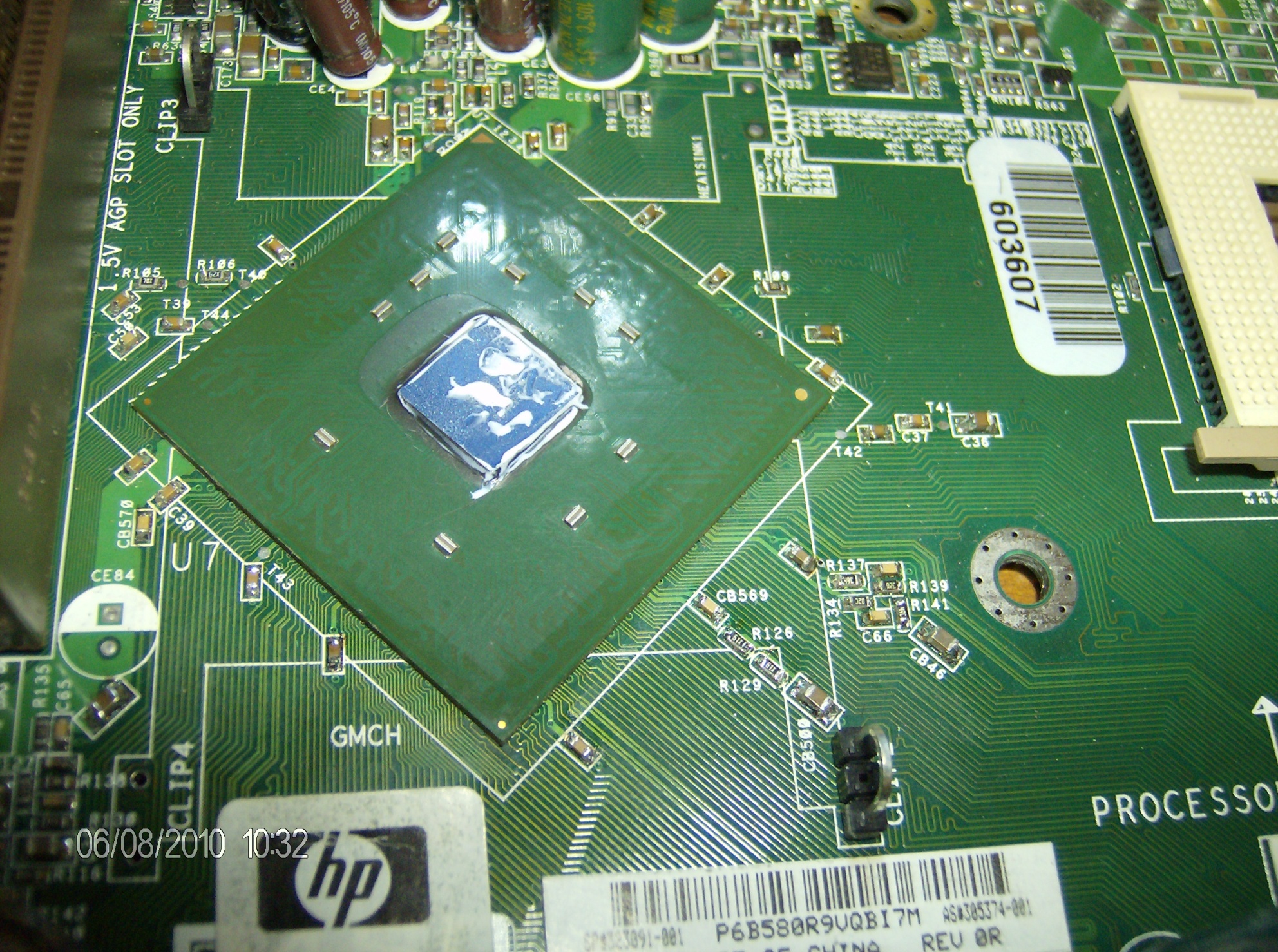

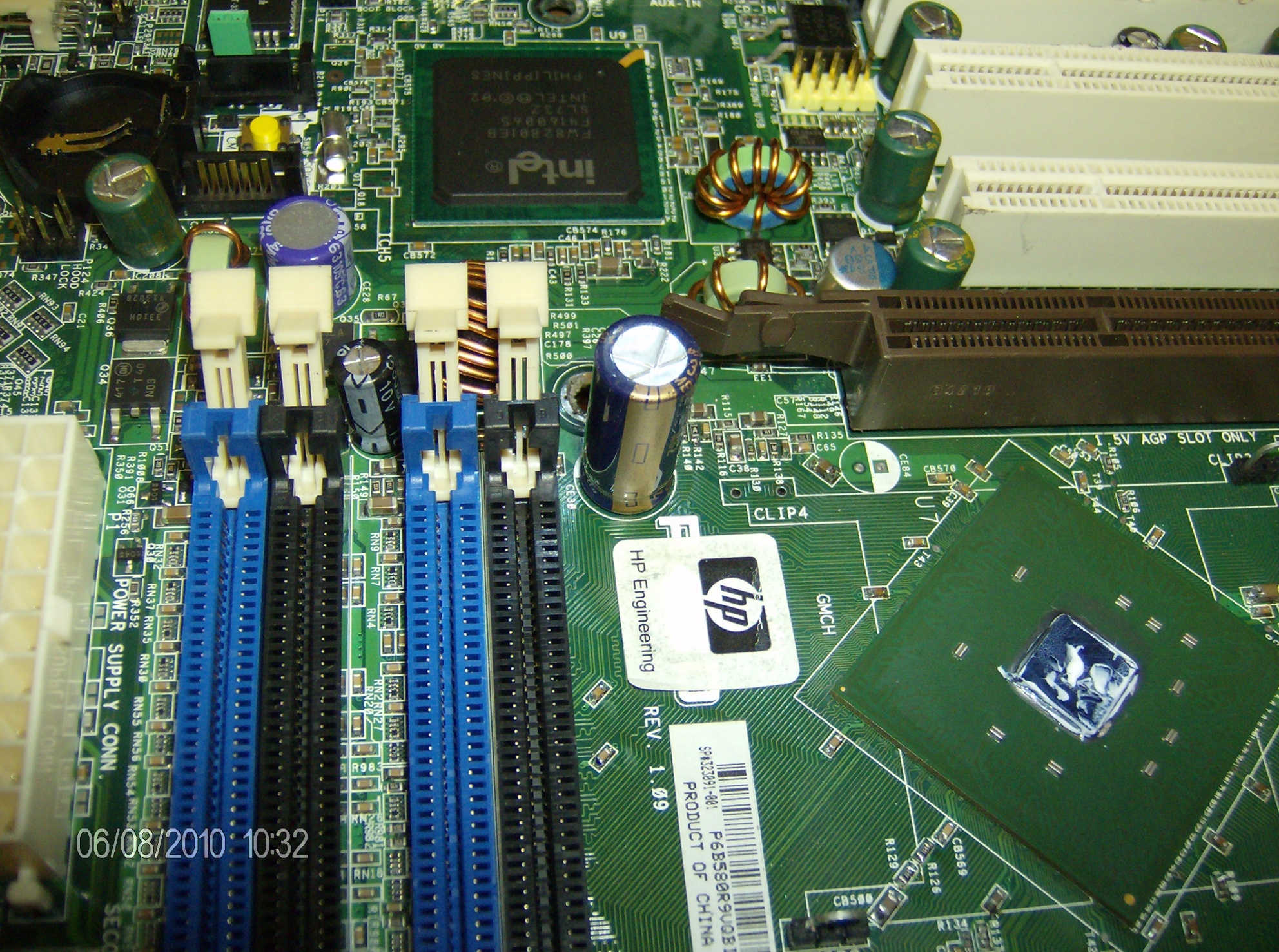

    these pics are how the board currently looks like. i havent manually resolder the whole board, also have not applied hot air to it. do you advise any?
    i have changed: CPU, cooler+fan, GMCH cooler, DIMMs, PSU and almost fully recapped. (even the rubycon besides the memory bank is recapped, i pulled it from a dead board.) the only caps i havent touched are those in the CPU area (1800/6.3) and the few polys the boards got. the only area i resolder was the area arund the GMCH.
    Any tip, advice, info, aything is highly appreciated.
    Thanks.
    peace.

    Re: P4SD - case I7M
    USB overcurrent warning, possible southbridge failure. Try reflowing the board (hot air or oven, whatever method you prefer) and see what happens.

      Re: P4SD - case I7M
      ^ thanks, i will and update after cooling n testing.
      thanks again.

        Re: P4SD - case I7M
        UPDATE: The board boots but it shuts down on no particular pattern running mprime, no more error messages, actually it lasted good yesteday but today it failed again. Do you advise manual resoldering or reheating harder?

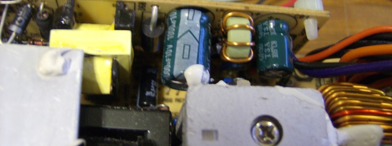

            I have to admit once i got much more suspicious of a PSU causing this failures since the board wasnt that hot while the PSU was steaming hot, and since this PSU model has a lot of known issues, i really thought it was it, but then again i switched PSUs and same thing happened.

                  Amps rating on the 12v rail and caps inside the power supply (check if they are bulged and see what brand and series they are).

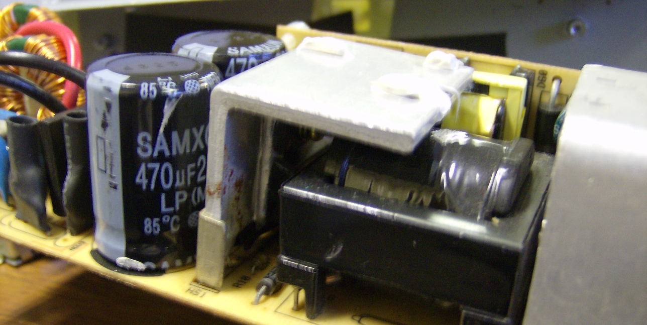

                  I noticed (the one that failed) it was hot as hell, not only the MOSFET area but the whole unit was steaming hot.... this particular model has a known issues with the glue becoming conductive and making the MOSFET go Boom! as wel as the PWM IC, and wel whatever crosses i guess...
                  Clean the glue off. This won't help your motherboards crash any less but at least your PSU won't go *bang* once the glue becomes conductive (by the way, the glue becomes more conductive with heat so you definitely don't want to overheat the PSU now).

                    It was the PSU causing this particular board to shut off, and yes i did have two broken PSUs.... but thanks to you and the info you gave I managed to figure out the problem.

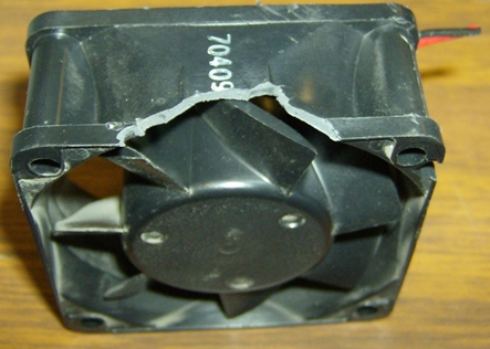

                    Seems like theres a new known issue for these damn PSUs -new to me, at least -... looks like the plastic frame of its only and shitty fan gives up, bends a little, causing the fan to stop (or not funtion at all), and this leading to overheating/shutting off.

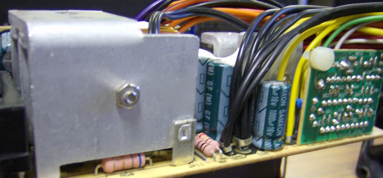

                    I just chopped off the platic on the way of the fan and mounted it all back again, I also cleaned the PSU cause of cause it was as dirty as possible, checked on the caps as you mentioned, none of them are good brand but i didnt recap due to the rush fact.
                    https://www.badcaps.net/forum/attach...1&d=1282064540
                    And yes, this was the same issue on the other PSU i was using to testing... looks like when you set up this PCs on its standing by-the-side position isnt that good for the PSU under certain -not so nice- working conditions.... but hey... is either that or nothing!. The processor being used is normally P4, Prescott:

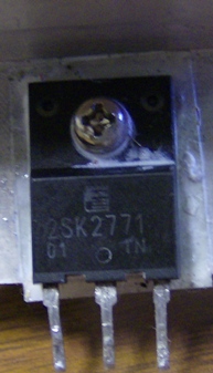

                    The MOSFET i use as replacement is 2SK2771

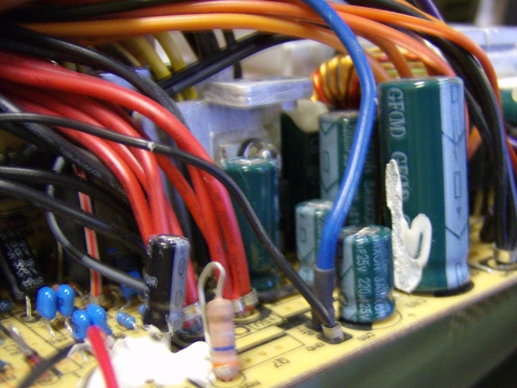

                      Samxon is a good brand of caps
                      This site sells them
                      The Samxon GF does have a little tarnished record tho, but it seems to be related to high heat scenarios, like LCD's etc with poor airflow...
                      In a PSU with a working fan I'd assume they would be just fine...
                        Re: P4SD - case I7M
                        ^ Thanks, i cant edit that message but I acknowledge your comment.
                        And the big samxon were put by me when i didnt know what to do i thought they had something to do with the whole overheating scenerio, but thanks again.
