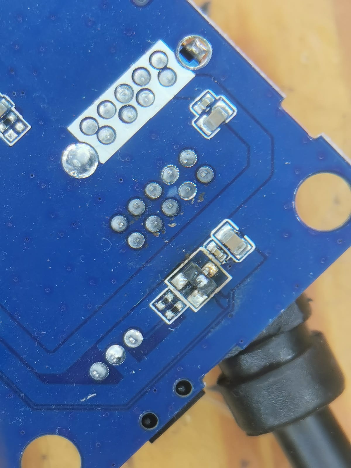

    Hi all!

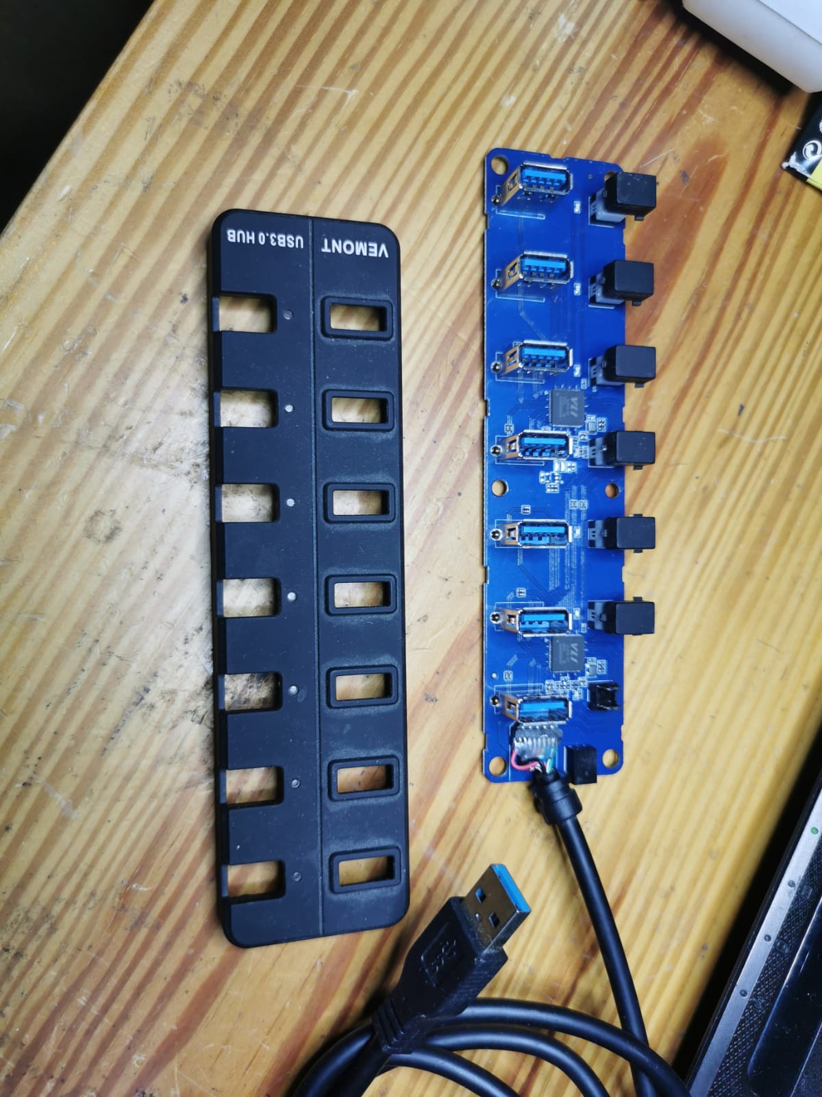

    Yesterday my usb hub started smoking after I pluged in a pad controller.... It has performed great for a couple of years.
    There is a burnt smd transistor, but the code is unreadable. It's a Sot-23 package. I read somewhere that smd transistors starting with "A" are MOSFET.
    Don't know if P or N.
    5v from usb goes straight to the single pin side, which might be Drain...
    Only data i have is package, usb operation voltage.
    No max current draw on the label.... it has 7 usb ports.
    Don't know about transistor specs. Any advise on a possible substitute?
    Thanks.

    A79T (AO3407) - P Ch.
    A19T (AO3401) - P Ch.

        Hi Iotas. So I replaced the transistor and everything working again.
        Thanks a lot for your help!
