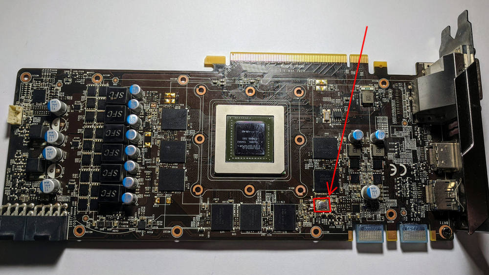

    hello and thank you for checking this post, my friend had this graphics card was working just fine till a thunderstorm hit, got some mosfets blown up as shown in the pictures below.
    still trying to get the right name of these components so i can order them and try to replace them on hopes that it can be fixed (hopefully the GPU is still intact)
    if anyone here has the schematics for this exact card please feel free to send me the file or if you ever had a similar issue i would love it if you can provide some feedback (i am not a professional repairman, just trying to my best to salvage this one)
    is there some other points that needs to be checked? or simply replacing the blown up ICs would solve the issue?
    thank you for your time

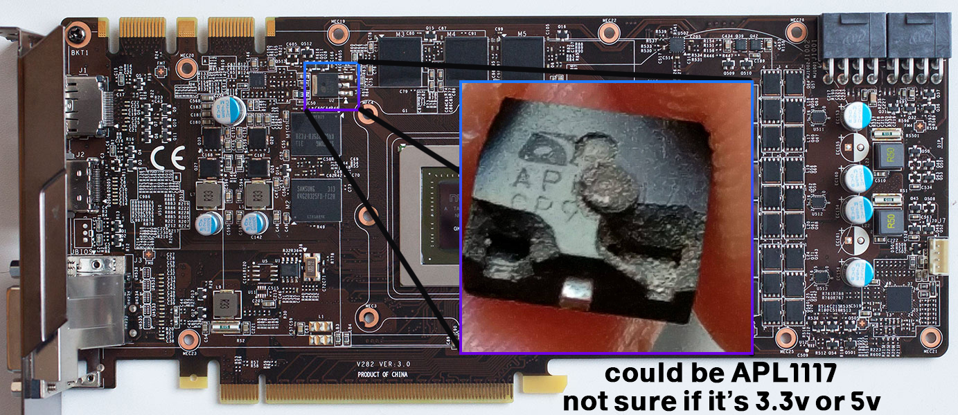

    Post a better picture of the front.

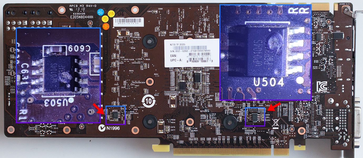

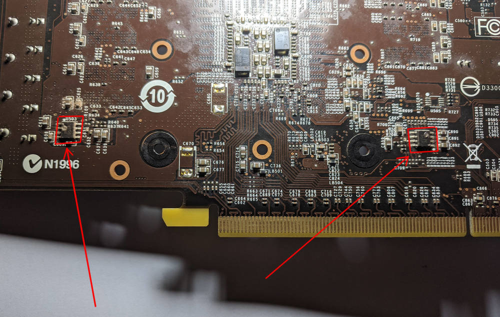

    Rear: almost certain that one is BIOS (my bet is the one on the right), the other one is responsible for 1.8V

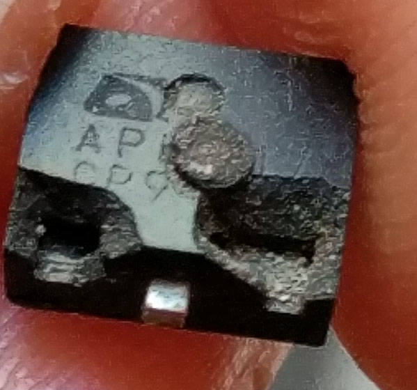

      sadly the one from the front fell apart while removing it, here is a close up
      the one in the front just broke apart as shown in the pictures, hope these can be helpful.

          5V LDO 95% sure since 3.3V comes from PCIE slot.
          So I was wrong about BIOS chip. The other chips are LDOs as well.
          Since all your power IC's are destroyed from power surge, chances are quite high the GPU is fried.

                      You should use the exact replacements, unless you know that there is a 100% pin for pin fully compatible part
                      Before ordering any parts you can check if there`s a short after desoldering each IC. If the 1.8V rail is short the GPU is most likely dead

                          for anyone interested in this topic, the IC on the front is the APL1117 CP94F
                          the ones in the back can differ from one revision to the other, the ones on this card are uP0104s PGP38AF. other MSI cards can have uP0104s PGP38G as well.
