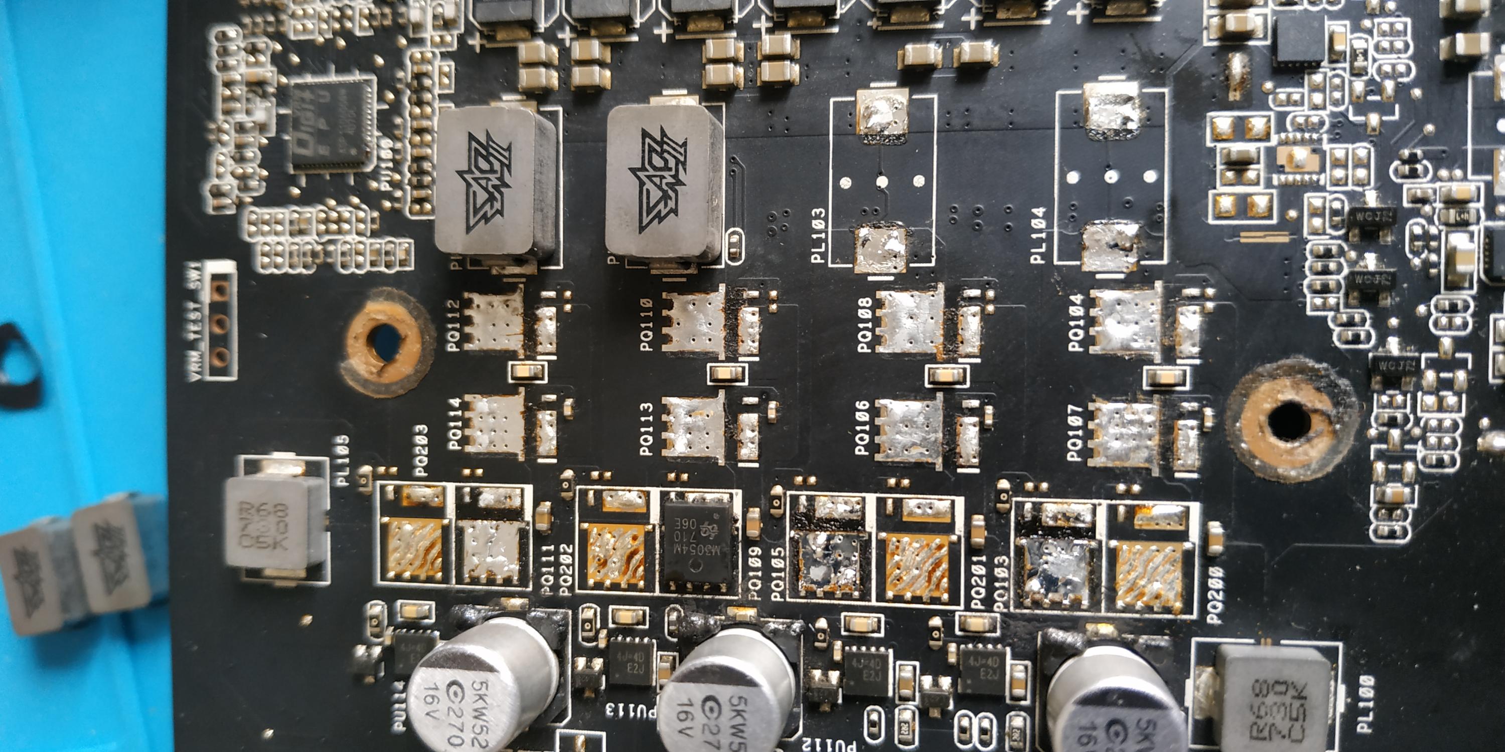

    Hello friends,
    I have RX 470 4G mining card which is not working. After removing the mosfets there is still short between drain and source pads of the PCB.
    I think that the problem could be a bad cap, but without schematic it is not easy, I just dont know where to start from. I am uploading a photo of the PCB with removed mosfets. Any idea will be helpfull!! Thanks for the support !!

    So we are talking about the low side MOSFETs. This means you have a short between your load (the GPU) and ground.
    You could try isolating the VRMs by removing the chokes. Not easy to desolder tho.
    Another option is voltage injection and check for heat. But since we are on the GPU side, make sure to keep voltage low enough. I find this technique quite hard because there is not that much heat generated with low voltage. And heat dissipation in the pcb makes it quite hard to detect the actual heatspot.

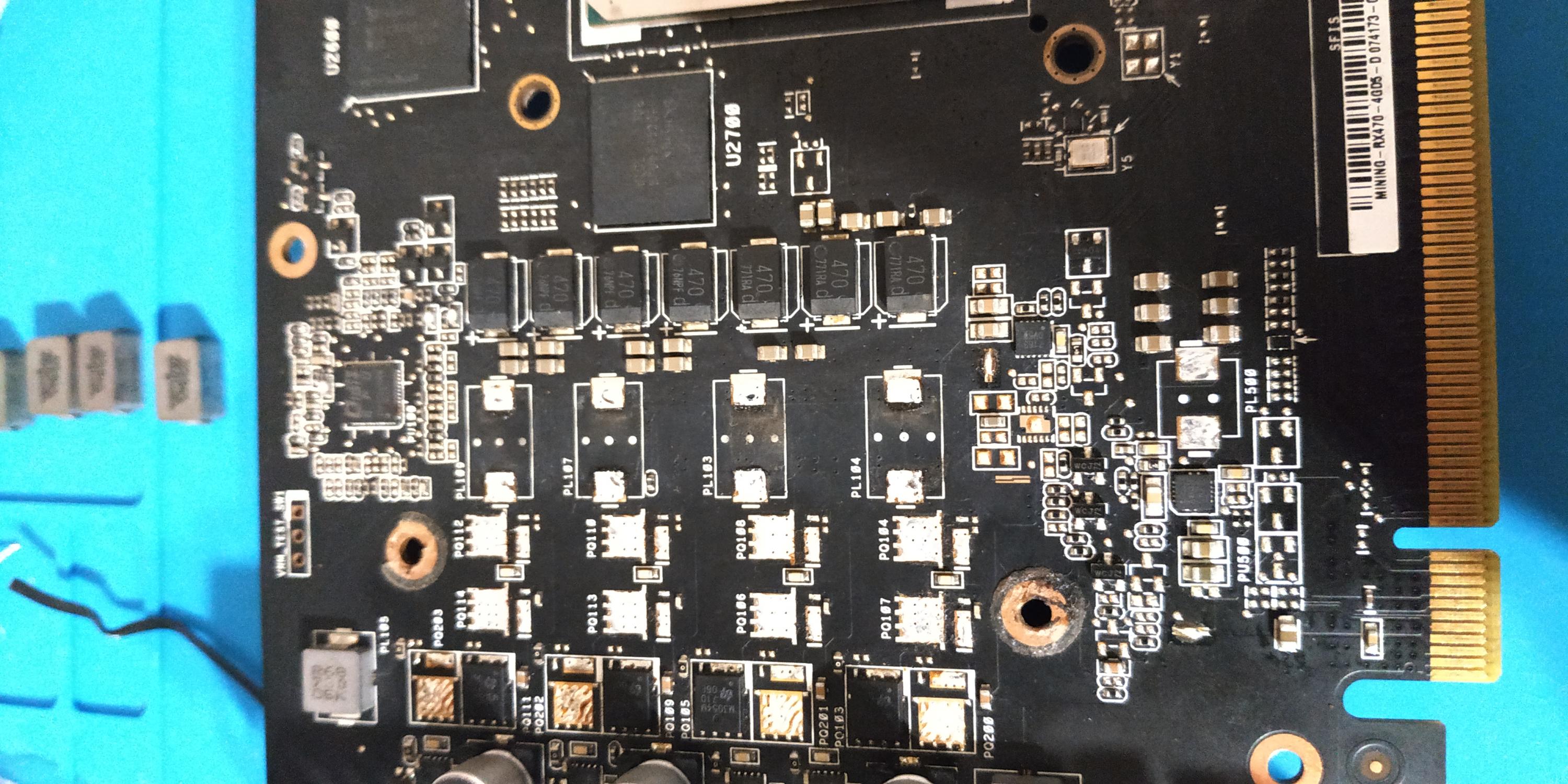

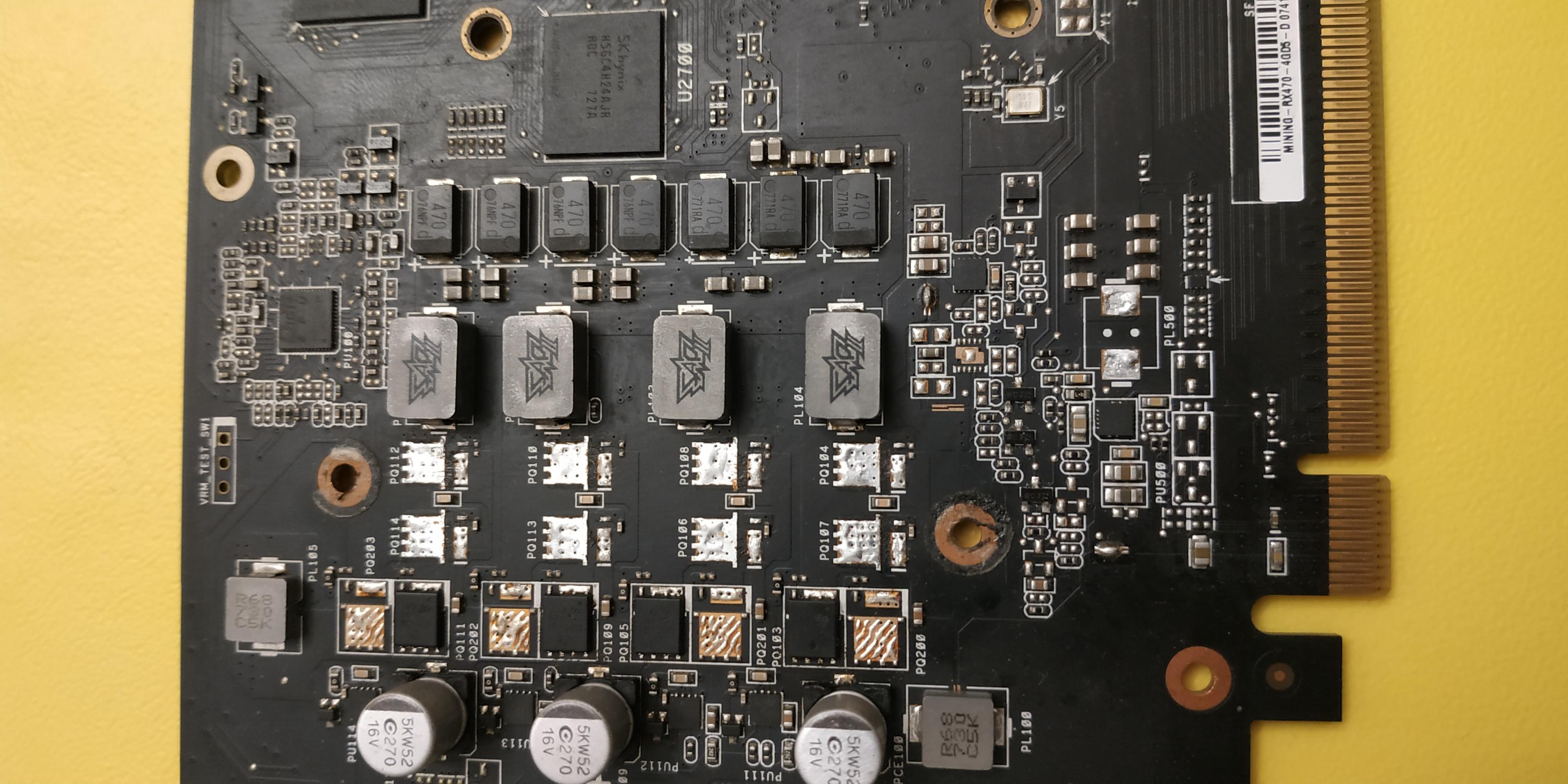

                      Here are some more tests I made but unfortunately they didn't show where the problem could be...
                      Till now with MOSFETs on high side (all low side removed) and coils motherboard want run. Then I removed all coils and motherboard runs. I put one coil and motherboard want run. After that I removed this coil and put another one to other place but again motherboard want run.
                      Then I decided to remove all low side MOSFETs and to put the coils. Motherboard runs. After installing just a single MOSFET on low side motherboard want run.
                      Is that means that with removing all MOSFETs I am disconnecting the short from one side and removing all coils I am disconnecting the short from the other side?
                      I am uploading two photos just for visualization (motherboard want run in both situation).
                      Thanks,

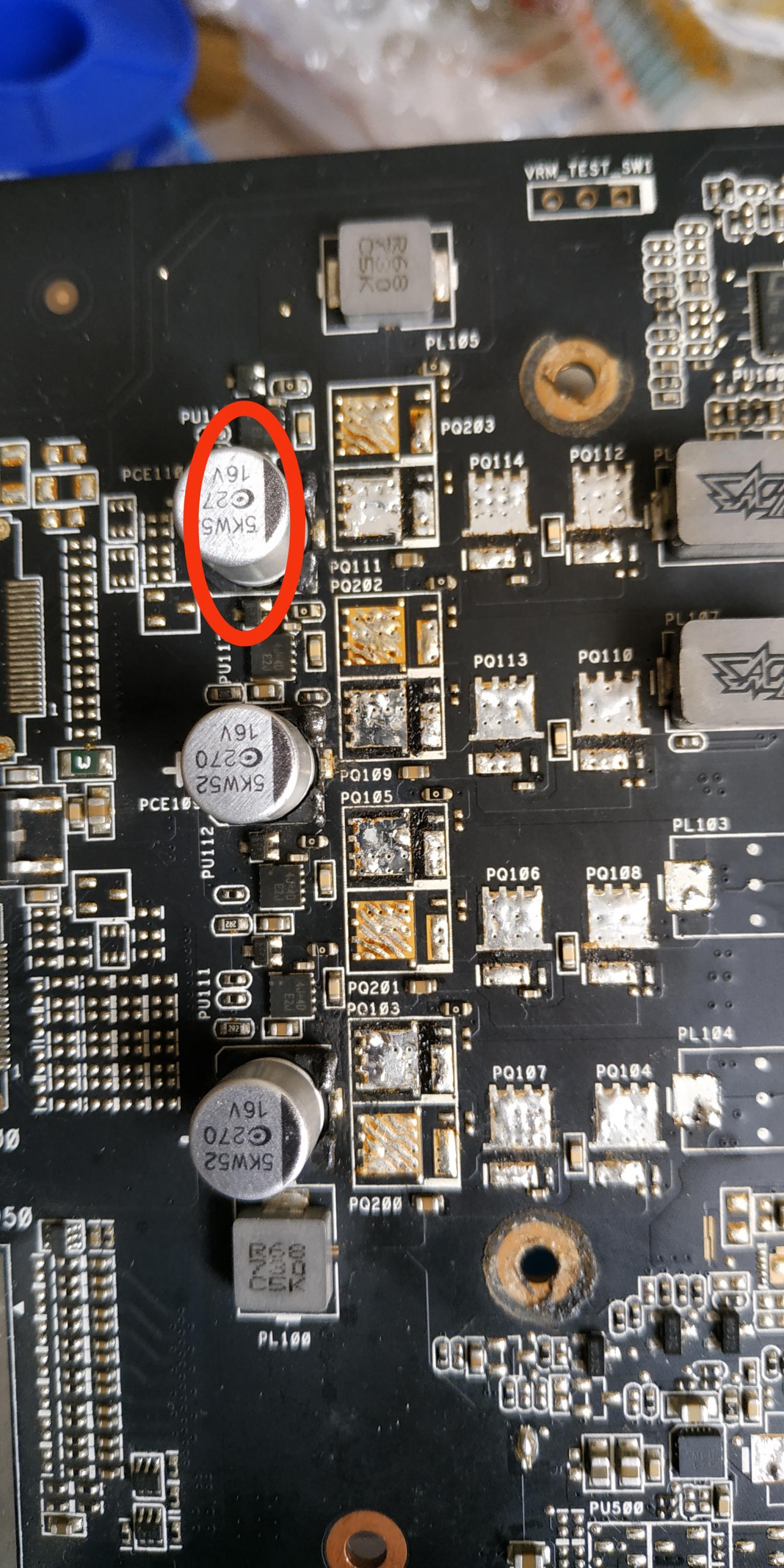

                          I just turn it on to measure voltages but smoke come out from the cap

                            In those photos, are these new MOSFETs? If you put back a shorted one, it would make sense the short is still there and card won't power on.
                            I already saw in the above photos that those caps got some heat damage. You should really protect them. Better replace them all: toxic fumes and risk of popping.

                              When I find a MOSFET dead I don't use it anymore
                              Caps were ok but the heat from the gun melted this plastic under.
                              Whe I have time I will remove the cap and measure it....

                                You said smoke came out: DON'T reuse it!
                                  Re: RX 470 mining short
                                  Does the cap show any sign of damage? If smoke came out, that should be a catastrophic failure and hence clearly visible. Also check the neighboring components: MLCCs, the MOSFET driver chip, resistors before applying power again.
                                  Things like his can easily cause a chain reaction of popping components if something is overlooked in a rush.

                                    Ok, to be honest I am not 100% sure that the smoke was from the cap, it could be around. I was in hurry to switch off the power .
                                    But I will post the result if there is any progress....
