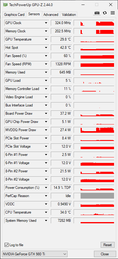

    Card booted, windows installed drivers no error 43, all good. Installed GPU-Z all voltages on all connectors normal. Started a game, as soon as card switched to 3d it gave white smoke. PC turned off and the card burnt the same parts.

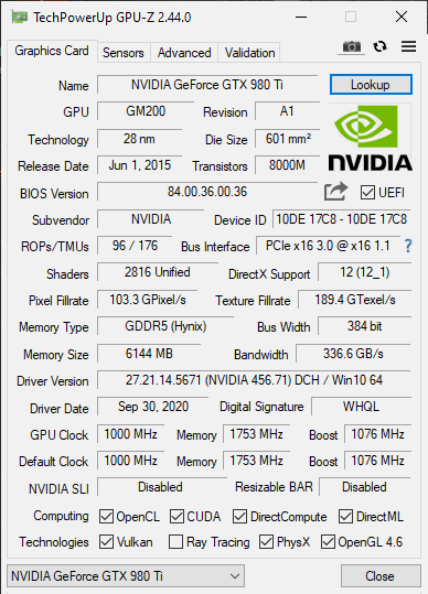

    4. Updated vBIOS to ensure no voltage mods

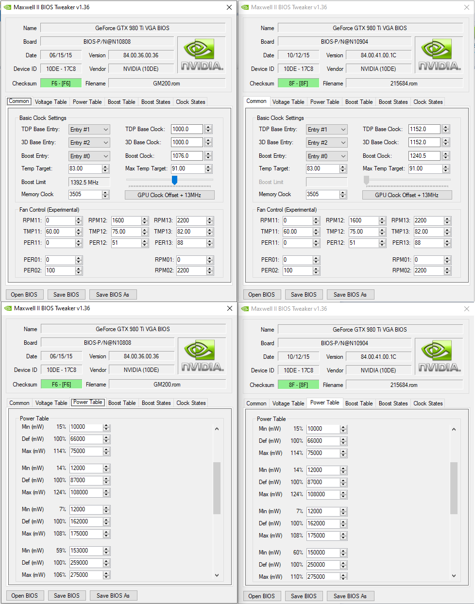

    Further digging produces no results... downloaded the original bios from the card (on the left) and compared to both versions from techpowerup. If anything bios on the card is more conservative in terms of clocks.
    Power tables are identical with limits
    PCIE: 75W
    PEX6: 108W
    PEX8: 175W
    Total: 275W
    6823A can handle 60A each, there are 2 for PCIE (switched with 6PIN), another 2 for PEX6 and another 4 for PEX8. That should be well within operating conditions.
    Never heard of core shorting only under 3d load but have not a lot of experience with GPUs either. Clock scaling in windows works normally. One thing I noticed however is that PerfCap is always idle...
    INA3221 must be working as otherwise where the card would get its power data from to populate GPUZ?
