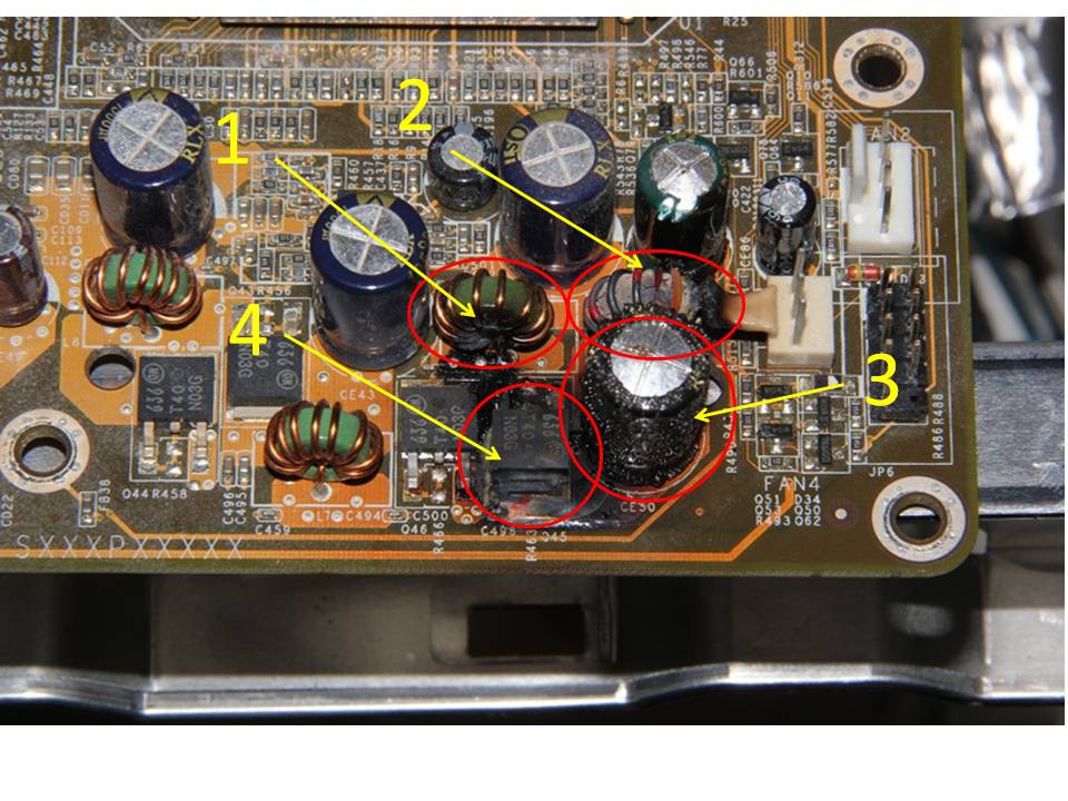

    I had my Shuttle XPC SD37P2 V2 running for 2 years until Nov 09 while I was on holiday my bro smelt something burning. Since then there is no boot. Power turns on fans start turning but nothing.
    I had this running as a SBS 2003 server with no issues.
    I have attached a picture of the caps, MOSFET which are likley to be the problem as I have check all the other components on another system and they all function (RAM, CPU, HDD, VGA).
    Reference to my picture would it be possible to replace all the components labelled or would you say its DEAD?
    If caps, MOSFET can be replaced any idea where I can get them from in UK?

    you need top remove the cap, coil & fet-pair and clean the board with IPA to get your answer.
    open the psu, i bet all the caps in it are fucked!
    tht's what always kills shuttle units.

      I reckon it's worth a shot, trouble is finding that mosfet.
      You'd probably want to get the coils from another scrap board.

        and also check all the caps on the board. the cap that is above the one that is circled #2 (second cap from the white fan plug) is also bad

          they will all be crap on a shuttle,
          but first we need to check the cause(psu)
          and strip the bad bits off to check for pcb damage.
          the fet wont be a problem International Rectifier do superior replacements and farnell stock them.

            The coil is damaged from heat, as iron powder cores are permanently damaged (loss of magnetic properties) by too high temperature.
            So you need to replace this as well. Not an easy job as you cant just use any core and wind wire around it, you need to get the correct inductance and (even more important) high enough saturation current and low enoug loss, or it will fail again.
            Now with the core not marked, this is a problem.
            Also, heat damage to the PCB might as well have caused failiures (ex disconnected VIAs or delamination) in inner layers.
            So, id trash it.
            If its really important, you would have to measure inductance, determine the apprx. saturation current (where L drops by 20%), and then go trough the whole design process...

              I'll remove the components to see if the PDB is damaged. Finding the correct coil component might be a really pain.
              I really like the case so I would like to see if I can get a less faulty mobo for real cheap and then do all the cap replacing. Any idea where I might be able to source one?

                      it may hold a via EPIA mini-itx board.
                        • 31071
                        Re: Shuttle XPC SD37P2 V2 Burnt Caps and MOSFET? - Please Help
                        these are the fet's
                        http://www.onsemi.com/PowerSolutions...o?id=NTD40N03R
                        these will probably work.
                        http://uk.farnell.com/international-...tt=IRLR8729PBF
