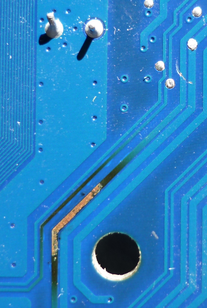

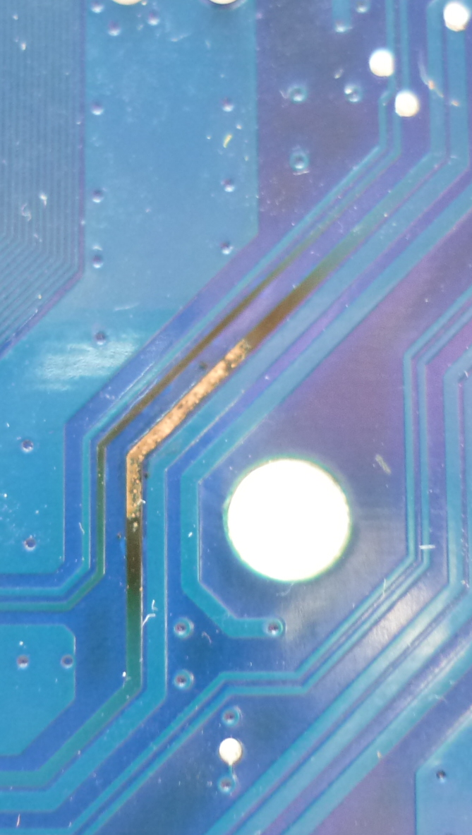

    Measure all CPU mosfets while in circuit, one of them is a dead short every which way (K3818) - could be because it's in circuit mind you.
    Then I flip it over, burned trace! As far as I can work out, the damage has stemmed from someone being too rough while installing it or with a standoff in the wrong place.

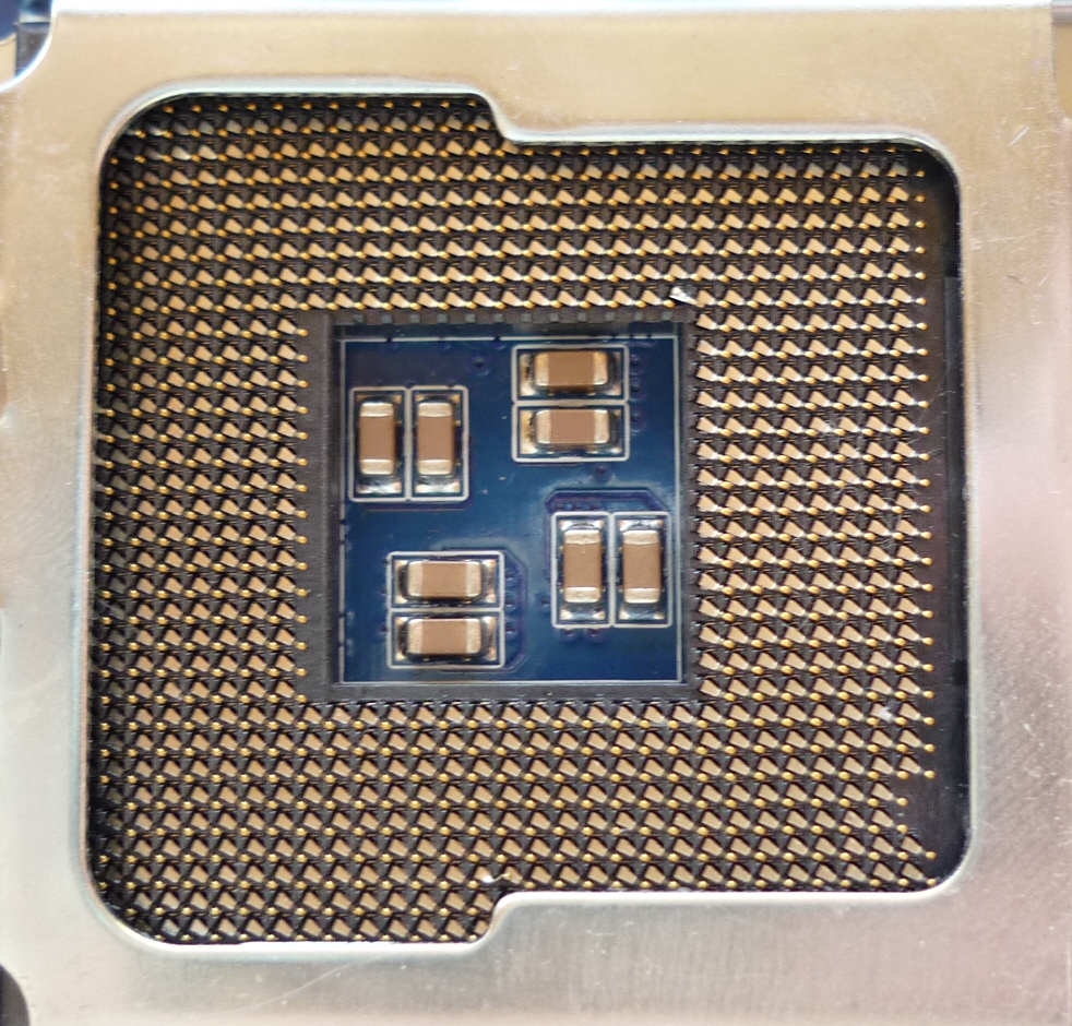

    There is also one ever so slightly damaged pin in the CPU socket but I think that will be OK.
    I guess I'll have to put a piece of wire over that trace.
    Anyone think it's salvageable?
    Edit: Just noticed another bent pin down the bottom that I'd have to try and unbend.

    those traces look like they're still OK.. just a bit toasty (bc. of the shorted mosfet maybe?)
    replace the mosfet(s) and take care of the pins first
    if it works you got yourself a nice little core 2 duo ready entry level board

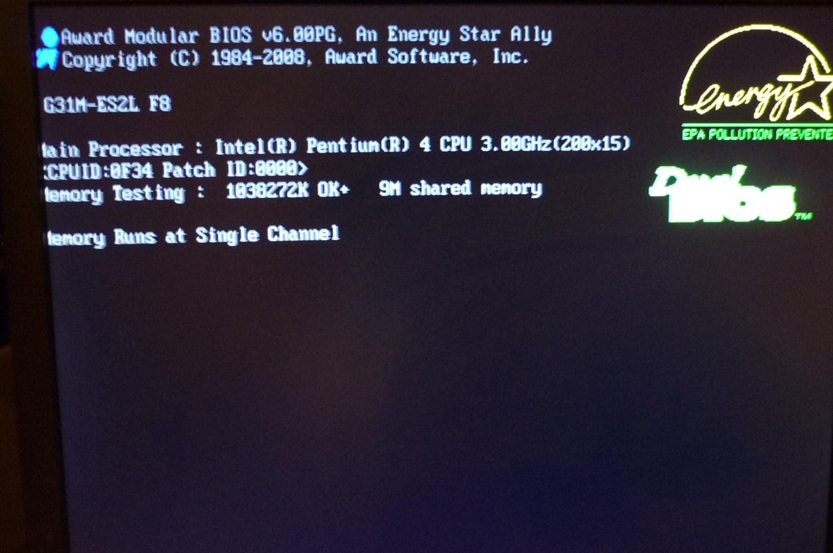

                        • seanc
                          • Nov 2008
                          • 1319
                          Re: Gigabyte G31M-ES2L fried
                          Test results > see image.
                          Need to keep an eye on that mosfet, it runs warm, might just be because it's closest to the CPU.
