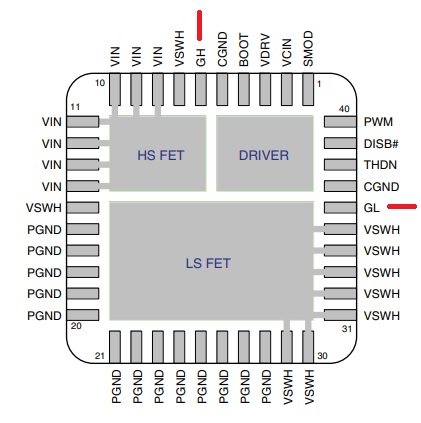

              #46
              Re: Gigabyte Aorus 1080ti - card not initialising
              Do you mean between the marked pins on the attached? (GL and GH)
              • Bozog
                • Jan 2022
                • 125

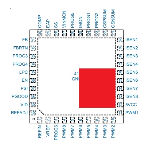

                          Whilst waiting for supplies and thought I would do some more checking.
                          Isolated the up9511 from 5v by removing the 2.2ohm resistor attached to pin 12.
                          Did another voltage injection test and have found the failed DRMOS now. As all the current on 5v was going through that it has failed with a puff of smoke and a hole in the top (this was at 2.5v, not the full 5v). None of the remaining 10 seem to have failed.
                          Had already removed a failed one at the very start of this, so am down to 10 from 12 chips.
                          Time to order more chips......

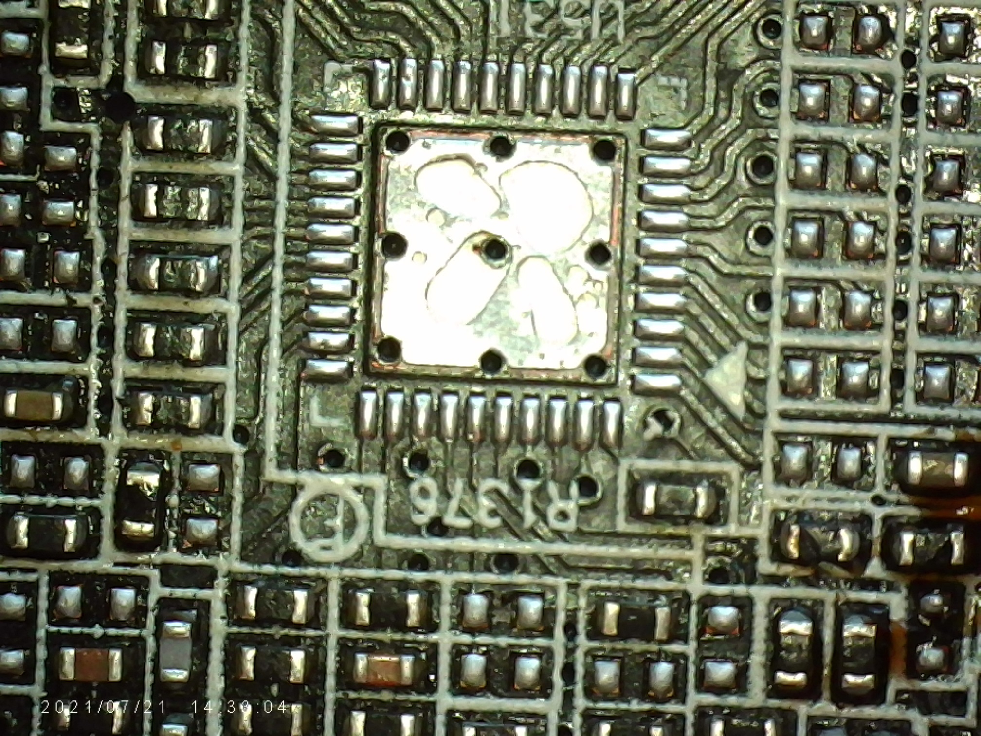

                            #53
                            Ok, progress update.
                            Received the Quick 861DW this morning. Preheated the card to 100c with a temp sensor below. Cranked it up to 460c / 110 air and low and behold the DRMOS was removed in 30 seconds!
                            Removed the up9511 in even less time.
                            Tested for 5v rail short, and voila - short gone (100k resistance).
                            Just need new chips now
