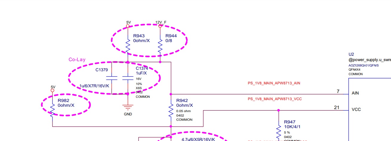

    Ok, has EN and 12v on the chip pins.
    However, no 5v on VCC pin - there are few 0 ohm resistors from 5V to VCC pin 21 (R982, R942, R943, R944) I need to check next - some of these may not be populated though.
    • benwaterson
      • Aug 2008
      • 202
      • United Kingdom
      #62
      Re: Gigabyte Aorus 1080ti - card not initialising
      Only populated resistor is R944 - 12V_F and it appears ok.
      As the other resistors are not there, there is no 5V or 12V connected to VCC pin from what I can see. R944 just connects to pin 7 (AIN)
      Datasheet says "Supply Input for analog functions. Bypass VCC to AGND with a 1uF ceramic capacitor. Place the capacitor close to VCC pin.", this must be C1372
      • benwaterson
        • Aug 2008
        • 202
        • United Kingdom
        #63
        So looking at any schematic for a 1080ti, there is mention of APW8713 all over the lines going in and out of the 1.8v buck converter.
        My guess is that this chip was used in the original design for the Titan X Pascal and the different configurations of the 0 ohm resistors mentioned above was adjusted for the AOZ1268 (also AOZ1267 is used on other boards but this is an 8amp chip, whereas the AOZ1268 is 10amp).
        I have found stock of APW8713 in the UK so have ordered one to try.
        Main differences are :
        1) APW8713 is NC on pin 7 (AIN) - has 12v supply on AOZ1268
        2) The VCC pin is used for a 5V input
        Moving R944 0hm resistor to the unpopulated R982 will disconnect 12v from AIN and connect 5V to VCC and provide power to the chip.
        Otherwise all pins are the same.
        Thoughts?

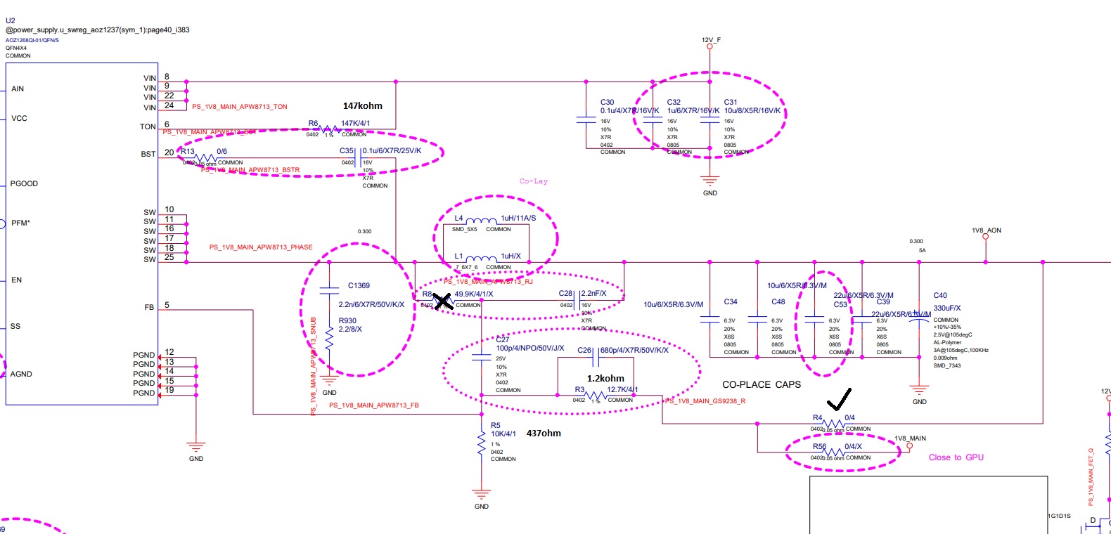

          Not sure if this is an issue, but measured the feedback voltage divider circuit and the 2 resistors measure nothing like the diagram (measured in circuit so might be off).
          R3 - should be 12.7k - measured 1.2k
          R5 - should be 10k - measured 437ohms
          R6 on the TON pin to VIN measures 10k (correct)
          R8 in diagram is not populated
          R4 present and working
          • benwaterson
            • Aug 2008
            • 202
            • United Kingdom
            #65
            Removed R5 to test out of circuit and it is 10k, so will rule those out

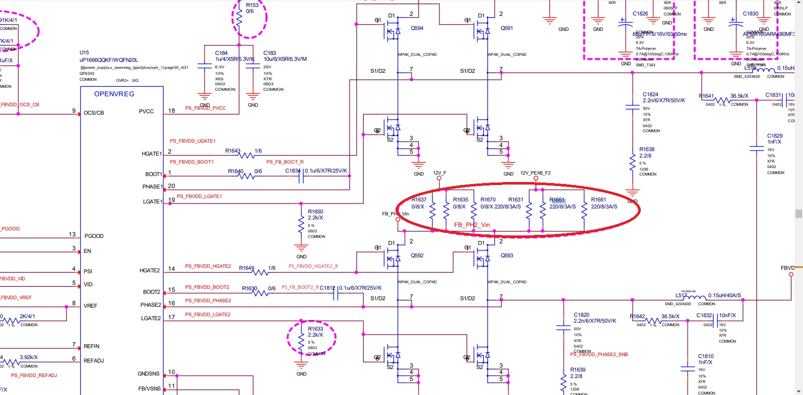

                Was probing to see why the enable pin wasn't pulling high on the up9511, found input to the mosfet that pulls the pin high, reading 2v so was making progress.
                Suddenly there was a flash of light and blob of white hot solder formed on the board so killed the power (oddly it didn't trip the OCP on the power supply).
                Appears one pair of mosfets for the ram have shorted and took out the input resistors on both sides of the board at the same time (12v). Big blob of solder on both sides of the board and vaporised resistors!
                See attached schematic of where....
                • benwaterson
                  • Aug 2008
                  • 202
                  • United Kingdom
                  #68
                  Removed the mosfet (was Q953 as suspected AON6994). Ordered more.....

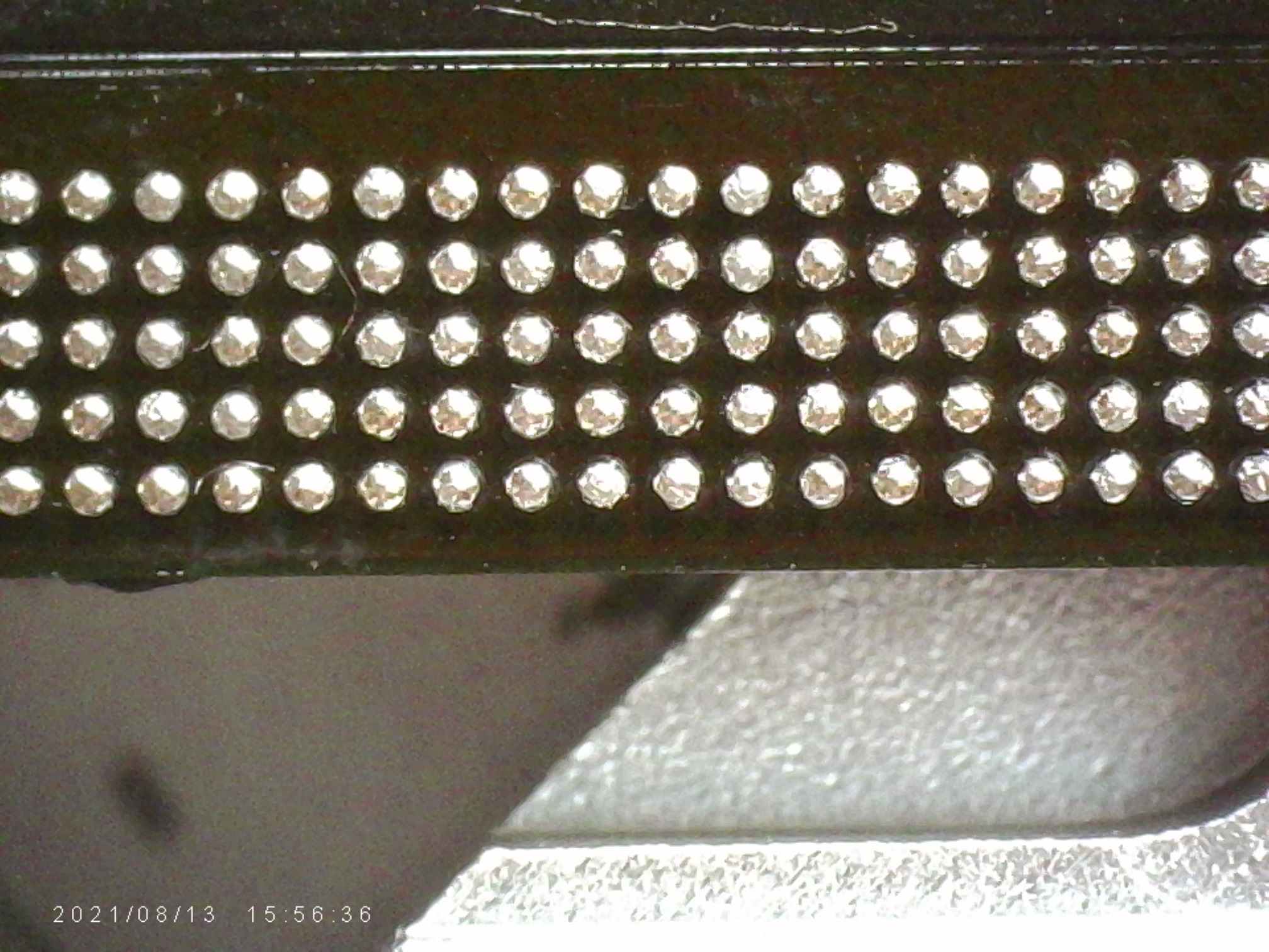

                            Decided to reball the removed ram chip because :
                            1) Never done it before
                            2) Waiting for parts
                            3) Have it ready to test if its not actually faulty.
                            Reballed by hand, no stencil. Think it came out pretty good for a first go...

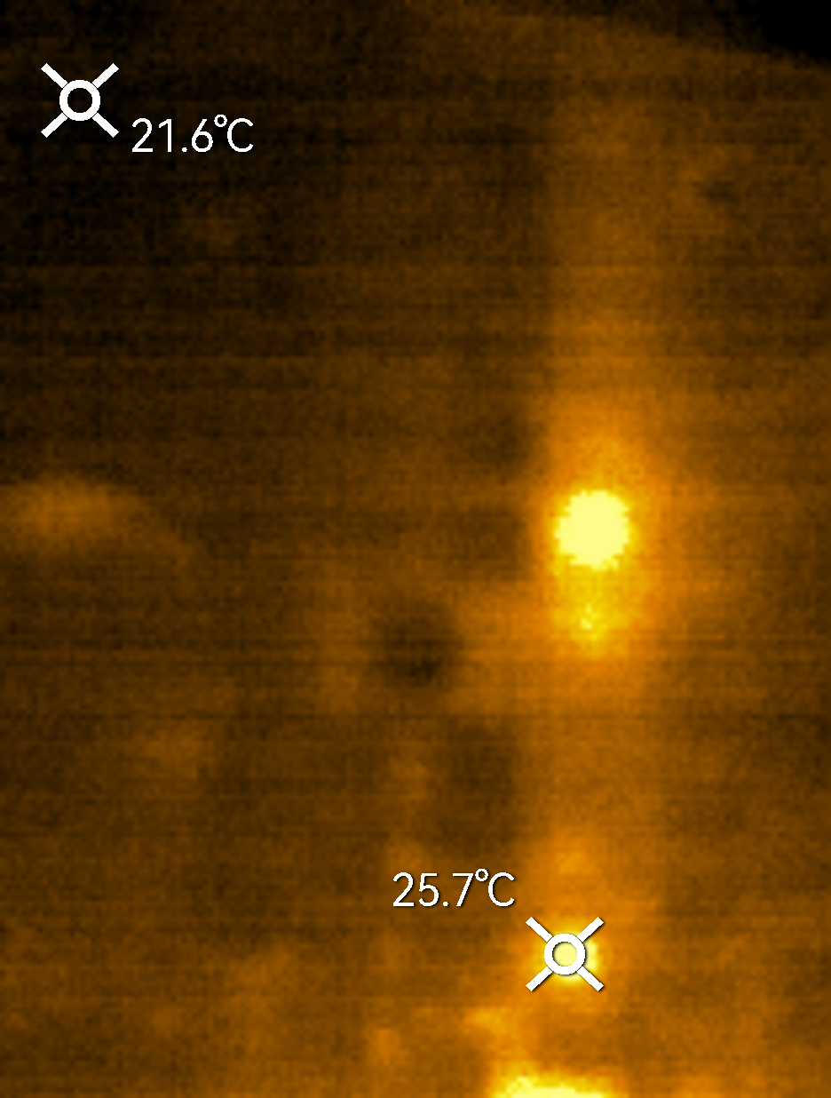

                                So thermal camera arrived so tested FBVDDQ @1v with bench psu (resistance on that rail is 1.6ohms)
                                Card is drawing 3 amps and there is slight heating of all ram chips and the core, so before and after images attached.
                                Memory bank D1 was removed, D0 was the unpopulated which is why there is no heat top left above the core.
                                (The pcie fingers at the bottom are reflecting the IR so they show as a hot area)
                                I can't see any other areas heating on the card otherwise, front or back.

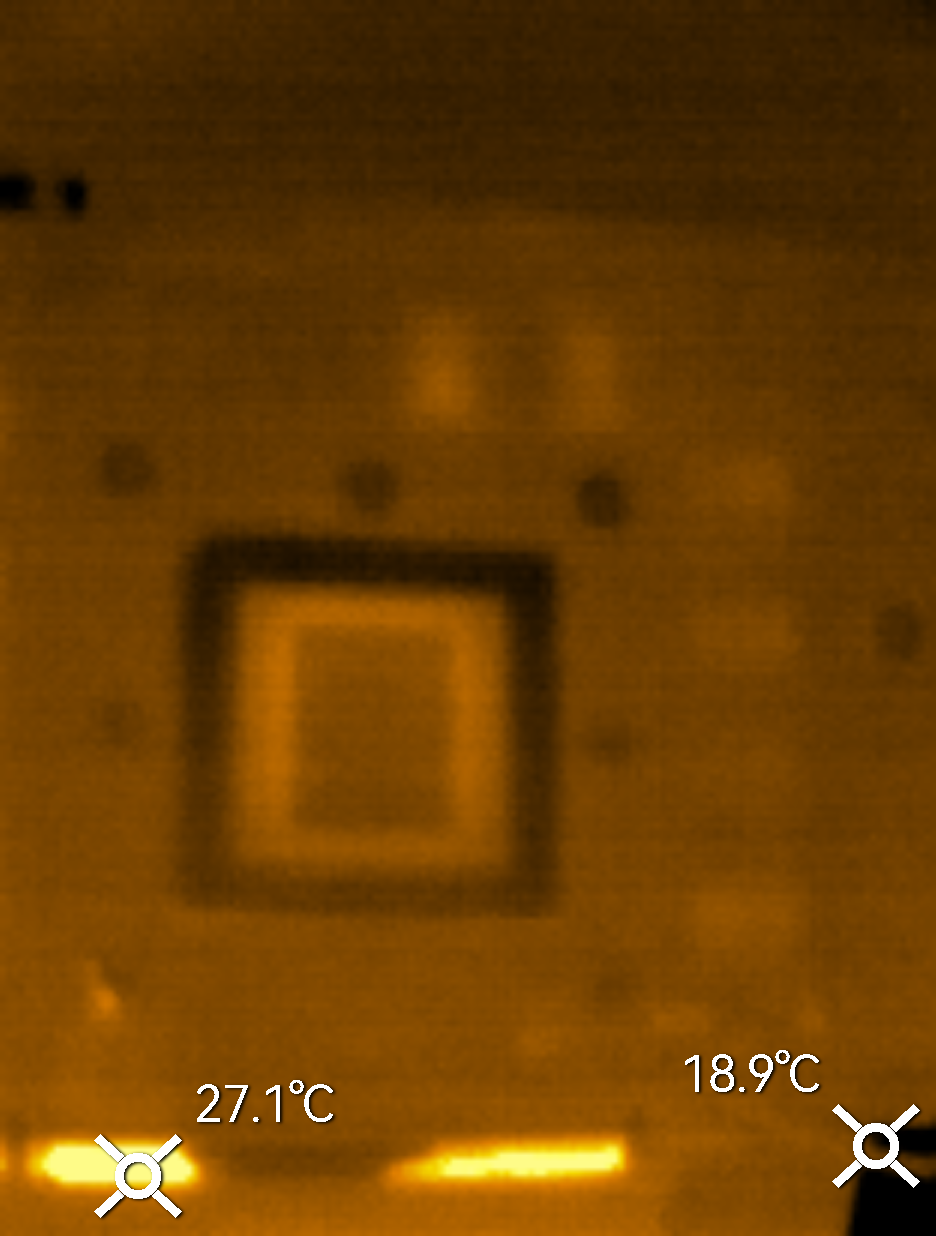

                                  Similar story on the 5v rail (resistance 7ohms) - pulls 0.9a at 2.5v
                                  2 x DRMOS heating (2 already been removed)
