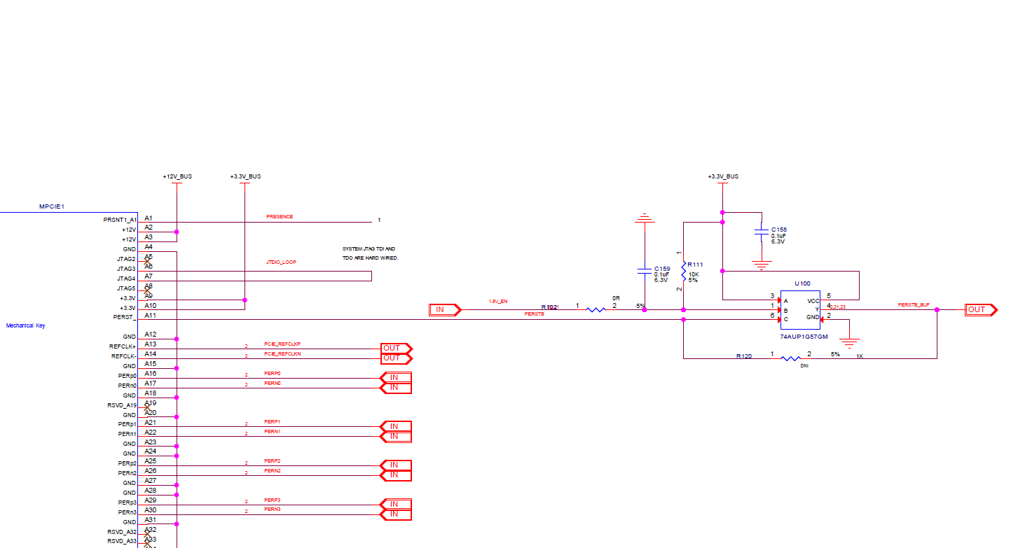

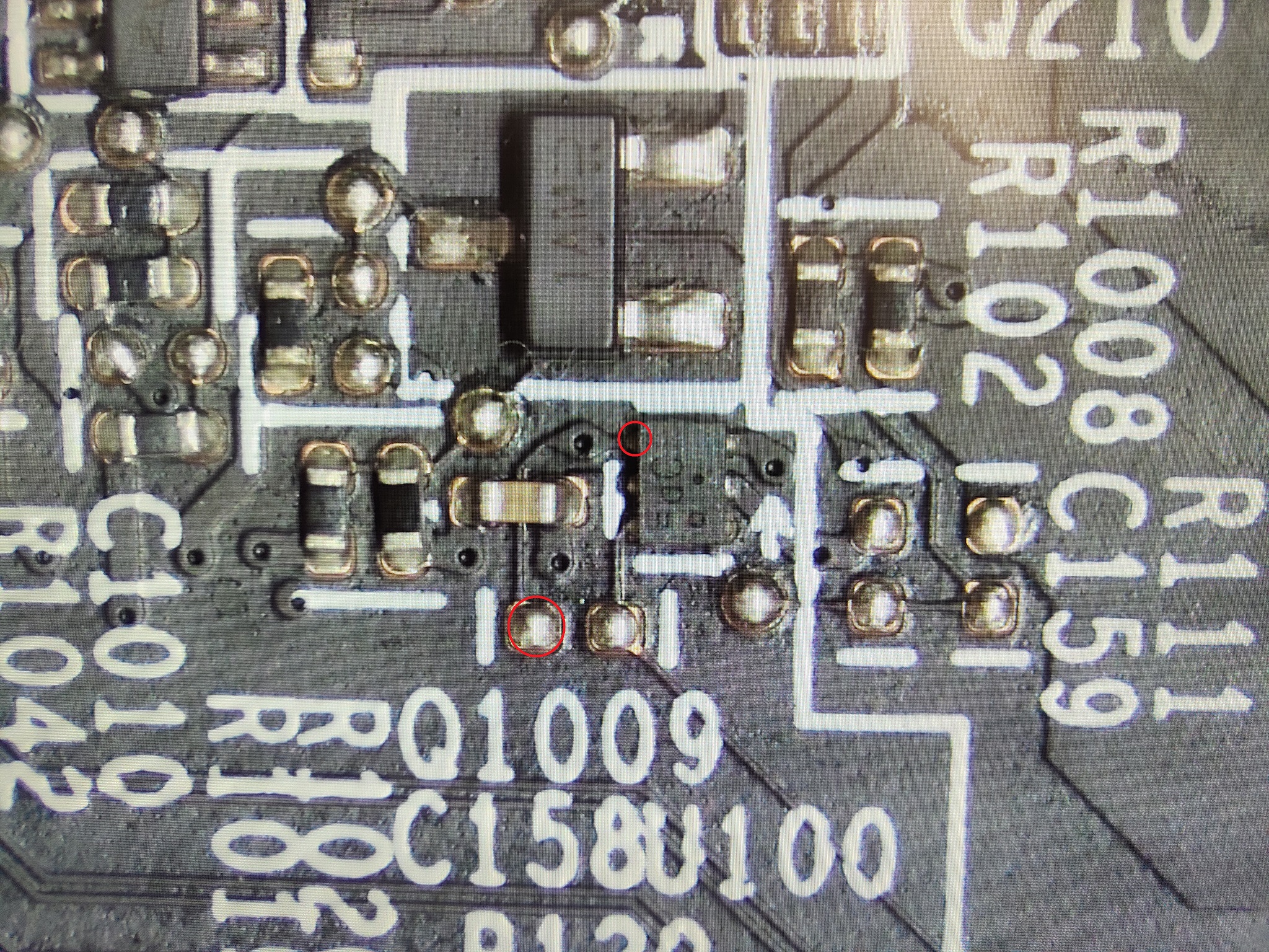

        Re: RX580 Gigabyte Gaming 8GB - Micron - Boots only if I do the BIOS short
        On the back of the board near the pcie slot notch probably, look for U100 you should have 3v3 coming out (see the schematic I posted)
                You need to make sure the gpu is coming out of reset by checking for 3v3 on pin 4 U100, if you have that I would then try probing pin 1 on the bios chip with a scope again, to ascertain its being read. You should see some fast falling/rising edges, which maybe difficult to capture without using a single trigger.
                  You mean to have 3,3V on this pin circled in red right ? Well , I have and also I have on both pins under him
                      Originally posted by Goblin999
                      A friend told me that I should try a GPU chip reflow , but I am not so sure about that . Never done it and I don`t want to break something
                      Yeah don't do that unless you're certain that is what the issue is, and definitely don't do it with a heat gun.
                      I have circled pin 4 in red, looks like there is a handy place to test on my board.
                        Thanks , I will get right away to measure it . Also you have the same card ? Can you provide me the stock BIOS ? I tried several bios versions and none of them worked - maybe it is a bios flash error ? (I write them in Hive OS - after I short the pins of the bios chip so it can boot) . Also after I boot the Hive sees the card and start mining but gives some strange error temp . I will attach a photo
                          Measured the little spot you showed me because it`s the same as mine and I get 3,3v . Also tried again with the osciloscope on the pin 1 of the BIOS chip and nothing happens . When I put the osciliscope on the motherboard BIOS chip I can see some oscilations , but on the graphic card nothing . So I respume the GPU chip doesn`t communicate with the bios or something like that idk

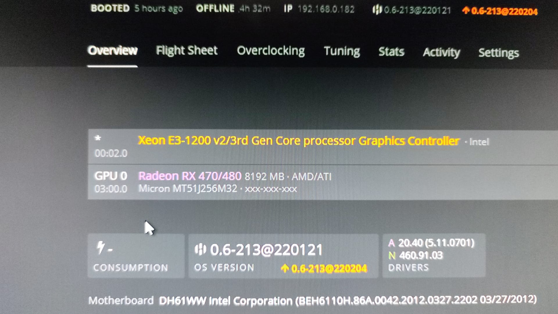

                            I think my card is an MSI RX480 4GB Armor, why does Hive say 470/480 is that normal, your card is a 580 no?
                            The correct bios will be on techpowerup, would need to see the label and the memory type to find the correct one.

                              Because of the short I do on the bios it shows that I think . Tried several bioses from that site based on the memory type (micron) . I also found on the gigabyte website bioses and that is the last one I used based on the label on the graphics card
