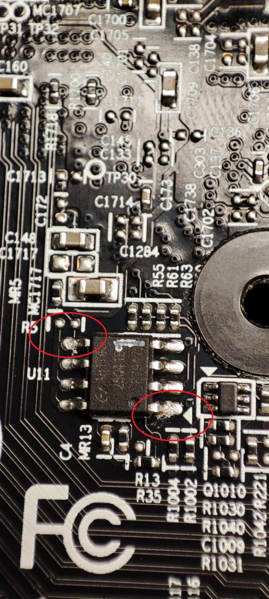

So I just got off ebay this Gigabyte RX580 Gaming with 8GB Micron memory . The thing is the card only starts if I do the paper clip short on BIOS . I booted using the paper clip method in Hive , reflashed the original BIOS again but still won`t boot unless I do again the short on pins 1+5 . Anyone knows why , or how should I recover from this ? Thanks

Pins 1 and 5 are chip enable and mosi, why would you short those?

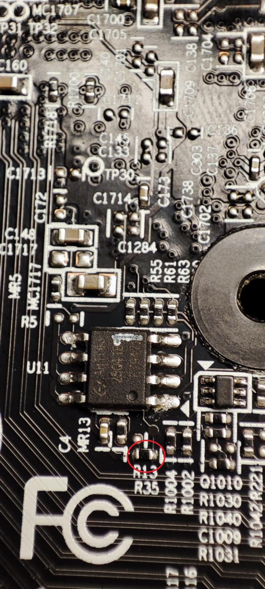

You can check the resistors in the chip enable line, seems unlikely the chip itself is bad since you can get it to boot and flash, but you never know. Does this card not have dual-bios and a switch? -

So I shorted the pins marked with red circle , and managed to reflash BIOs 2 times (once I flashed a hynix memory by mistake)- and afterwards I flashed the original BIOS from gigabyte forum . The thing is the pc won`t boot unless I do again the short on those pins . Unfortunately it is a single mode BIOS (no switches) . Can you point me where I should check the resistors ? ThanksComment

The 1k resistor looks like its the pullup anyway. Well then I have no idea, nor do I have any idea why you are shorting chip enable and mosi, or why that would make it boot...I think maybe this is a red herring and shorting those pin is not what is making it work.Comment
