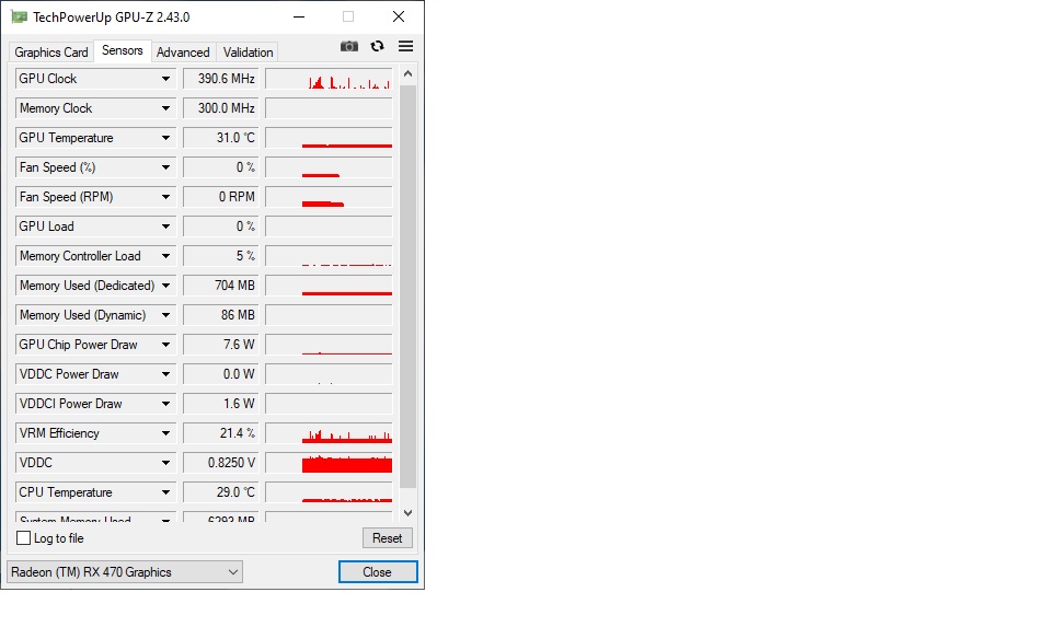

    Hello to all,
    I repaired a RX 470 4Gb from sapphire it was a mosfet HS on the VCORE only 1 and the card works again in games.
    Except that at the time of the test FURMARK I have falls of frequencies of approximately to 300mhz then goes up in the 1030 mhz every 5 seconds or more when it turns to 73 degrees approximately.
    The image jerks then becomes fluid again and so on as loss of images per second
    In games it makes him from time to time falls of FPS
    This is not ideal during the game =S
    Is it an unstable capacitor on the +VDCC line of the vcore?
    What advice =D
    Thanks a lot to you

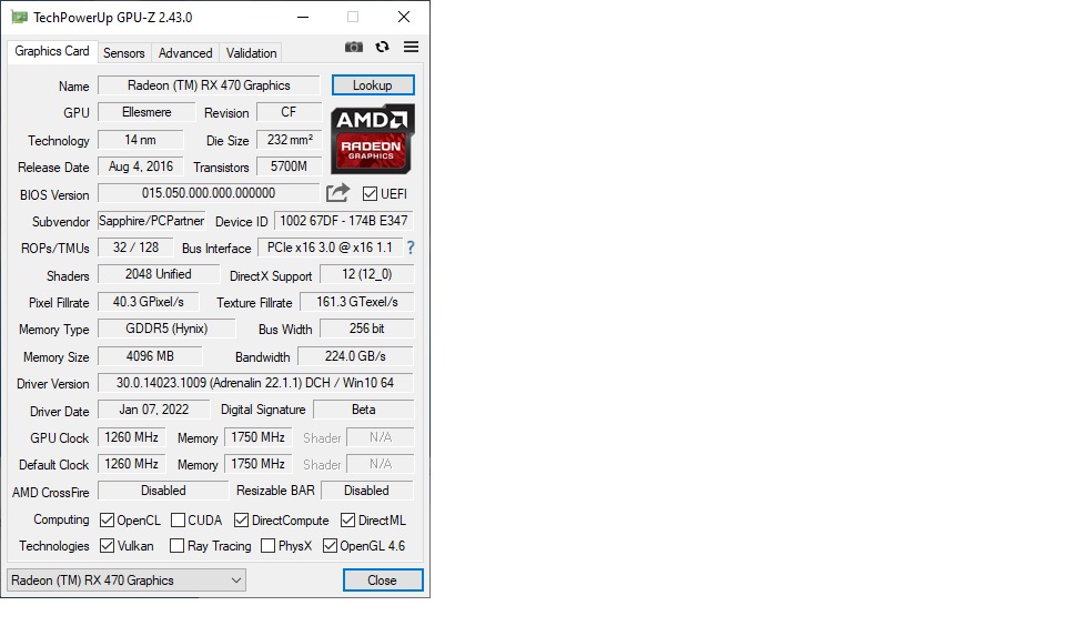

    Seems strange, have you checked the phase for the drmos you replaced is actually working, ie. with a scope or frequency meter?
    Also, why is the core clock not going upto 1260mhz?

      Honestly I don't know it seems bridled. I took the bios on https://www.techpowerup.com/ which is for a Nitro + RX 470 4gb (The only one possible)

      According to GPUZ, VDCC does not seem to be equally stable, sometimes dropping to 0.80 and peaking at 0.90 v few seconds
      Any other ideas? =D

        I come back to the news and with good news
        I re-welded the IR3553M phase controller because the hot spot climbs in a few seconds 43 degrees on the thermal camera.
        Now no loss of FPS on Furmark and the core frequency remains in the 1000 to 1050 mhz.
        Why doesn't it go up to its 1260Mhz?
        The voltage remains stable at 1 V on VDDC
        It works on the 2 internal bios of the card with HDMI and display port.
        Thanks to the thermal camera really indispensable tool.
        =D

            hello Only one phase was overheating and since then none. It seems to me that last month I also had a RX470 4gb going to the maximum at 1090 mhz for the Core. So maybe normal
