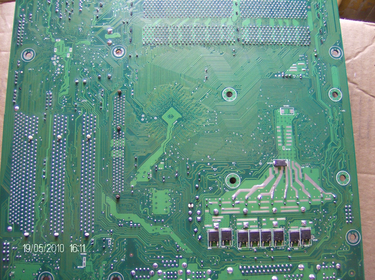

    hey, this p4sd mobo from another hp d530 sff is giving me the 3 red flash, which according to its manual is the Processor not seated/installed error, of course the proc is seated and installed, and works (tested on other pc) so i was wondering if anyone could point me to which direction should i look for... given this specific error.
    Due to the rush i didnot checked the status i recieved the mobo
    i have also replaced the caps i found blown (not all the caps on the board, just those that looked bad)... if you think i should replace any other specific cap due to this failure, please advise, im up to hear any opinion. I also applied a little heat to the board and i dont know if that may have damaged it, what do you think?...
    I suspect of tracks on the board, or some sort of passive element shortcircuited, maybe an IC.... and nothing seems wrong, like burnt and that, with the board...
    so, whats on your mind? any tip or idea is highly appreciated.
    thanks.
    peace.

    Take pictures of both sides of the board, highlight the capacitor you replaced.

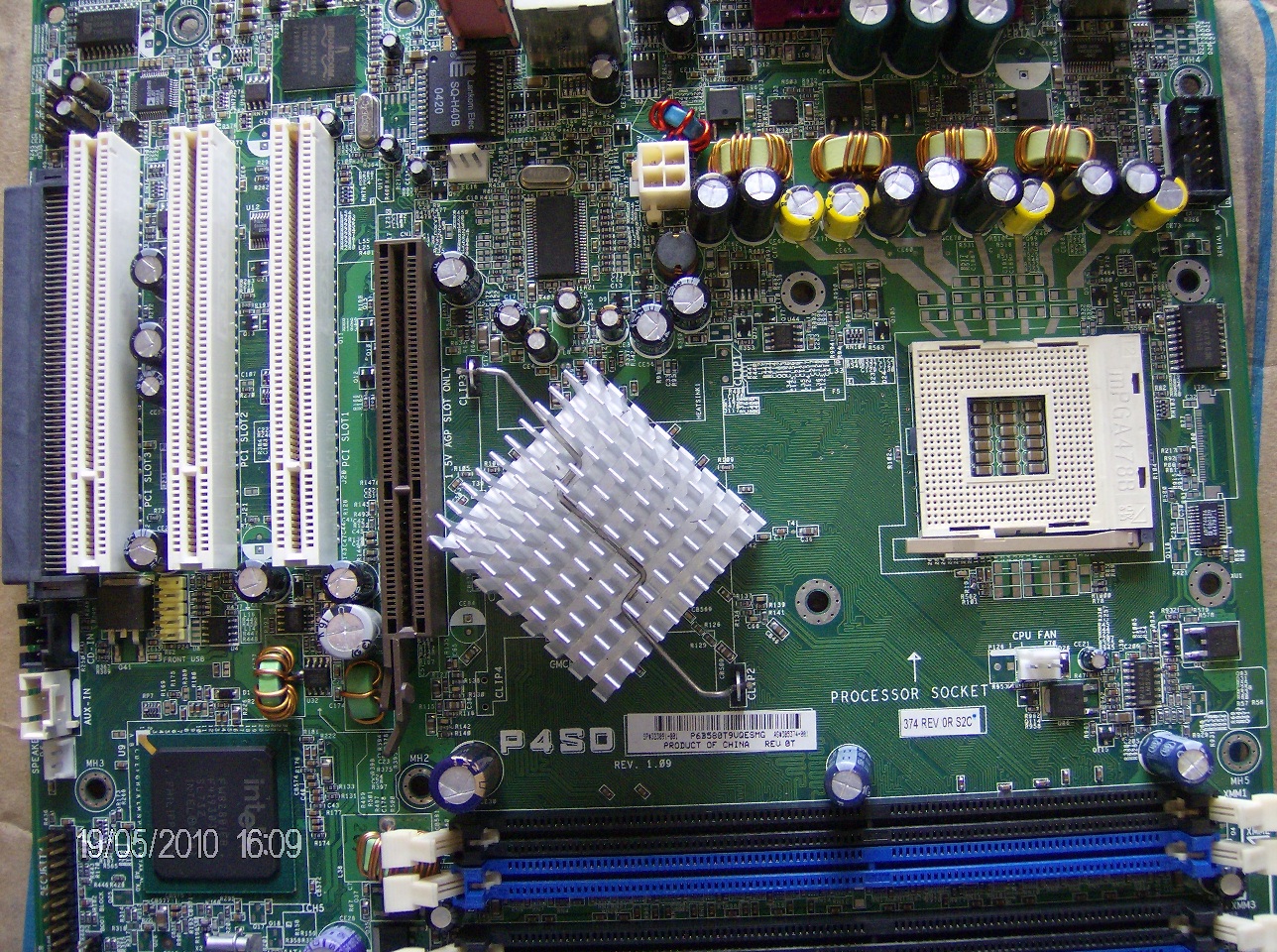

        SORRY for the late delay, i really am thru a bunch of stuff around...

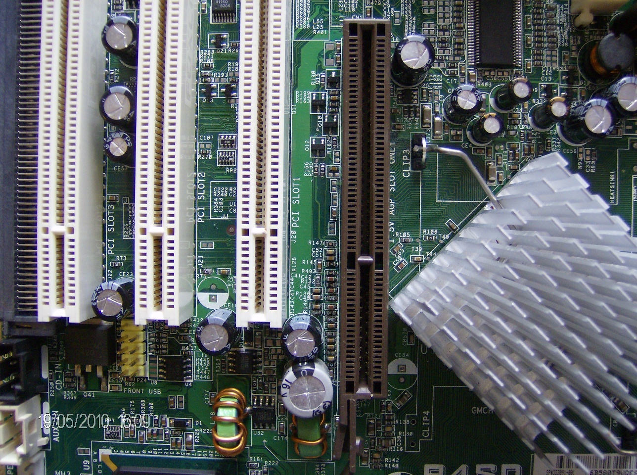

        In this i changed the one to the left of the AGP port, the one that reads "16 V"...
        I didnt change any of em here cause accordig to me they look ok...

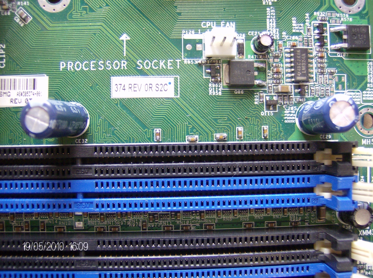

        I changed these two, 1800uf 6.3v...
        General overview...
        ANY Tip or info is highly appreciated.
        Peace.
        And sorry again for the delay.

          You put that white cap in, what is it?
          Are those two blue LTEC 1800uf? Why? Can't you put some Panasonic low ESR caps in?

            the white one is a..mm dude the only logo it has is like a rounded-corners triangule with letters "C G E" in it... there was originally a 560uf/4v but since i couldnt find that one i picked the closest i found... 680uf/16v
            yeah the blues are Ltec but they are 1500uf my bad, 6.3v and the reason is because thats what i got and i havent found others, i am very limited when it comes to finding new parts, specially good ones, my bad again :s

              A 680uf 16v replacement is easily available from Panasonic, same for 1500uf, you can use a higher voltage.
              FM, FC, or FK <- best, starting from left to right.
              Edit: Whoa hang on, 560uf, 4v? Sounds like it was a polymer. Replace it with another polymer of the same value, or a Panasonic FM, most likely needs a very low ESR.

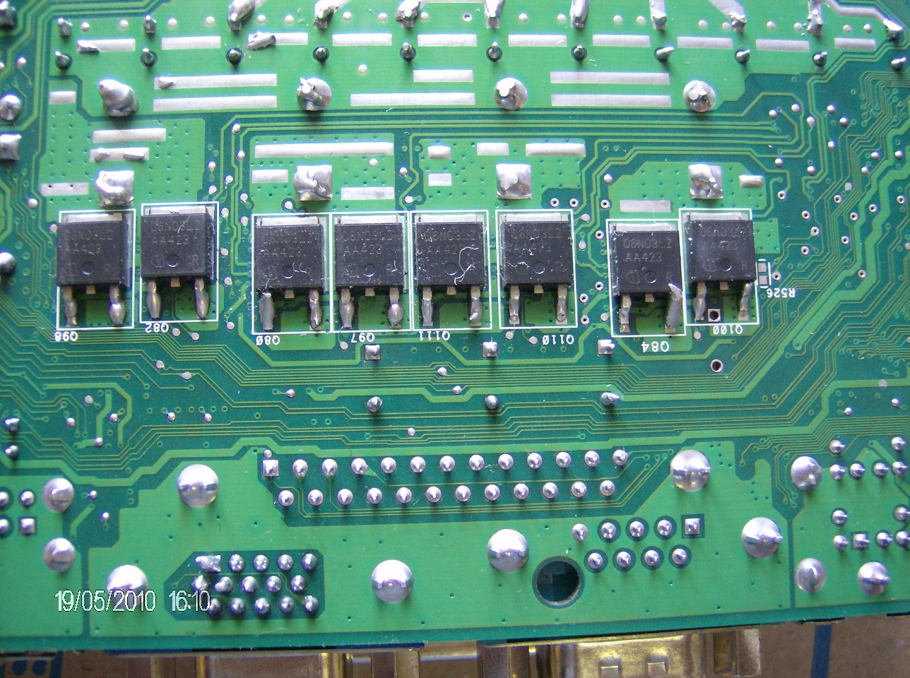

                    sorry for the horrible quality..that's best i could do with my cellphone at 12:45am :P
                    http://bambooz.pytalhost.net/badcaps/P4SD/DSC08263.JPG
                    http://bambooz.pytalhost.net/badcaps/P4SD/DSC08265.JPG
                    edit: oops i forgot. chipset heatsink got replaced by me cause the original one was all bent up and had broken off fins, and a standard s478 retention module added cause i'm using it in a standard µATX tower..
