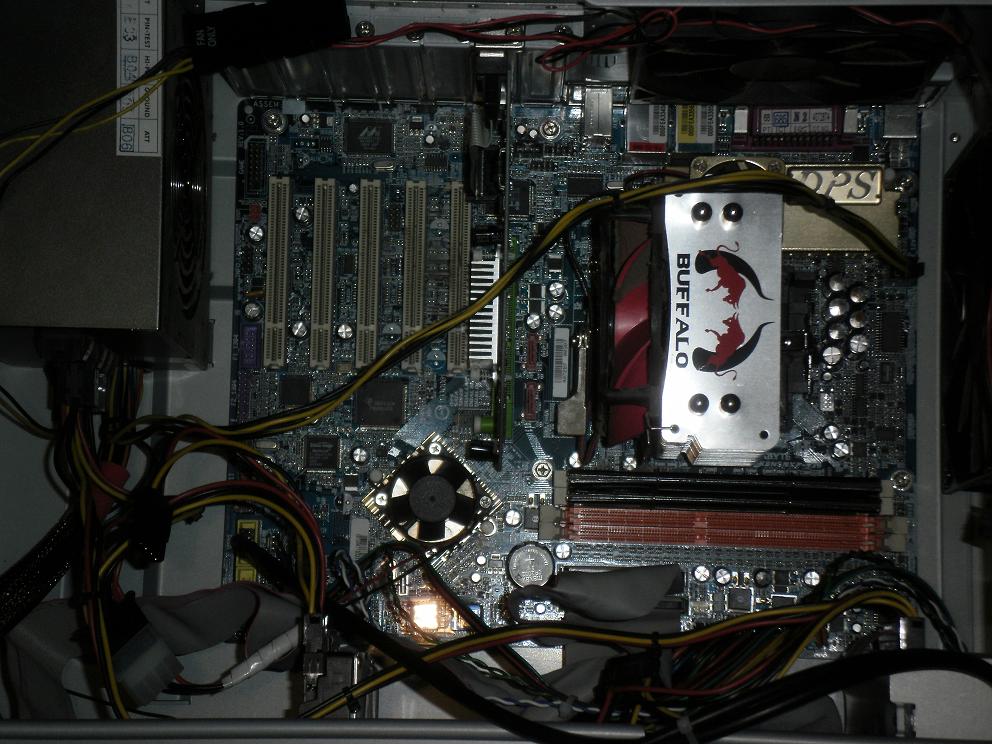

    Sorry for not having a picture to attach at this stage. I will try and get one up tomorrow. Until then, here is a link to the manufacturers picture of board: http://www.gigabyte.com.tw/FileList/...xp-939_big.jpg
    I have a system at home with a GA-K8NSNXP-939 motherboard. It has been slowly becoming more and more unstable to the point where it sometimes does not even get to the POST messages. I had a look and found that almost all 7 of the Nichicon 3300uF 6.3V HM series bulk-storage capacitors for the CPU are showing signs of being bad. At least 4 of them have vented explosively out the top and the rest are either leaning slightly or looking like they are about to vent. Several of the Nichicon 1000uF caps for the RAM regulators also look like they are on the way out.
    It's a very good system and I would like to keep it going, but new socket 939 boards are hard to come by and this motherboard was top of the line when I bought it.
    Do you think that the Rubycon MBZ series caps (of the same voltage and capacitance values) available from Badcaps would make a good replacement to the Nichicon HMs? The Rubycon datasheets () seem almost identical to the Nichicon (...
    I would just like some feedback before I order anything.
    Thanks very much,
    Nick

      Capacitors have been ordered and pictures are attached.
      Picture 1: full view of motherboard showing a hastily replaced southbridge fan and Antec Neo power supply (I have read some stuff on these forums about certain Neo's containing dodgy caps - I have not had a problem with this supply in the 3 or more odd years that I have had it so I presume it's ok but will check out later).

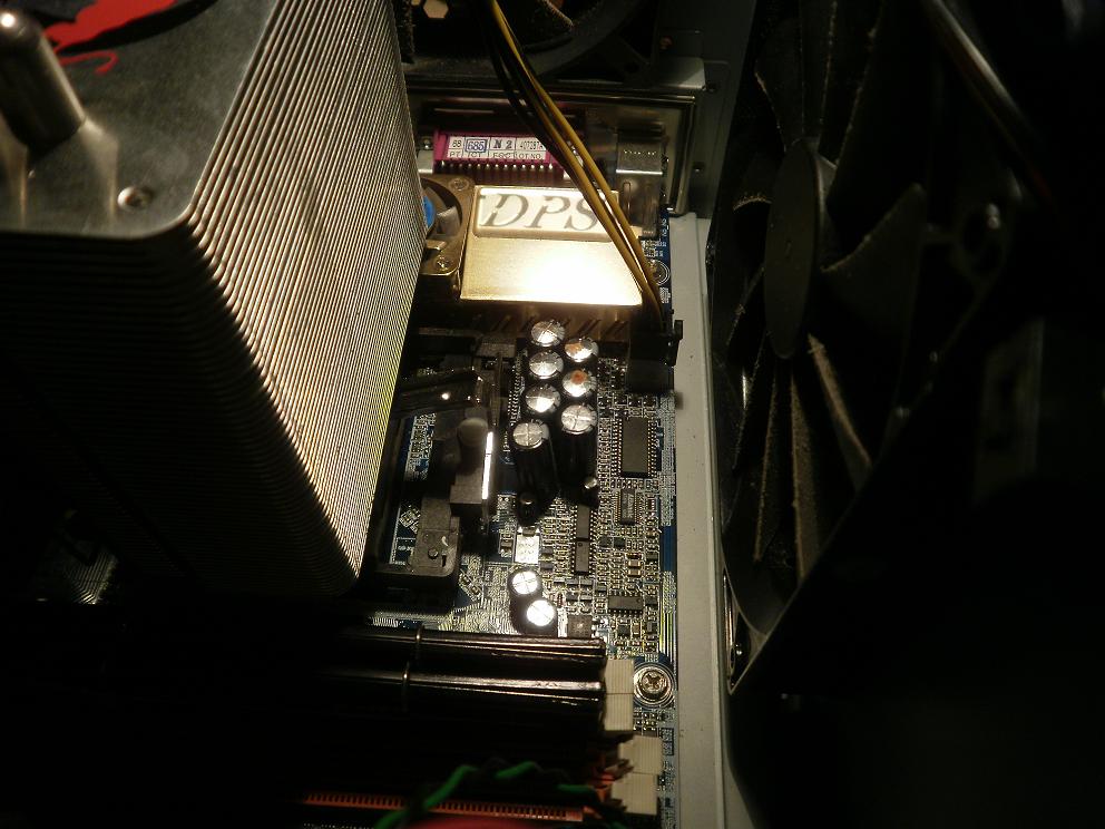

      2: the 1000uF 6.3V HM series Nichicon cap for the RAM regulator. It is bulging and leaking.

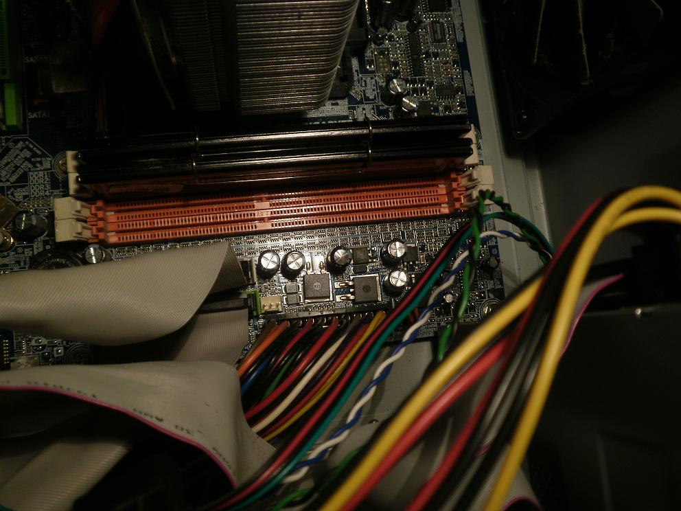

      3: the 7 3300uF 6.3V HM Nichicon caps for the CPU regulator. 3 have vented the rest are all bulging.

              I would just like to say a MASSIVE thanks to the Badcaps service. I received the caps today and have replaced all of the blown caps on the board. The Rubycon MBZ caps were a perfect replacement and since powering up, the system has been working flawlessly. No screen glitches, no unexplained system "pauses", no system halting - it's working just like it did when I built it. I've been stressing the system for the last couple of hours by playing DVDs and have had no issues in the slightest (I could have never done this with the system as unstable as it was before).
              Just as a side note, I had been checking the USPS website daily to see the status of the shipment, but it never (and still hasn't) acknowledged they had been shipped. I may have received the capacitors several days ago as I don't check the box very often.
              Thanks again and I will definitely use this service again if I have problems with any of my other boards.

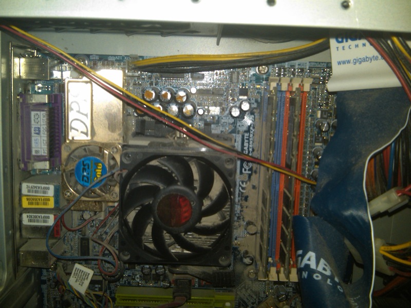

                Hello all looks like you can add me to the list of someone with a bad GA-K8NSNXP-939. Just discovered the system with that board today would no longer boot and when I opened it up I found the cpu caps leaking. I'm not sure on the RAM regulator but I would assume those will be going as well. They seem to be smaller sized though.
                Only problem is I'm not exactly sure on what replacements to order and amounts needed.
                Oh yeah pardon the dust :P

                  The bulk storage caps near the CPU are 3300uF, 10mm 6.3V types and can be replaced with Rubycon 3300uF 6.3v 10mm MBZ series caps.
                  The ones near the RAM slots (which I had found had blown also on my motherboard) are 1000uF, 8mm 6.3V types. They can be replaced with Rubycon 1000uF 6.3v 8mm MBZ series caps.
                  Just count the number you have on your board and add a few to the order in-case something goes wrong while soldering.
                  Good luck.

                                Just finished replacing the cpu caps on this mobo from the parts I ordered off this site. So far so good it now posts again
                                Now I just have to decide rather or not to replace the smaller RAM regulator ones as well. So far they look to be in good shape. However they are the same brand/model as the bad ones all Nichicon HM(M)'s with the only diff being 1000uF vs 3300uF.
                                Actually there is 1000uF 6.3v ones all over the board so its hard to tell which are the RAM regulator ones or others like AGP, etc.
