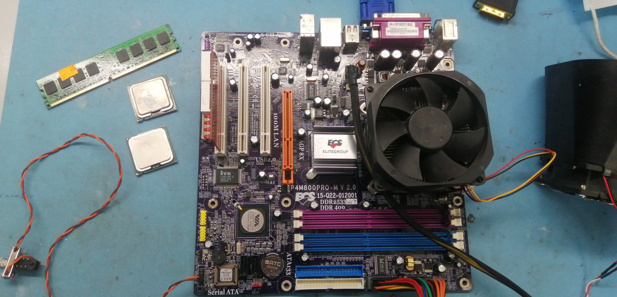

    Hi guys
    This motherboard is from one of my retro gaming rigs. It has Core 2 Duo but also has AGP, it has SATA and IDE.
    I use it on a dual boot machine with 2x SSD, selecting the boot drive from the BIOS menu - one SSD has Windows XP and the other Windows 98 SE. I have a couple different AGP graphics cards I use with it at different times, a Radeon 3450 and a Geforce 4ti 4200 - depending on what games I am playing.
    Anyway all has been working fine for ages and I have been using the Radeon 3450 for a while in XP but on Sunday decided to try some Win98 games, so I booted into Windows 98 and it just hung up. In the end I had to turn off the power, but when I turned it back on it would not boot up. I could hear a clicking noise, and though it was the IDE DVD-ROM so I disconnected that but no difference
    I brought it to the workshop and it still won't boot with no drives attached. The clicking is coming from the motherboard speaker. I tried with no RAM and with a few different CPU but no difference
    I can see on my POST test card that it is stuck in a loop
    00-D0-D1-D2-D3-E6 click D0-D1-D2-D3-E6 click
    For AMI Bios D0 = The NMI is disabled, power on delay is starting, Next the initialisation code checksum will be verified
    E6 = Enabling the floppy drive controller and timer IRQs. Enabling internal cache memory
    On the rig, I had 2x SATA SSD and 1x IDE DVD-ROM but I didn't have a floppy connected.
    Any idea what would cause this sudden failure? It's not like I was having any stability problems previously. Everything looks good on the motherboard, the capacitors look fine to me. Is it possible I somehow corrupted the BIOS when the PC crashed?
    I had a look on ecs.com.tw but could not see the BIOS file for this motherboard. I found one from drivers.softpedia.com and the zip tests virus free and contains various files including a 512Kb .ROM file but I don't know if that is a reputable site
    I really would like to get this motherboard working again. LGA775 with Core 2 support and AGP are not exactly rare like hens teeth but they are not common either and prices, like a lot of retro PC kit seem to be heading upwards. same for the AGP HD3450 and the 4ti 4200.

    Re: ECS PM800PRO-M V2.0 Stuck in boot loop
    Ohhh! That's exactly what the problem was
    I read and saved the BIOS from the chip, then programmed the downloaded one seeing as the files are the same size and I could always put the original file back in - and it worked! The board now boots again.
    I don't know what version it was but the original (corrupted?) file says 07/19/06 in the last few bytes whereas the new one says 08/30/07 so it looks like I also updated my board to a later BIOS revison
    Anyone have any theories what would have corrupted the BIOS when Win98 SE locked up during loading (when the blue bar is going across the bottom of the screen). Or maybe it was me turning off the power and just being unlucky?
