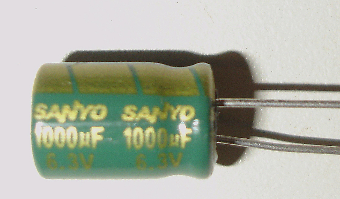

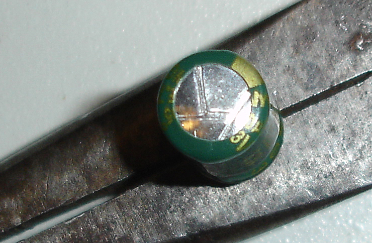

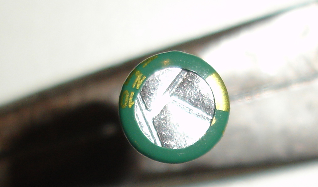

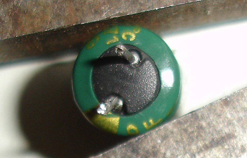

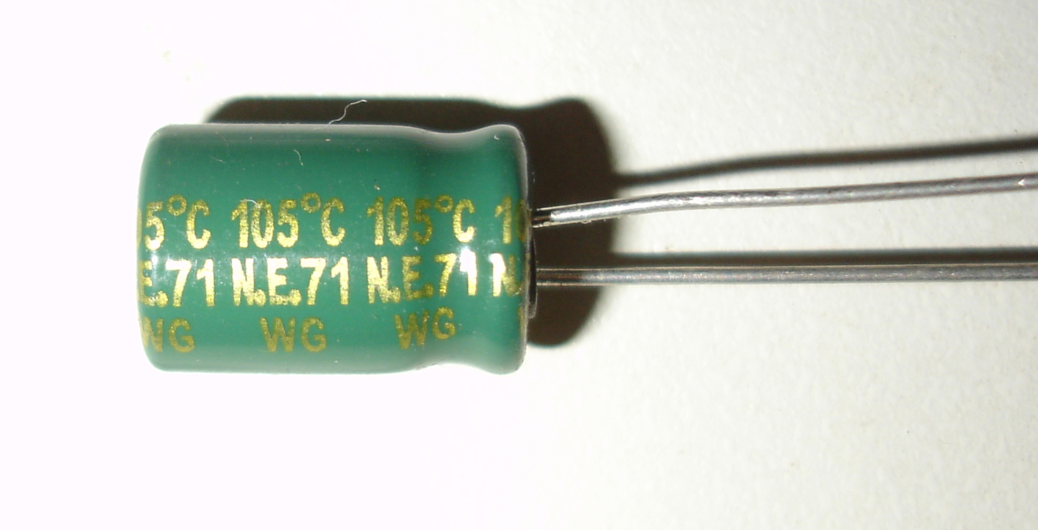

          4) Post a picture of the Sanyo WG caps you have (vent, sleeve printing, and rubber bung.) Chances are, they are likely to be fake if you got them online. I don't think you can find many legit places to sell genuine WG anymore. If you had used any of these for a recap and they bulged, it may be best to remove all of them and replace them... then don't use the rest anymore (at least not for anything you care about.)

              The Sanyo WG caps that failed are pictured below. They look convincing but I think they are fake. The first 3 pics are of an unused 6.3v 1000uf Sanyo WG cap followed by 2 pics of the bulged one that failed in use. Comments?
