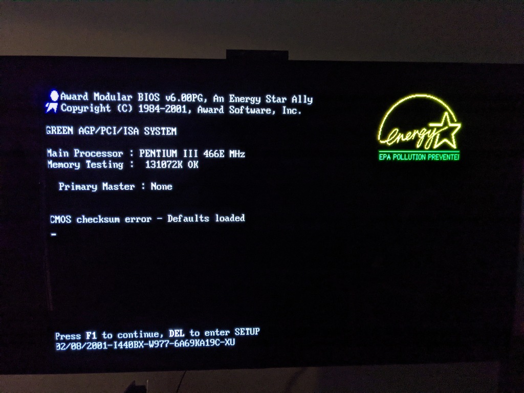

    Hi all.
    A few years ago a built a kick-ass DOS/Windows 98 SE retro gaming PC with a an AGP Voodoo 3 3000 and ISA Soundblaster Vibra 16. It was working beautifully.
    I pulled it out of the cupboard to play with it last year and it came up with a CMOS Checksum Error. I guess that was normal as it had been sitting dormant for a while.
    The problem is, I can't get into the BIOS. When I power on it shows the VGA bios screen, then it shows the CPU type, does a quick memory test, looks for a Primary Master HDD. Then it says "CMOS Checksum Error - Defaults Load, press F1 to continue or Del to enter setup"
    It doesn't seem to respond to the keyboard. I am using a known working PS/2 keyboard (I tried it in another PC to confirm). This is also the keyboard I was using on this PC before it stopped working.
    I inspected the board and found a bulging cap, I was hopeful! I replaced the cap and still nothing, I can't get into the BIOS. I've tried resetting CMOS, reseating BIOS chip, changing RAM, changing GPU, etc, but nothing helps
    No problem, I thought. I'll just buy a new one an eBay. Um maybe not, have you seen the prices of these things??? I guess this is now some sort of classic highly sought after board, so I am now even more desperate to fix it.
    I checked the fuses near the PS/2 ports for continuity and they seem ok. I'm also getting 5v from the PS/2 port with a PSU connected.
    I'm hoping that somebody here might be able to help me get this board up and running again. Is a full recap likely to fix the issue or is there something more sinister going on here? I'm not sure if the PC isn't detecting the keyboard, or maybe the BIOS is corrupted, or the Keyboard controller has blown, or something else entirely.
    Sorry for the long post. Any help would be very much appreciated.
    TL;DR My motherboard posts, but I can't get into BIOS. I replaced a bulging cap and it didn't help. Please help!

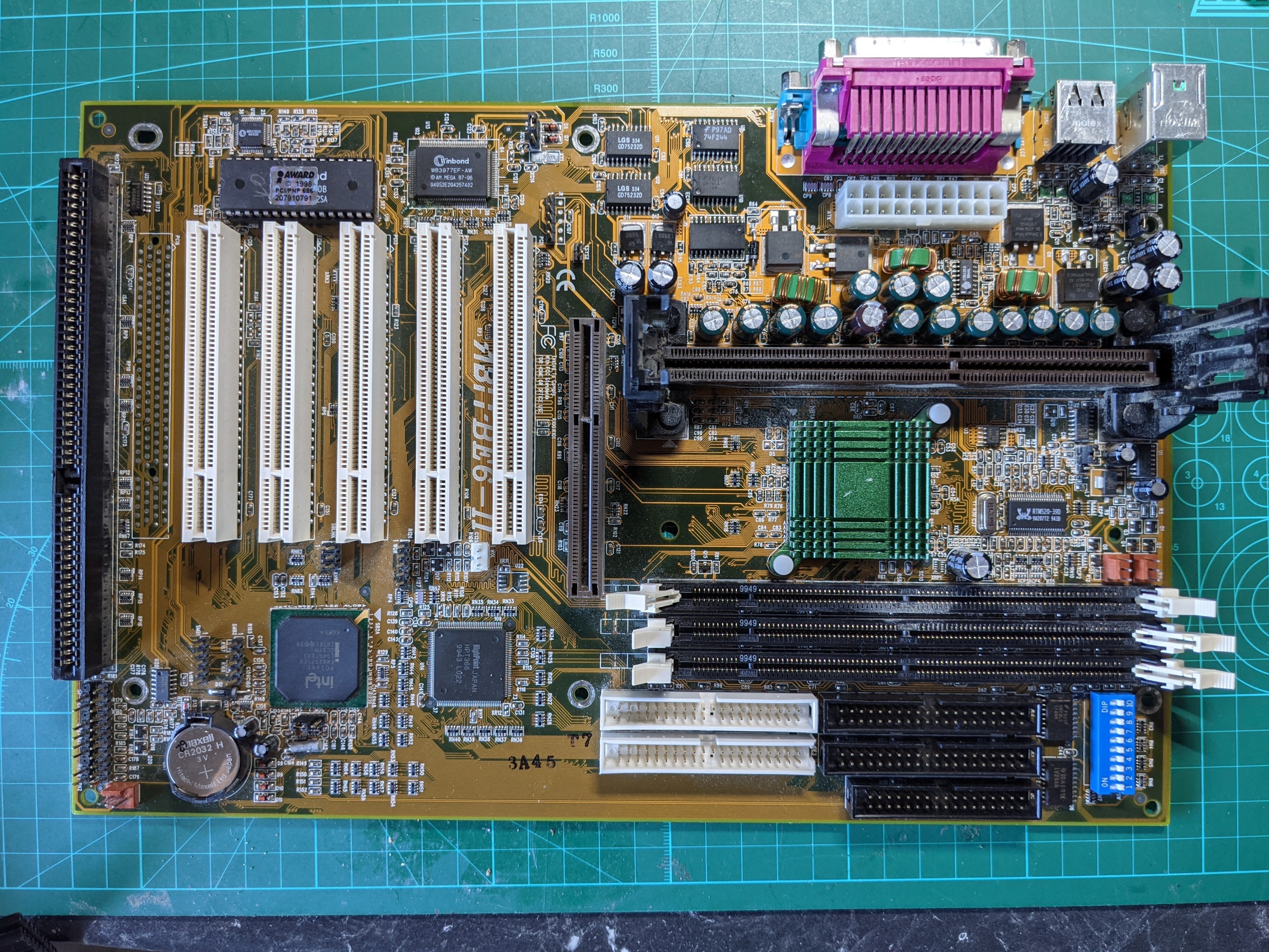

    show us photos of the whole board with the caps on it visible. if its affected by the capacitor plague, a full recap might fix it. caps can fail without bulging. also make sure the psu also doesnt have any bad caps in it!
      Thanks for the reply. I could only see one cap bulging, which I replaced. I'm hoping it's another one that has gone bad, but isn't showing it
      I was thinking of getting an ESR meter to test them without having to desolder the lot.
      I'd be surprised if it's the PSU. It's a 750w Corsair HX that has been happily running a Ryzen 7 5700X and GTX 1080ti
      Here's the pic:

            Replace every cap. The little buggers can stay I suppose, but the bigger ones (anything higher than 330uF) MUST go.

              yea looks like a boardful of tayeh caps. tayehs are listed as a junk cap brand here. replace them all with panasonic fr caps with the same size and specs.

                Thanks all. Yeah they are Tayeh. I'll do a full recap. I just wanted to see if it was worthwhile and was likely to fix this issue
