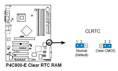

      From the manual: Section 2.7, page 2-19 ( I have this mobo )
      Code:
      2. Clear RTC RAM (CLRTC)
      This jumper allows you to clear the Real Time Clock (RTC) RAM in
      CMOS. You can clear the CMOS memory of date, time, and system
      setup parameters by erasing the CMOS RTC RAM data. The RAM
      data in CMOS, that include system setup information such as system
      passwords, is powered by the onboard button cell battery.
      To erase the RTC RAM:
      1. Turn OFF the computer and unplug the power cord.
      2. Move the jumper cap from pins 1-2 (default) to pins 2-3. Keep the
        cap on pins 2-3 for about 5~10 seconds, then move the cap back
        to pins 1-2.
      3. Plug the power cord and turn ON the computer.
      4. Hold down the <Del> key during the boot process and enter
        BIOS setup to re-enter data.
      Except when clearing the RTC RAM, never remove the cap on
      CLRTC jumper default position.
      Removing the cap will cause system boot failure!
      You do not need to clear the RTC when the system hangs due to
      overclocking. For system failure due to overclocking, use the C.P.R.
      (CPU Parameter Recall) feature. Shut down and reboot the system so
      BIOS can automatically reset parameter settings to default values.
