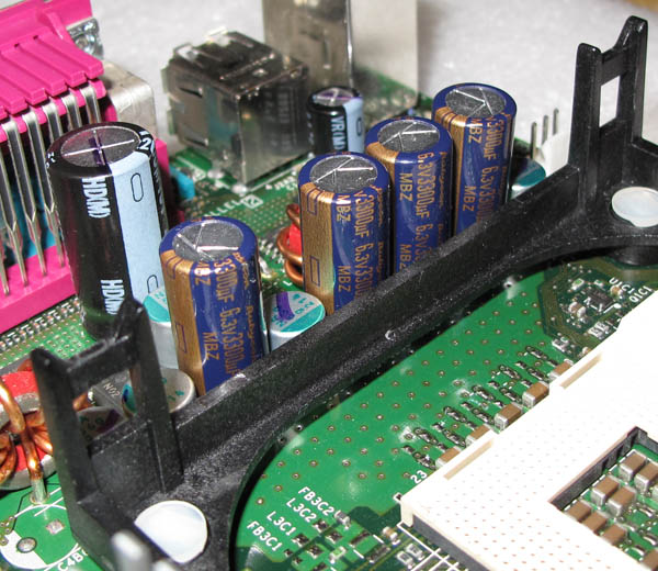

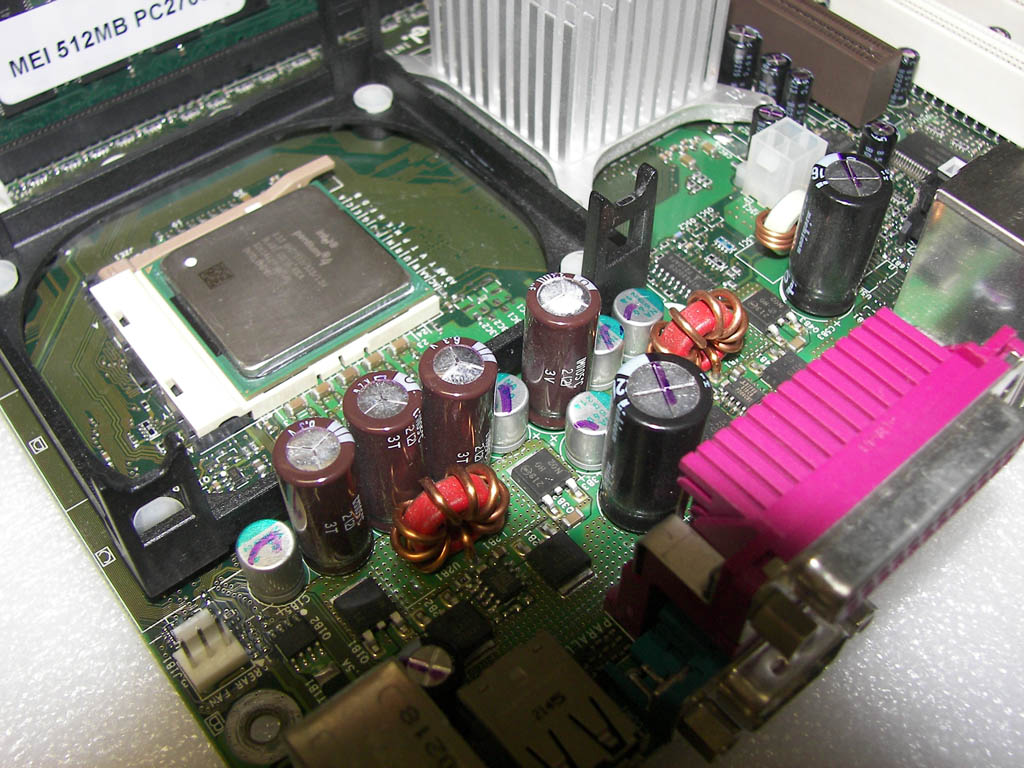

    I have 2 computers in the shop. Both have Intel D845EBG2 motherboards, both have failed capacitors in the same place.
    Board A:
    VRM is a mix of UCC KZG and Nichicon NA polymers.
    2 big Nichicon HD capactors
    Nichicon VR (85*C) elsewhere (1000uf and smaller)
    Board B:
    VRM is Nichicon HM with 2002 datecode and Nichicon NA polymers.
    2 big UCC KZE capacitors
    Nichicon PW elsewhere (1000uf and smaller)
    Both boards have bulging caps in the VRM area, near the CPU heatsink.
    Board A has 2 bulging KZG out of 4 total in the VRM area.
    Board B has 1 leaking and 3 bulging HM in the same area, but these are from the bad date range.
    Both computers had older FSP power supplies with all sorts of leaking Fuhjyuu caps.
    Interestingly, both boards could run Memtest86 and Prime95 for 48 hours each with no stability issues.
    I figure the bad electrolyte caused the NM to fail, and a combination of heat and dirty power caused the KZG failure.
    My plan: Replace power supplies with Delta units with good capacitors (done). Replace all HM and KZG caps with Rubycon MBZ.
    Should this be sufficient? Is there any need to replace the Nichicon NA polymers on the VRM? Are the two large caps connected to the VRM (HD on Board A, KZE on board B) - Are these VRM input caps? (I'm new to component repair - bear with me...) Any need to replace those? The polymers and the large caps show no visible signs of failure, but I didn't know if dirty power from a failing PSU could have damaged them.
    Board A image attached. Board B looks the same, but with different brands as mentioned.

    Yup, MBZ will be fine at the VRM output. VRM input caps are subject to much lower stresses and fail relatively rarely.
      Re: Intel D845EBG2 recap opinions
      KZG, HM, and VR need to go.

                Well I am happy to report both boards have had the bulging/leaking VRM caps replaced. Both are running stable now.
                PCBONEZ, that's very enlightening info on intel's 7 year useful lifespan. I shared that info with the owner. She still insisted on not spending the extra few dollars for more capacitors as she plans on replacing these 2 systems in the next year. However, I do appreciate your helpful advice. If they were my systems, I'd be doing things differently.
