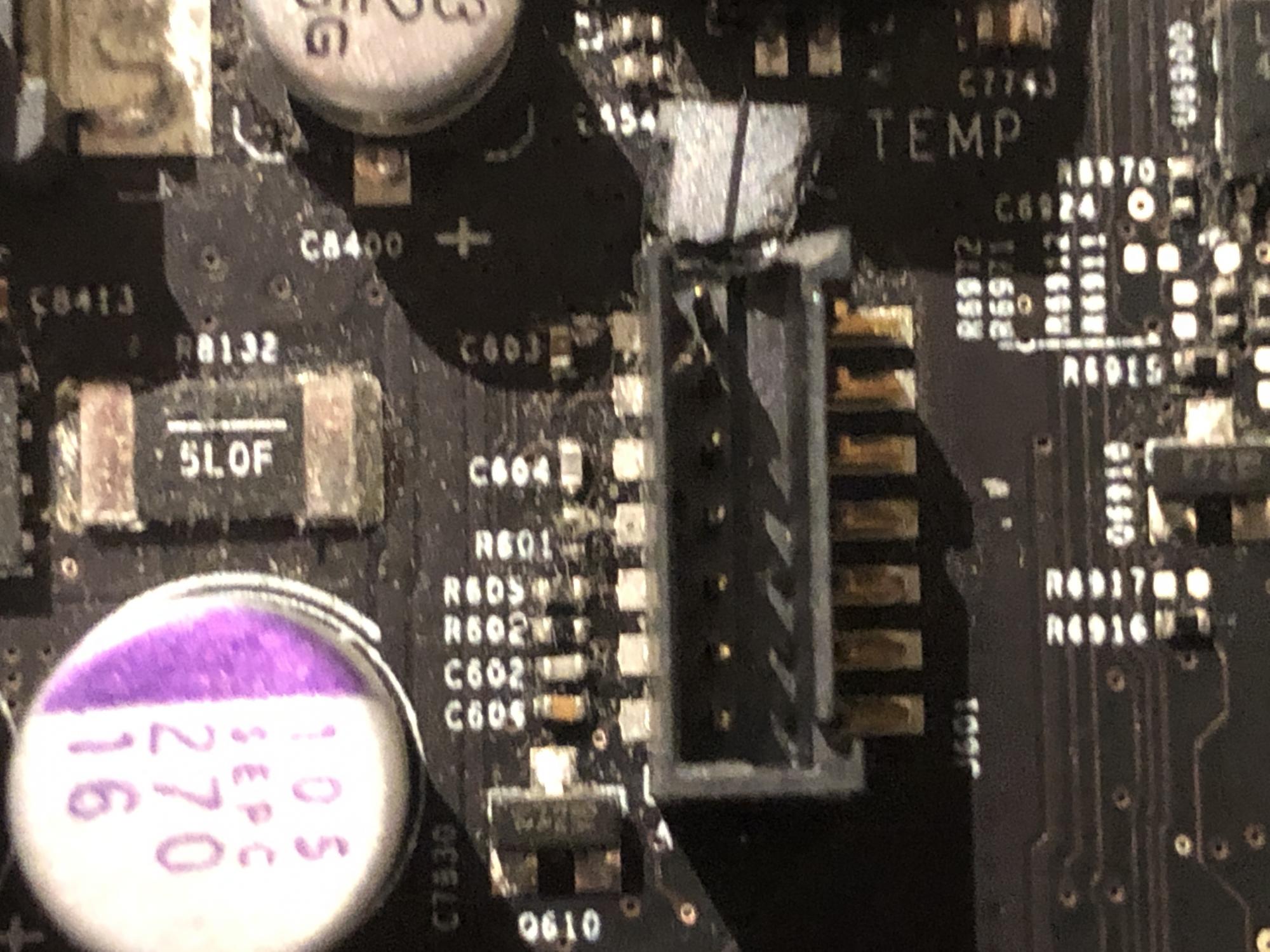

    Does anybody know what is the refernce of the connector J601 on the logicboard of an iMac mid 2011?
    Please check the picture.

  • gabik111
    ORD spotter
    • 142
    • USA / Poland
    Re: Need to know the reference of a connector [imac logicboard]
    Following schematic diagram is connected to PS. I think its return singnal and data lines from MLB to PS. Basically data line.
    1. PS ON
    2. SCL RC
    3. ISOLATED GND
    4. SDA RC
    5. GND
    6. BL Enable
    7. BL PWM

      Hi Gabik,
      Thanks for your answer.
      Actually what I am looking for is the connector's reference so I can replace it.
      To me, MOLEX PICO-SPOX seems to be alike, but I don't know.
      Any idea?

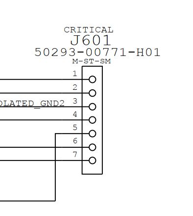

          • diif
            • Feb 2014
            • 6978
            • England
            Here you go.
            • pcardoso73
              • May 2020
              • 40
              • United Kingdom
              Thank you so much.
              I guess that that reference is an Apple one, so to match it to a Molex connector should be difficult, I guess.
