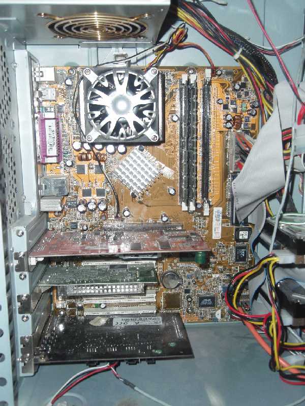

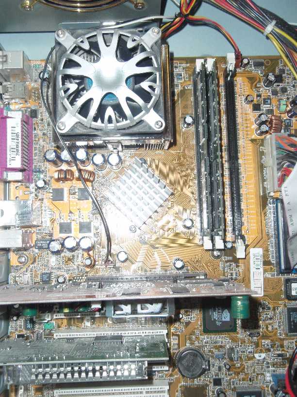

    Hello;
    I have looked around the forum here and have seen lots of the same issues with this mobo, but nothing like I'm now experincing.
    I have used this board for years now without any problems until now (around 6 years, before building a new system).
    It seems that now that I have made the computer this board is in my file server, it has started to freeze on me sometime after it sits idle. I have not done anything to it other than uninstall programs that I wouldn't be using on that PC anymore.
    I have not noticed any particular time frame when it freezes, as it has only just started to behave in this manor and I have only now started to research issues with this mobo.
    When I have used this system receintly (acutally sat down and used it), I have not had any reboot issues, and it seems to work fine for the time that I need to be on it, usually anywhere upto an hour.
    When it does freeze, the Hdd light is on as if the system is accessing the drive.
    I had noticed that I can order a recap kit for these Asus boards, but I notice that in the pic of the kit, there seems to be more capicitors on that board than my board has.
    My board only has 5 tall caps under the CPU and what looks like 3 of the same type above the AGP slot. There are an assortment of smaller caps scattered around as well (see attached pics).
    All capacitors appear in good condition and are not showing any signs of being blown or leaking any electrolite.
    Any Ideas?

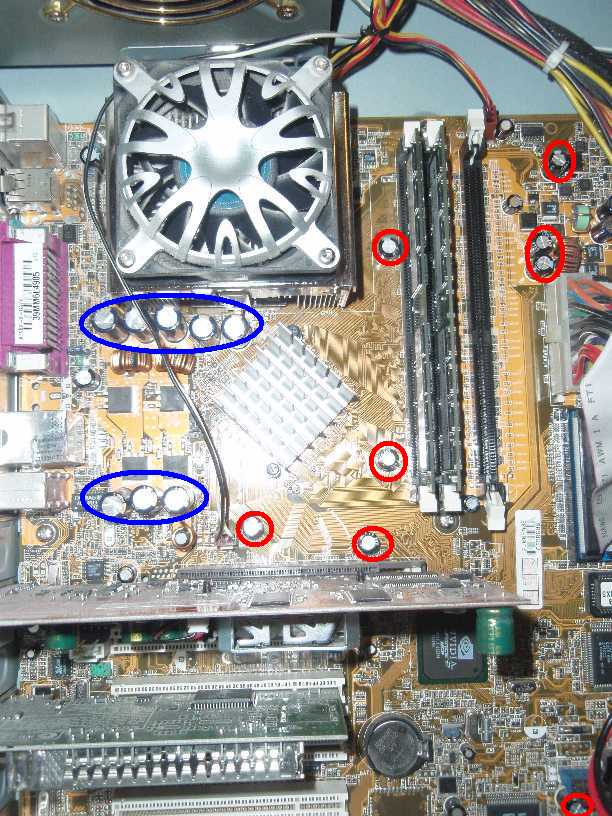

      I made no attempt to mark every cap, just a few so you know what to look at.
      Blue - Look like Rubycon and should be fine.
      Red - Look like Nichicon HM series which were defective from 2001-2004.
      Date codes are like H0344
      '03' = year 2003 and '44' = week 44.
      Year codes 01, 02, 03, 04 were bad and should be replaced.

        PCBONEZ, I'm pretty sure that the red ones are OST RLS series. I recently re-capped a similar board (A7V600-X) and that's what the small caps were.

          i have also seen the cpu detection issue.your vrm input and output look like rubycons.which means they are unlikely to be the problem.

            I agree that they are rubycon's, OST has never used the K vent.

                  OST will fail with no bloating.
                  - - Any brand -can- but OST seem to especially like that mode.
                  Date codes are only for Nichicon HN and HM series.
                  - - They made a mistake at the factory,,, for 4 years,,, OOPS!

                                    The board has always been good til about a week ago when it started to freeze up when the system would turn the display off.
                                    I did open up the PSU and everything there looked good there. The only place that I did see any glue was on the copper coil wraps around what I assume is a ferrite ring.

                                      . . . . . . . . . . . . . . . . . . . . . . . . Ripple / ESR
                                      6.3v 1000μf OST - RLP 8mm . . . . . 700 / 0.078
                                      6.3v 330μf GSC - ??? 6mm . . . . . . 340 / 0.022 . . [assuming LZ series]
                                      16v100μf OST - RMH 6mm . . . . . . 105 / n/a . . [Is a GP cap.]
                                      25v 10μf OST - RSM 4mm . . . . . . 23 / n/a . . [Is a GP cap.]
                                      I usually buy at digikey and out of what they usually stock:
                                      The RLP:
                                      Panasonic FC in 1000uF 6.3v doesn't have an 8mm but the FC 1000uF 8x20mm would work and be an upgrade for Ripple/ESR.
                                      Chemicon KY or Nichicon HE would be a better upgrade to the RLP.
                                      The GSC is 'better' grade than FC. [If I guessed the series right.]
                                      ... needs to at least be Chemicon KY or Nichicon HE [or better].
                                      Since the others aren't even Low ESR and Nichicon VZ would be good enough [I checked the numbers] but any basic Low ESR cap would be a good upgrade choice and the price difference isn't much. LXZ, LXY, FC, PW - all good.
                                      If you wanna buy somewhere else then just check the originals specs and keep:
                                      Ripple the same - or more.
                                      ESR the same - or less.
                                      Regarding the 6.3v 330μf GSC - ??? 6mm . . . . . . 340 / 0.022 . . [assuming LZ series]
                                      This looks like all the other OST caps, but there isn't the OST branding on it. In fact, there isn't any compnay brand on it.
                                      Here's all the info on the sleeve.
                                      GSC 105° T37C 330μf 6.3v
                                      If it helps, these 2 caps are very close to the RAM slots.
                                      All of the other caps are temp rated to 105°, I noticed in my searching that there are a varity of temp ratings and life hour ratings.
                                      PCBONEZ, not to say that I know what I'm looking for if I were to go out to my local electroncs supply shop and order up what I need, I'm sure that I could with the information that you have provided, but I wouldn't have the confidence that I was actually getting what I needed. My very limited knowledge of capicitors is evident here and if you could put together a package for me, I would feel more comfortable with that.
                                      If you did do this for me, I would like the caps in the mid-grade and better quality.
                                      I could send payment by paypal if that works for you. Just PM your info to me and we can get settled up with my address and such.

                                        GSC is not OST.
                                        OST is a -BRAND-.
                                        GSC is a different BRAND.
                                        GSC os one of the worst there is in fact.
                                        GCS is SO bad they started changing their name.
                                        GCS = Evercon = Sacon [ and possibly = Capsun ].
                                        GSC often don't mark the series on the caps so I went conservative and used their series with the best specs which is LZ.
                                        Use 105°C caps.
                                        On some boards you might see 85°C as original but choose 105°C caps to replace those too.
                                        If low ESR caps of higher temp ratings exist they are rare, for some unusual application, and probably very expensive.
                                        Your chance of finding low ESR caps at a general electronics store is between slim and none. If you make special orders the cost could easily be 5-10x what you should be paying.
                                        The larger ones you can buy here or you can go to Digikey, Mouser, Newark 1, or Farrell. [Probably a few others I'm not remembering right now.]
