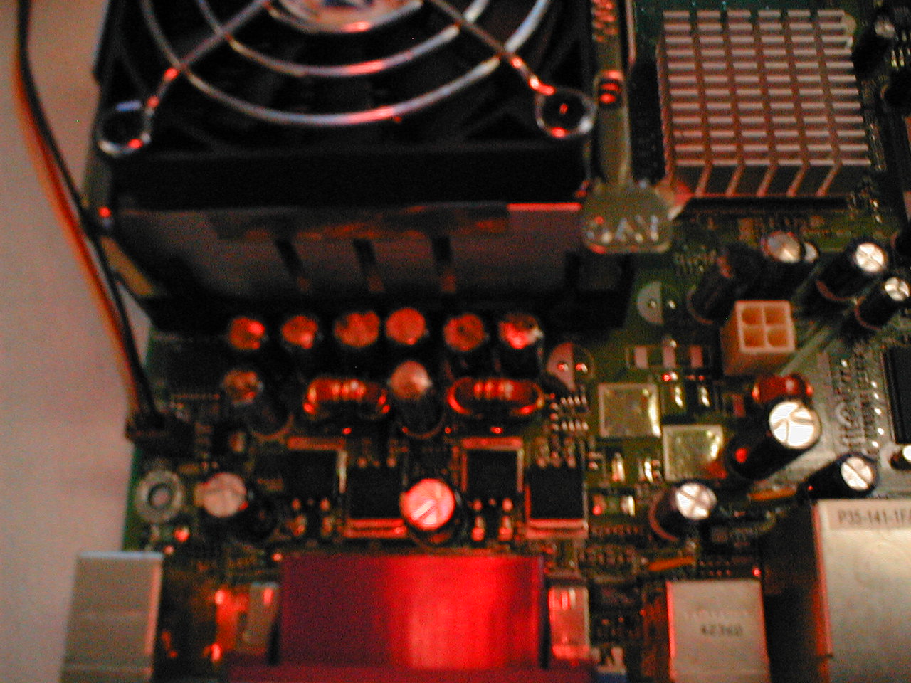

    E-machine T2040
    This one came into my shop yesterday.

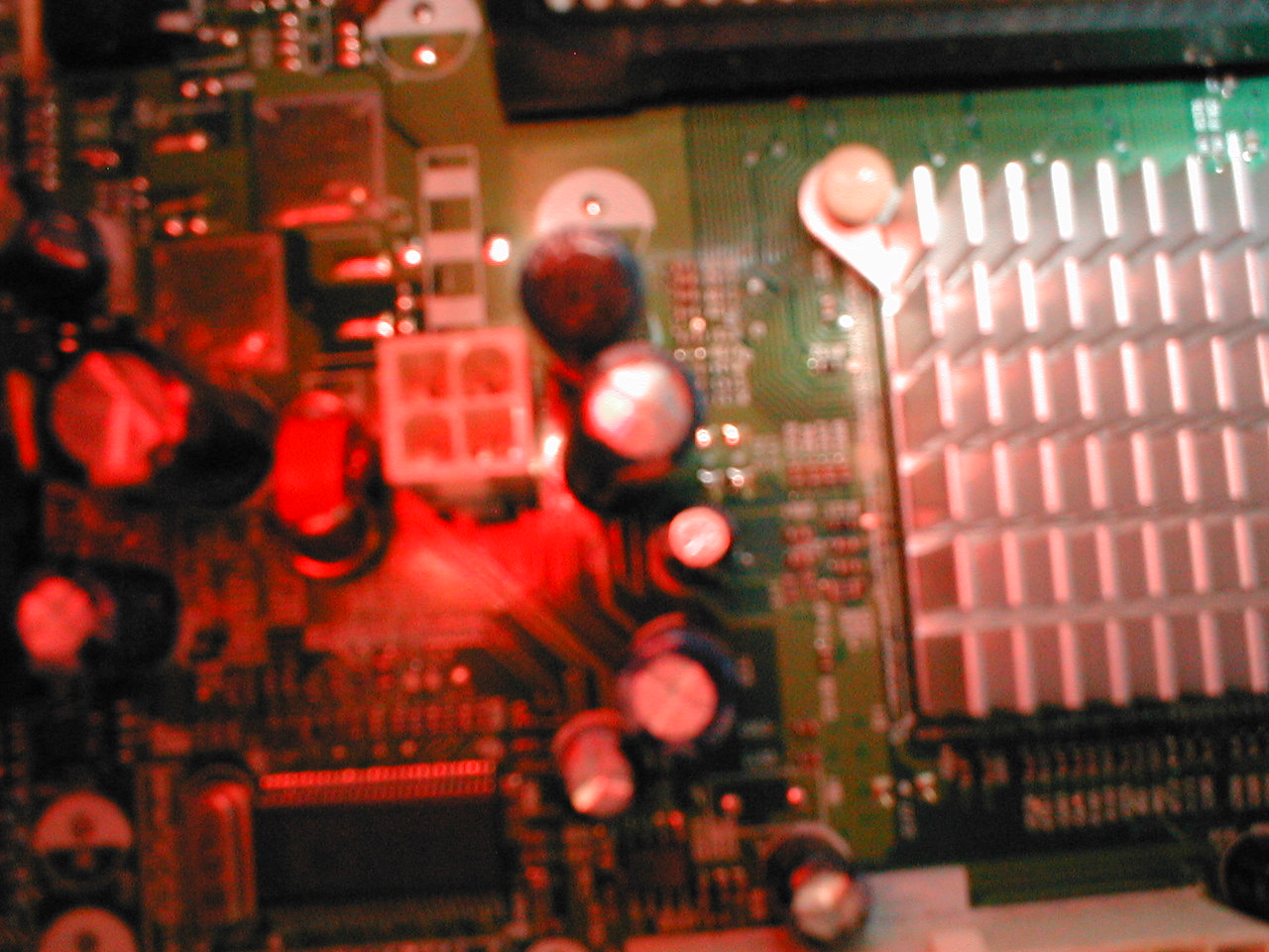

    board has the red plague as well as the capacitor plague.
    if you recap it recap the psu too or replace it.those often have the bestec "blow em up special"

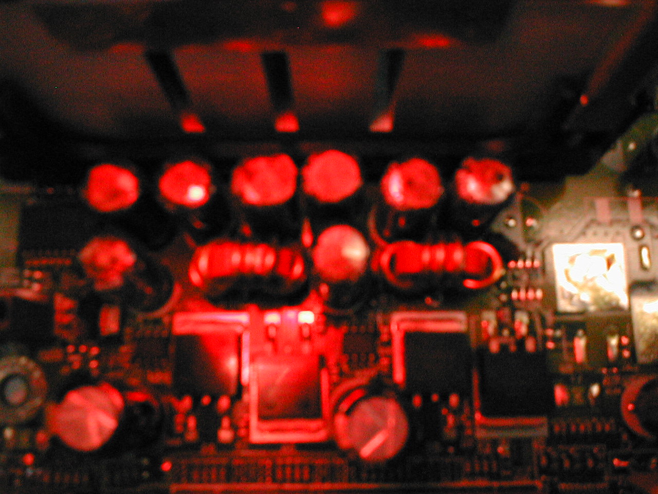

        Is that reddish color from your camera lighting/flash or is that something else?
        Looks like you have lots of bulging capacitors there. What kind of power supply does it have (brand and model number)? The power supply might be the deciding factor in whether or not you want to recap the mother board.

          That would be the Bestec ATX-250 rev 12E only. Other Bestecs don't usually have this problem.

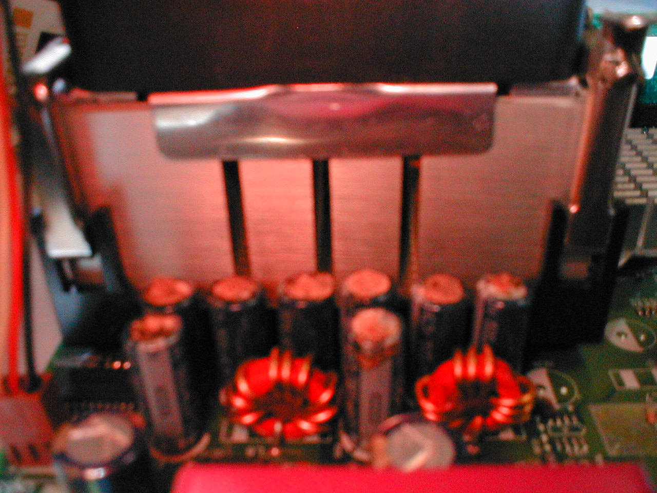

          By the way, what is the brand of the failed caps? Seems like TMS (a.k.a. Total Monkey Shit) but I can't tell from the photos.

            yes those are tms(too much shit)
            and that box is in the era of bestec bombs.

              PSU is Bestec ATX-250-12E. Tried recapping mobo, but the new solder would not take to the mobo. The computer was left out in the "barn" for a while.
              I trash the mobo. The CPU and ram seem to have survived the abuse. I will be checking the PSU today.
              The red is on the caps. Some type of corrosion, I believe.

                  You guessed right. TMS 105C 6.3v 1500uf
