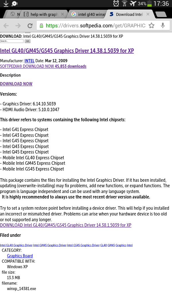

    I am trying to find graphics driver for old laptop eMachine G725, for winxp 32bit... from data on internet, https://gadgetaz.com/Laptop/eMachines_G725--1942 it will have Intel GMA 4500MHD graphics, so I downloaded a few of them but nothing work, error say: this computer does not meet the minimum requirements for installing the software. So, please somebody help me to find bare minimum graphics driver to see non deformed screen anymore...

        What you mean, I only look for winxp drivers... download from intel winxp_145111.exe, from some drivers site also a few, from archive.org also... but the same error. Needless to say, this winxp machine has to newer not be connected to internet, so I seek to standalone drivers, not a half products or "automatic driver detecton and spy installer...".

          Try this one
          http://cwcyrix.nsupdate.info/intel-l...14.42.15.5420/
          Unfortunately cannot find it on Intel website
          Download winxp144215.zip, try to run the setup
          If the setup.exe complains, manually install from device manager

            Thank you my friends, I just find it and it work in native 1600x900 on winxp sp2 32bit, plus brihtness control over keyboard... I just search for GL40 drivers and they contained video driver as well. https://drivers.softpedia.com/get/GR...9-for-XP.shtml I downloaded yours winxp144215.zip too, just in case but not tested. Thank you all!
