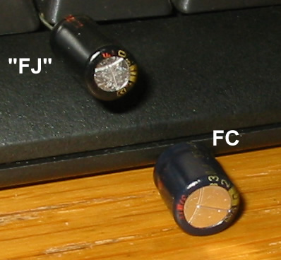

                I've got more FJs home. But on closer observation, the bottom bung is not the usual ones seen on Panasonic caps. There are no complex patterns on the bung, and the label on the cap looks very faint.
                Wonder it's a fake. The shop was selling other caps of odd brands never heard before too.

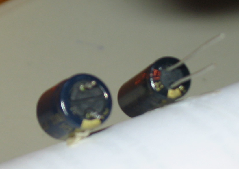

                  can you get a pic of the bottom bung? if it is not advanced shape then must be fake.....

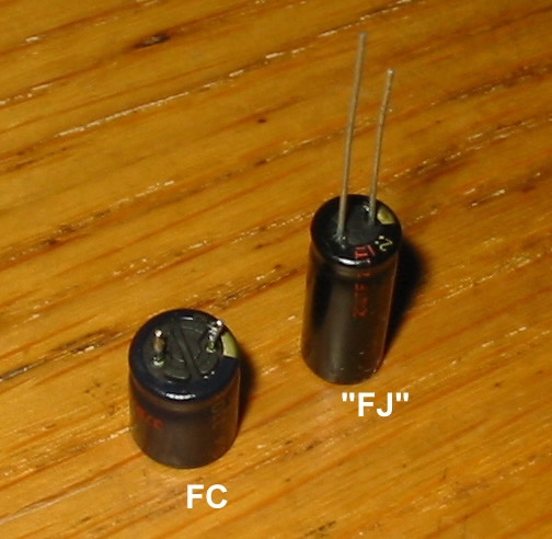

                    Yeah, pictures (apologise for blurness):
                    On the left is my leftover 330uf25v FC, right is the supposedly 2200uf6.3v FJ
                    Notice the faint prints on the FJ.

                      how bout a pic of the vent?

                        The vent is those T type found on Panasonic caps. But not as deeply cut in as compared to the legit ones.
                        Pic coming up in 12 hours time when I get back home.

                          More pictures:
                          Clearer bungs
                          What do you think??

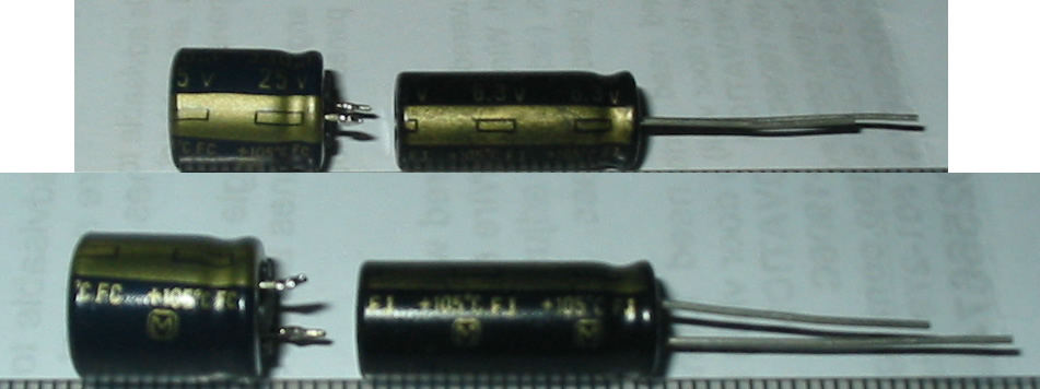

                            if they are fake they are pretty good. I havent seen 8mm panasonic caps so i cant say whether they normally have complex bung shape.
                            gonna have to unroll an FC and FJ to really compare. check also to see if the bung is same material as the FC when you do that.

                              Just secure them and cut with a penknife?

                                  to dissect the capacitor what i do is to first take the sleeve off with a knife then i slice the vents open carefully and using a small pair of scissors i carefully cut the capacitor to the bung and then cut around the bung a bit and then around the top of the capacitor in order to make an opening to take the internals out intact. then i make sure the leads are straight and pull the internals away from the bung so that the internals come out with the leads still attached. then the capacitor can be unrolled and examined.
                                  i dont know if it will tell anything but it is worth a try.

                                    The unrolling seems complicated without a proper clamp. I will take some time to do it...

                                        Just an update. I defied my own words, went down to the dirty job. The FC in the earlier photos was cut open, it's moist and greyish. Update on the "FJ" is coming in soon...
