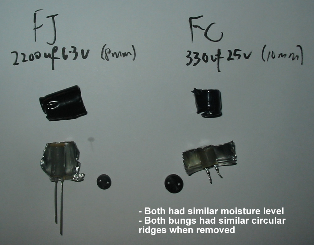

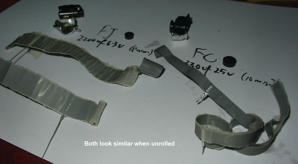

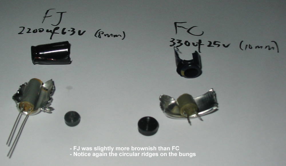

Looks like I can go ahead with recapping with this FJ, guys any opinion?

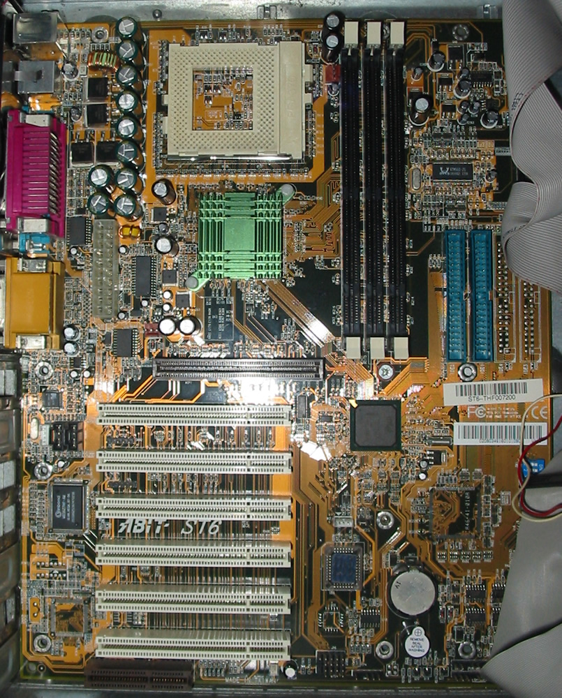

07-14-2005, 09:48 AM
Re: Rare Teapos on Abit ST6
Originally posted by
willawake
nice investigation BluBlur.
Thank you!
Here's a photo of the completed ST6.
Change log:
- 2200uf6.3v Teapo --> 2200uf6.3v Sanyo WX
- 1500uf6.3v Teapo --> 2200uf6.3v Panasonic FJ
