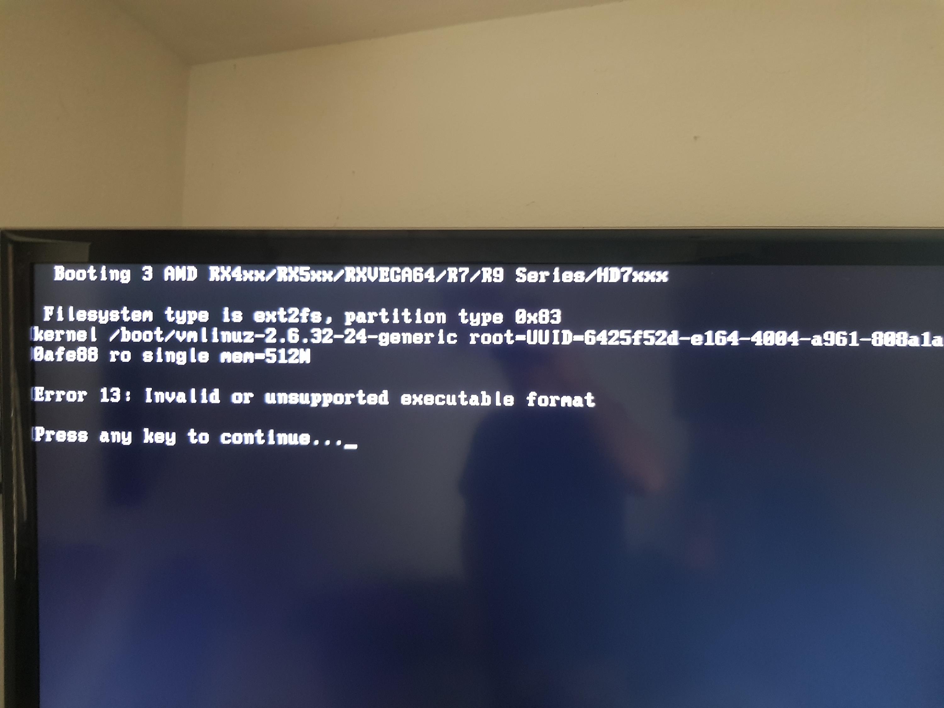

      #62
      Re: Software to analyze Video RAM faults on graphics cards?
      Originally posted by gabi200
      hello,
      after booting in legacy the menu appears,
      and when I want to test AMD rx4xx/rx5xx it gives me an error.
      error 13 invalid or unsupported executable format
      press any key to continue
      has anyone else encountered this problem?

          #64
          have the same problem with Error 13, I've repartitioned it several times, I've also tried overkill but always this annoying error 13 invalid or unsupported executable format
          What can I do I'm at my wits end I also have the latest bios on my M5A97 R2.0 mainboard

            #65
            https://anonfiles.com/Z0cak5a4y1/DiskGenius_rar
            I have the solution for the error 13 invalid or unsupported executable format
            The problem is that the new version of Diskgenius causes errors in the bootloader of the original files
            Simply recreate the PMF files with the linked version Boot to Legacy and the error is gone

                                • gabi200
                                  • Nov 2013
                                  • 19
                                  #76
                                  Originally posted by candan55
                                  im suffering for the same problem tried both kings_overkill's software and the new one but both are same. İ couldnt find anything on the net. motherboard gigabyte h61m s2pv cpu i3 3220
                                  Try an old version of disk genius, or same version from the video.
                                  i tryed and works

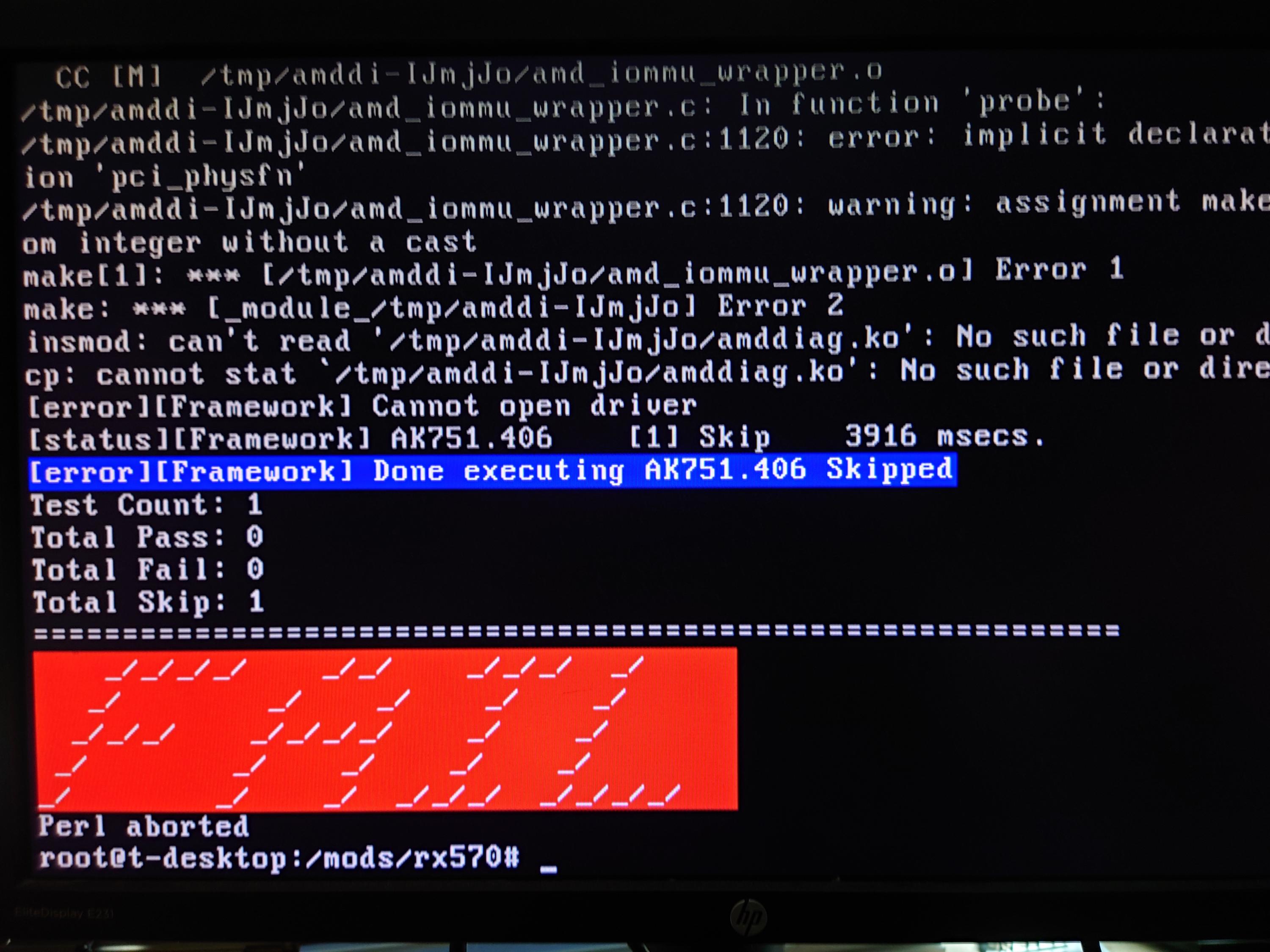

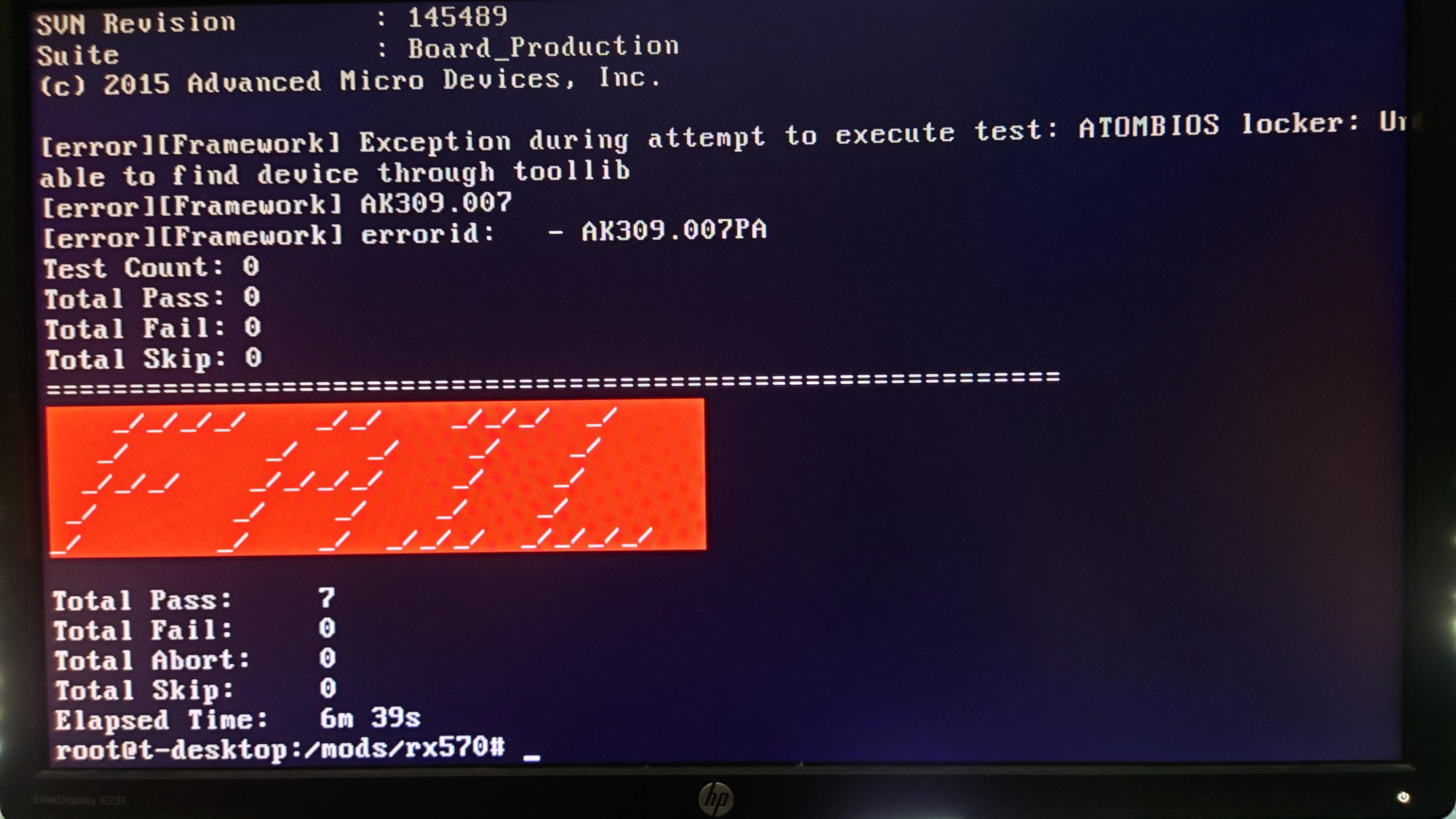

                                        I'm trying to figure out the cause for an error 43 on a Asrock Phantom gaming D Radeon RX570 8G.
                                        As far as i am able to tell the voltage rails seem to be functioning.
                                        The vbios has the correct md5 checksum. and has been reprogrammed from a known working card dump.
                                        The following tests have been executed, although some fail for reasons i can't guess.
                                        dmgg.py 256 8 ok
                                        tserver -boardtest=memfa ok
                                        tserver -boardtest=sitquick ok
                                        tserver -boardtest=mba error AK751.406 (implicit declaration of pci_physfn)
                                        tserver -boardtest=quickmfg error AK751.406 (implicit declaration of pci_physfn)
                                        tserver -boardtest=extmfg error AK309.007PA (atombios locker not found trough toollib)
                                        would anyone have a clue if these 2 errors would be related to the test suite or could these be hardware?
                                        • gsegpitd
                                          • 3
                                          • NL
                                          #80
                                          I have probably figured out myself.
                                          I had different disk images, one of them a HDClone image was missing the /mods/rx570 folder and the other, a 5 partition Disgenius version, which did have this folder produced the errors i was experiencing.
                                          I copied the /mods/* folders over and can now run the tests (almost) successfully (as my test system's bios doesn't support resizable BAR, the SAM test fails).
