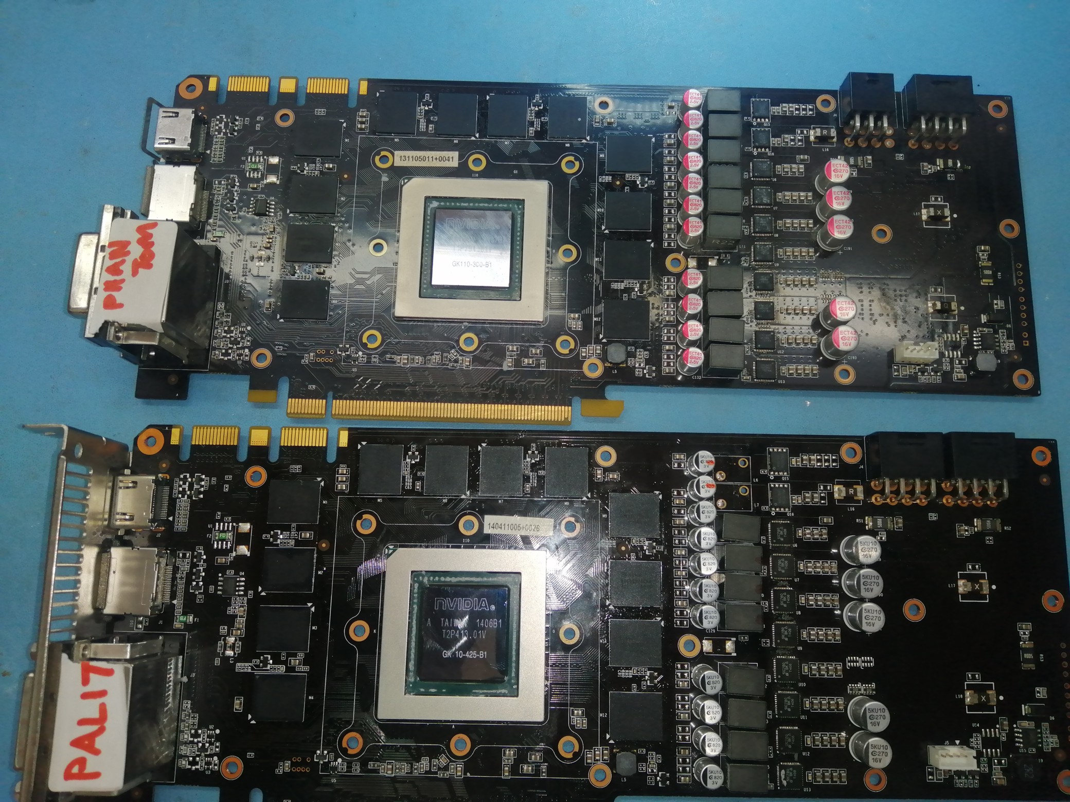

    Re: GTX 780tI Repair attempt...
    I had a quick look at the other two cards with my multimeter. One of them (I think it was the Gainward Phantom) looks to be very similar to the Palit card
    On this one both inductors/fuses? L17 and L18 read OK. I don't have any shorts on the electrolytics on the 12V side of the VRMs, and on the low voltage side I have 3R3 across all the capacitors that read 2R4 on the Palit. The other two capactors at the top of the card on the low voltage side that read 0R on the Palit read about 110R on this card. from this I am pretty sure there are two Voltage rails generated by the VRMs, with more phases on the one that read 2R4. Which makes sense.
    The other one seems to be quite different in its layout and components. On this one I don't see any shorts on the electrolytics on the 12V side of the VRMs but I read near to 0 ohms on all the low voltage side electrolytics.
    Comparing all these facts, possibly the Palit has two separate faults - a short circuit MLCC or Mosfet or similar on the one of the 12V rails, and a short circuit capacitor or load on what may be the Vram supply?
    The Phantom reads no shorts anywhere. This may be the one that detects in the BIOS but does not give any video. It may help me to determine what voltages should be present on the other ones.
    The Gigabyte (I think it was) may have short circuit capacitors or VRMs, or both GPU and RAM short- this just seems to be short everywhere on both the low voltage rails.
    Still if anyone has more experience (and that would not be difficult as I have zero on GPUs) I hope you can advise me.

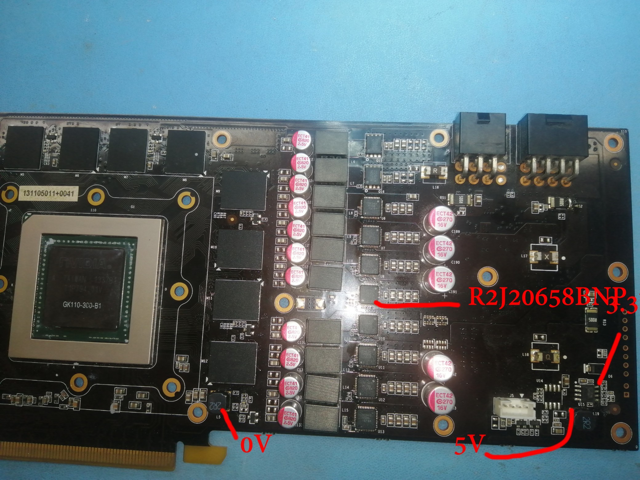

            • dicky96
              Sun Seeker
              • Mar 2017
              • 1825
              • Spain
              While I am waiting see if anyone has any ideas how to proceed with the Palit I decided to have a proper look at the Phantom. AS I mentioned this one has no shorts that I have found, it has 12V supply but has no Vcore or Vram
              What I found is, the Vore has 8 phases and each phase is driven by a Renesas 20658BN
              On mine I have a circuit like the one in the datasheet '(2) VCIN 5V application' on page 7.
              I have 12V and 5V supply but no PWM input.
              Similarly I have no PWM drive to the gates of the two dual Mosfets that drive Vram
              I traced the Vcore PWM to a NCP4208 8-phase synchronous buck converter
              Here I found pin 1 (VCC3) has 3.3 - this is an internally generated power supply output, so I know the chip must have VCC power input, and is probably OK, but EN (pin 6) and PWRGD (pin 2) are low - so it is disabled.
              Now I had a bit of a think.... it would seem logical that this chip is enabled by some sort of processor or microcontroller when certain conditions are present. Also this chip has VOD0-VID7 inputs to set the Vocre. So something must control it.
              So I looked around the board and I could see there are two small inductors which means I must have two other power supply rails. One of these was giving 5V, the BIOS chip has 3.3V on pin 8 which looks sensible and suggest another regulator is working somewhere, but the other inductor has 0V on it. There is no short on this rail.
              I looked on the other side of the PCB to see what drives that one and this is when I found someone has been messing!!
              This is evidentally someone with some reasonable amount of knowledge of what they are doing but with very little evidence of good soldering skills.
              I found a few chips that I can't identify, so I don't know if one of them is a micro-controller - but I suspect the inductor with the 0V on it acts like some sort of standby or startup circuit and probably powers part of the GPU, which then in turn sets the VID0-7 on the NCP4208 to some default value, sets EN high and starts up the Vcore and Vram.
              At least I can imagine it is supposed to work like that and of course without the standby or startup supply present - nothing happens. So I need to figure out what is wrong with that circuit, and also clean up the other guys mess, but problem is I can't find a datasheet. What I am sure is the controller IC is marked 3A F2 F2G or 3A F2 F26
              Please see the attached pics. That will help. Does anyone recognise that chip?

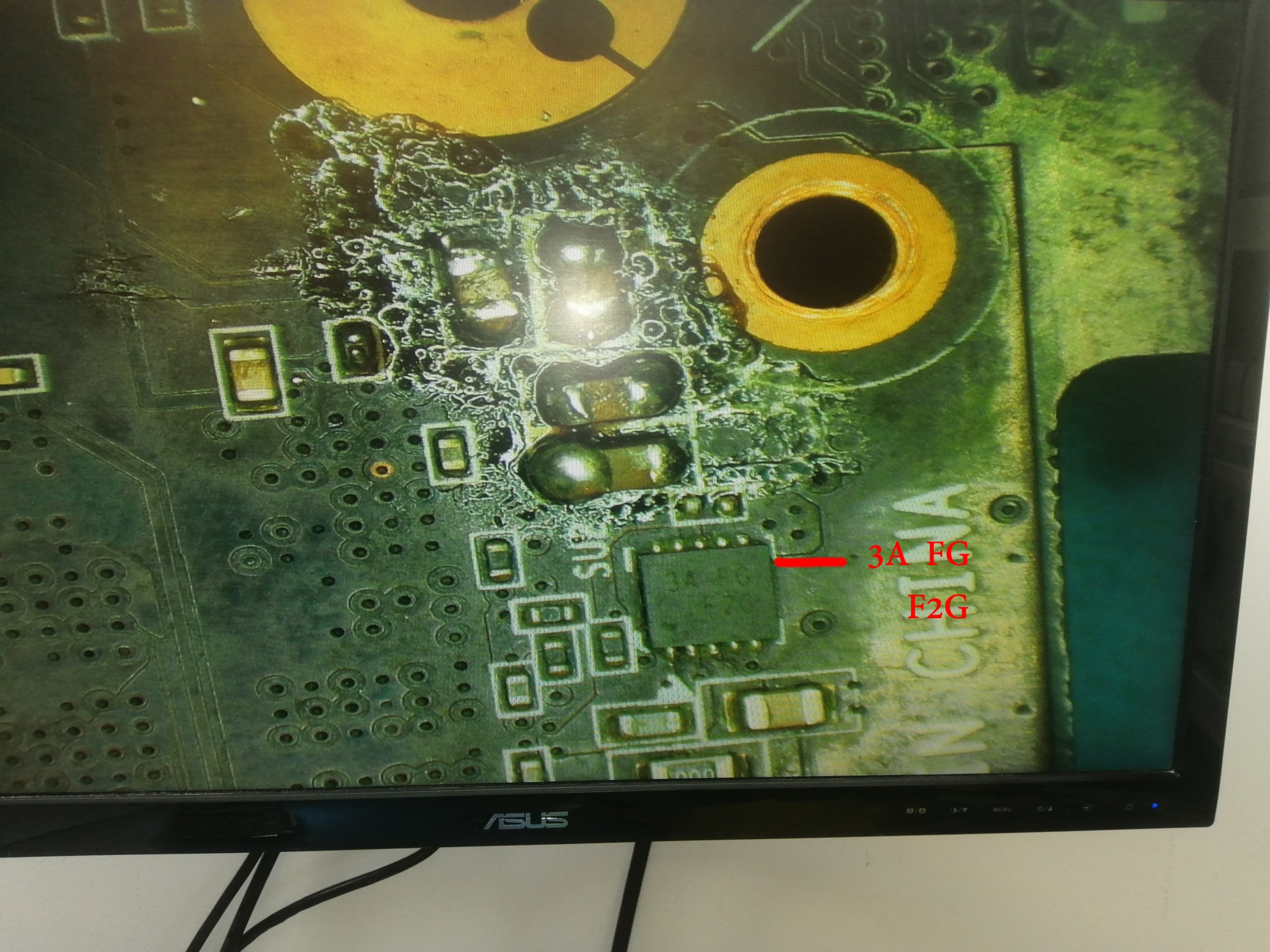

                • 21512
                The part marked 3A could be a Richtek rt8071azqw
                https://www.eevblog.com/forum/repair...-component-id/
                • dicky96
                  Sun Seeker
                  • Mar 2017
                  • 1825
                  • Spain
                  The one on the Palit is marked 3A FM L1G which makes sense
                  Yes it probably is that RT8071chip - it has 5V input on pins 2 & 3 which is correct. However pin 10, which would be EN, is low - so it isn't going to start.
                  https://www.richtek.com/Home/Product...web&sc_lang=en
                  So the question would be, where does the enable for this chip?

                  • ChaosLegionnaire
                    HC Overclocker
                    • Jul 2012
                    • 3264
                    • Singapore
                    yes u may have already realized this but yes, palit and gainward both use the same oem basically. palit, gainward, xpertvision and manli all use the same oem for their stuff so amongst the same model of video cards, these brands are all the same thing.
                    so u can use this to compare and know what is working and not by examining the other card. momaka said its always good to get two of the same non-working cards so u can compare what it should be like when its working and not. that is very useful to figure out and reverse engineer the cards and get them working again. hope this helps u.

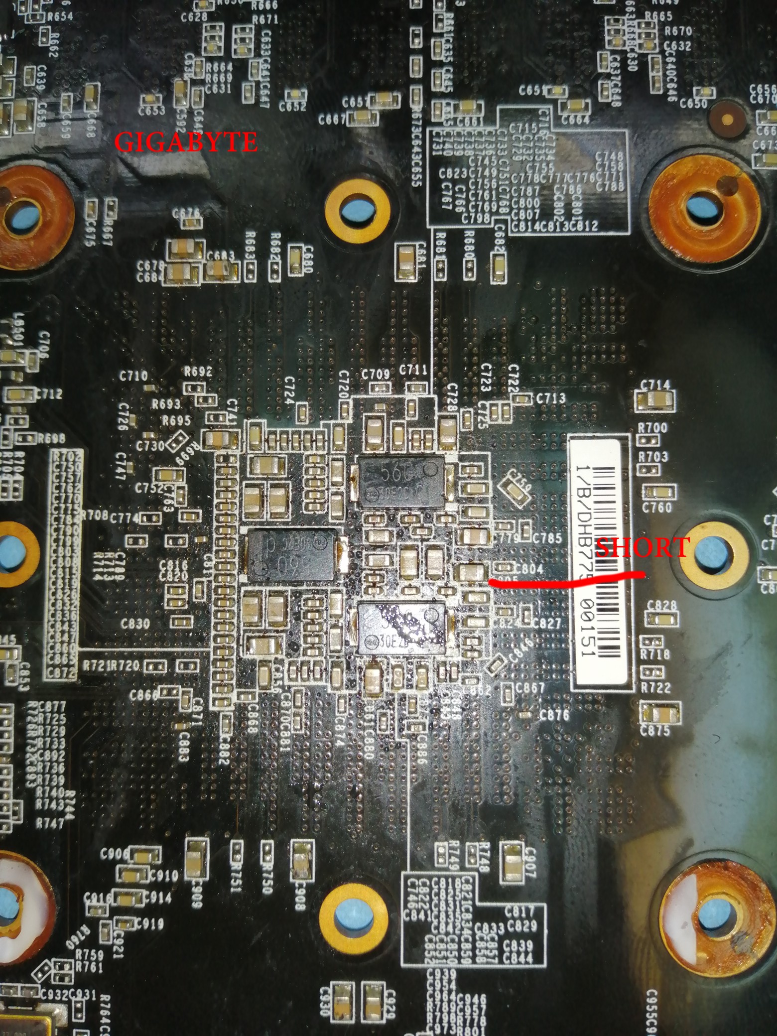

                      • dicky96
                        Sun Seeker
                        • Mar 2017
                        • 1825
                        • Spain
                        I'm getting deeper into this lol, I do hope this is entertaining some of you, at least.
                        I was trying to find how the GTX780 starts up, what enables the Vcore and Vram and that other supply rail I found
                        I had a good look around the PCB and found a little SOT23-5 chip near the PCIe connector which I assume is a LDO or something like that. It connects to VCC3 on Pin 7 of the PCIe connector.
                        I don't know what that is, it is marked VE and on the Gigabyte it is B8GO. I thought it may be this one
                        https://pdf1.alldatasheet.com/datash...P130K161D.html
                        which is available as a SOT23-5 but the pinout is wrong. On mine Pins 1 & 5 are connected together (I can see the PCB track with the chip removed), and pin 3 is ground, not pin 2.
                        On the Phantom board, this chip had a short circuit from Pin 1 and 5 to ground. On the Palit this reads 700 ohms.
                        I checked all the capacitors in that area (some of the caps in the areas circled in red on the pics read short) and any I could find that had a short, I removed and tested again - but the short is not caused by one of the caps, or the LDO which I also removed (unless I missed a cap somewhere)
                        I started thinking that this supply probably goes to the GPU. So I removed the GPU from the Gigabyte 780ti, which has a Vcore short - and yes the VCC3 supply from pin 7 PCIe does go to the GPU. So I think I found my 'startup' supply rail.
                        It looks on the Phantom I have a GPU that reads OK resistance on Vcore (and Vram resistance is good too) but has a short on the PCIe VCC3 supply, unless as I say I missed some capacitor or VCC3 goes somewhere else which has short. I guess the next thing to do is remove that GPU from the Phantom and see if the short goes away.
                        Now, very interesting, on the Gigabyte I still have a short on Vcore with the GPU removed! That came as a surprise!!
                        There is no short on the 12V side of the VRMs just on the Vcore side. Short circuit capacitor? None of them look distressed. But it obviously is not a shorted GPU
                        I think I may need to order a GK110-435-B1 stencil because it is possible the Gigabyte GPU is good......

                            GIGABYTE GTX 780ti...
                            I then did a google and found these GPU should take up to 1.2V. So I used my bench supply to send 1.2V into the short - actually I had to use my voltmeter to monitor the voltage at the point I soldered the wires to Vcore supply and turn my PSU up to 2.1V to get 1.2V on the board due to the resistance of my leads. I then had about 1 amp flowing and found a very hot MLCC on the opposite side of the board under where the GPU would fit! Remove that and hey presto the Vcore short has gone!
                            Nice work there!
                            That Gigabyte indeed sounds like the most promising card right now to be working again... granted the procedure with soldering back the GPU goes well.
                            Maybe I didn't need to remove the GPU at all but I am not sure I would have found the two short MLCC caps without doing that.
                            No, unfortunately, you would NOT have found the short if you didn't remove the GPU. Reason why is because the GPU chip has very low resistance. Trying to feed any voltage on the GPU V_core rail with the GPU still in there would have made the GPU suck up all the power - more than your bench supply can provide, anyways. Thus, you wouldn't have been able to get a high enough voltage to detect which MLCC is shorted/bad.
                            So you did the right thigh with removing the GPU. It's just... a lot of work for finding a short. :\ But that's just the way it is.

                                    GIGABYTE
                                    The Gigabyte 780ti I have on one side - waiting a stencil for the GPU and some capacitors. Guess they will take a while to arrive here.
                                    PHANTOM
                                    The Phantom GTX 780 I've had something of a result. Despite spending a couple of hours on this, I just could not find why I have 25 ohms (was 47 ohms but it changed for some reason) between pin 7 of PCIe (VCC3) and the voltage rail it should supply on the graphics card. I have a direct connection from PCIi pin 7 to one capacitor on the graphics card but to everywhere else I can see it goes, I have 25 ohms.
                                    As hard as I looked I can't find a resistor or similar that accounts for the resistance. My best guess is a faulty via causing some resistance???
                                    So I decided to cobble it. I soldered a wire from the MLCC which was connecting to pin 7 PCIe and soldered the other end to another capacitor on the 3.3V voltage rail on the graphics card - thus 'bypassing' (or shorting out) the 25 ohms.
                                    I then powered up the card and could tell straight away (because the GPU now warmed up) that I have Vcore!! But the graphics card was still not detecting I was getting the usual beeep bip bip bip same as before That was enough for yesterday.
                                    Anyway it occurred to me later that really by now I should be getting a picture but maybe the old MSI motherboard I was using as a test rig (MS-7293 which came out of an old Fujitsu tower server PC) was not compatible with the graphics card - like the BIOS couldn't detect it or something. This despite the same test motherboard working OK with a Geforce 7600GS I have.
                                    The reason for this thought is because I have had problems in the past with machines like Dell and HP not detecting some graphics card when you fit them.
                                    I had used that motherboard because I had it lying around and it does not have onboard graphics. So anyway I got another old board I have that also has no onboard graphics, an Asus P5B Deluxe.
                                    I put the Phantom in that - and it detects!!! BUT..... although I now have Vcore (0.94V) and Vram (1.5V) and I get a picture - there are little white dashed lines on it See attached pics.
                                    Only thing I am thinking now is maybe the six little SMDs on the rear behind the GPU that were missing and/or someone had bodged up with solder (see pic) are actually necessary and causing the messed up video output. I could take these from the Palit and see what the parts should be.
                                    Or maybe the GPU or RAM are screwed up and I am
                                    Palit GTX780ti
                                    I tried with this one on the Asus P5B a swell. It still does not detect. I have Vcore 0.87V. I currently have no Vram as the inductors and the short circuit FET are removed. I believe a GTX780ti card should still detect and you should get a picture of sorts if the GPU is active but there is no RAM fitted on the card. Is that correct?
                                    I think the next thing on this one is to remove either the GPU, RAM or both to try find the short on Vram. Vcore resistance reads OK.

                                      A little more on the Palit.
                                      I tried pushing 1.5V into Vram on the Palit using my bench supply, seeing as that is the Vram voltage I can read on the kinda working Phantom. I had it sitting at a steady 3 Amps for several minutes but nothing gets warm.
                                      I want to try removing the Vram chips next. There are 12 of them. I can either use my semi auto BGA station but would require numerous heat cycles but at least it is a controller profile (I can put a small upper heat nozzle over each RAM chip in turn). Or I could do it manually with my KADA 853B preheater under each RAM chip and my Quick 861DW. I have a manual vacuum pick up tool also, Aoyue 932.
                                      Recommendations?
                                      I've never tried this before apart from stripping parts from old boards where i don't really care about the board.
                                      Rich
