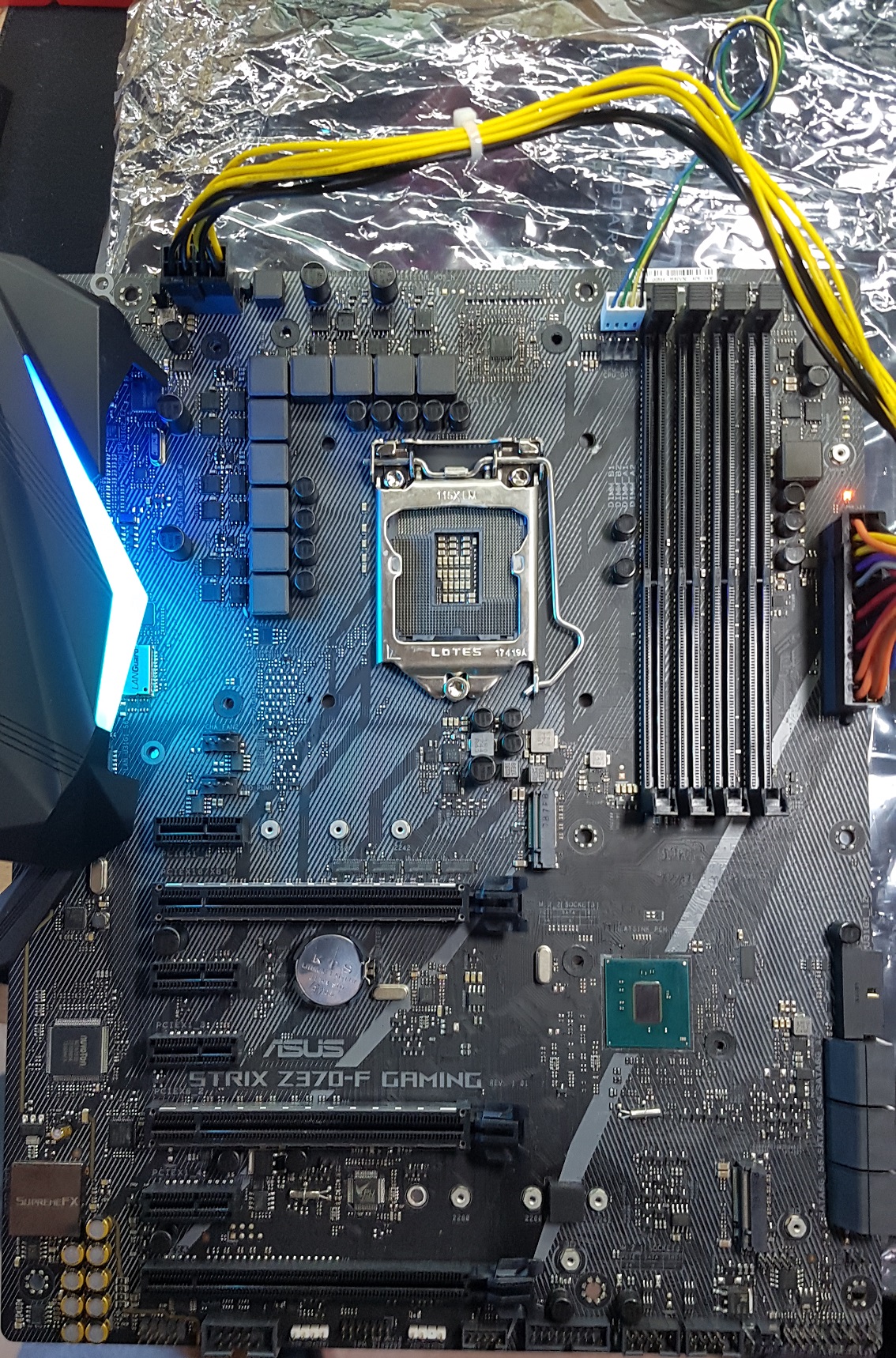

    Hi guys,
    I've got this nice mobo with some CPU bent pins.
    Made it to put them back to their position, but one of them was too twisted and broke down.
    Anyways none of them are shorting together now.
    I had a i3-8100, a DDR4 2400mhz 8GB stick and a power supply, so gave it a try. Power led of the mobo is orange, but when shorting PWR pins, no joy
    Made some quick random measurements, 3.3V is present in the PWR button pins, I can see 5V also present.
    Measured around SIO chip and 3v are present in some caps.
    Im not sure if board should start even without CPU and ram connected, but I gave it a try and also no joy.
    For those who could have more experience with these mobos, do you consider this a waste of time and just keep it for parts?

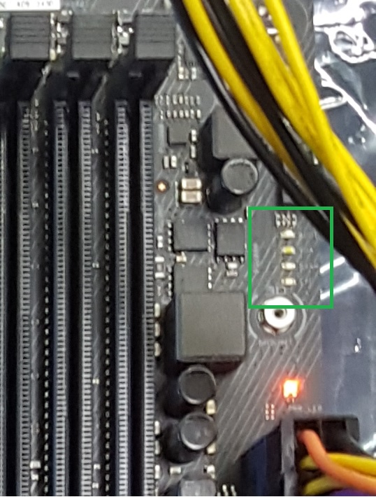

    The ROG leds also turn on when power is connected as you can see on the pics.
    Also Ive marked the bent pins zone, and in smaller red circle the broken pin.
    Power led is orange, and the 4 leds in green rectangle (boot,cpu,ram,gpu) dont turn on at all in any moment.
    Garbage?
    Or should I try something else?
    Thanks guys!

          Re: Asus Z370-F Strix Gaming - Bent pins - Not powering up
          I see this question asked way too many times: can a motherboard be tested without a CPU?
          - NO
          Testing a motherboard without CPU and RAM is absolutely pointless - it will tell you nothing about the working condition (or lack thereof) of the motherboard. Always install CPU (with heatsink/cooler!) and RAM as a minimum. Graphics card too if no integrated video.
              I would say testing without RAM is useful too: the board should produce a beep code to say there is no RAM installed.
              While having bad/wrong type of RAM can make the board unable to produce that beep code.
