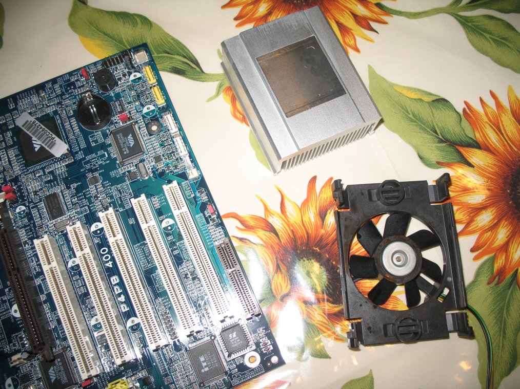

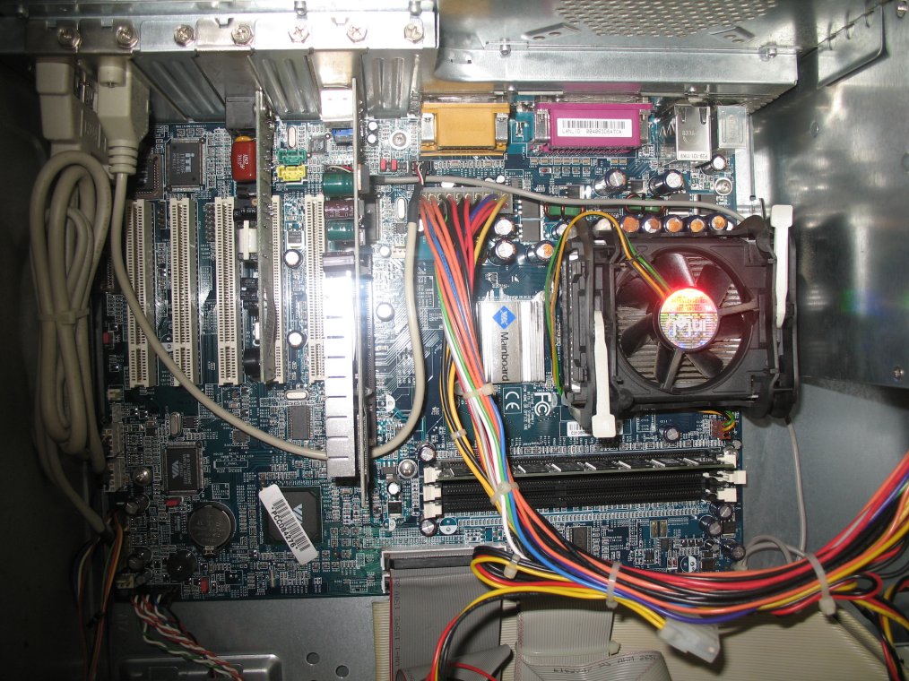

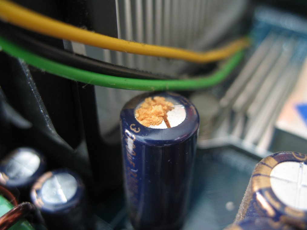

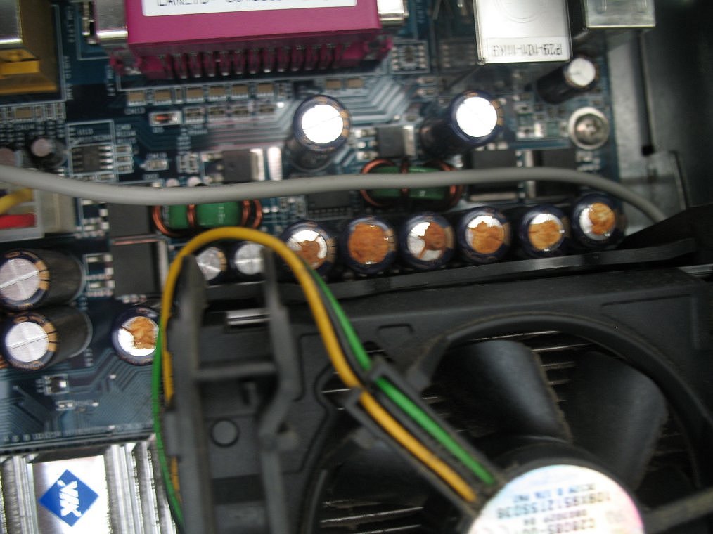

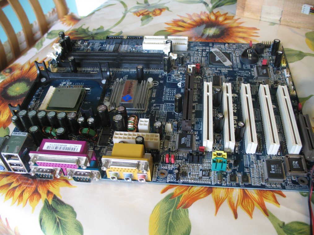

    Yesterday a next door neighbour asked me if I can reinstall the OS on a used PC he received.
    I answered "Yes... no problem... but... wait a minute and let me look inside.... .... oh my God... what a mess"
    Well another P4PB400 with c(r)ap all around .
    I hope this time I can win my battle because last year I lost time and trashed the MOBO .
    Before I proceed I have some doubts:
    1) the caps have different values respect to the board I saw last year and I can't find the exact value and size.
    Is it OK to use Panasonic FM 1200uF 16V (dia. 10mm) instead of 1500uF 6.3V GSC?
    If I have to order 1500uF from RS Italy, I have to wait till 15 June when Nichicon HE will be available. From what I see in datasheet Panasonic 1200 is better than Nichicon 1500.
    I know that usually it is better to increase size... but I don't want to wait so long.

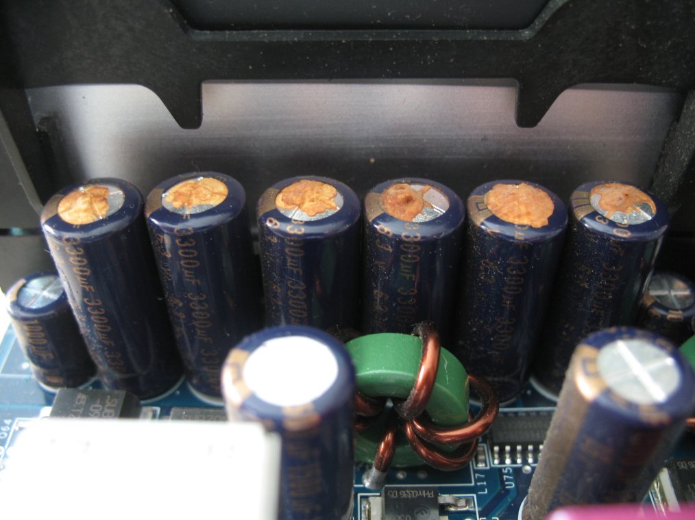

    2) Is it OK to use Panasonic FK 3300uF 6.3V instead of CSG on the VRM? I know they are lower grade respect FM but I need them with dia. 10mm and FM is 12.5mm.

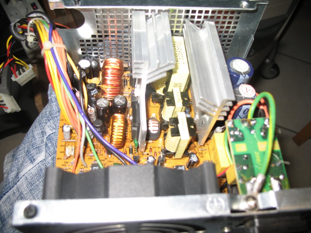

    The CPU on this MOBO is P4 2.8GHz Northwood, the PSU is a Deer full of Canicon and Asiacon they look OK but I will replace them with Panny FM-FC-FK, depends on their value/size and RS Italy.
    I was completely astonished when I saw this PC starting and running even if all the VRM caps are blown.
    Tia

    Just trash that psu. Even a recapped deer is not safe.

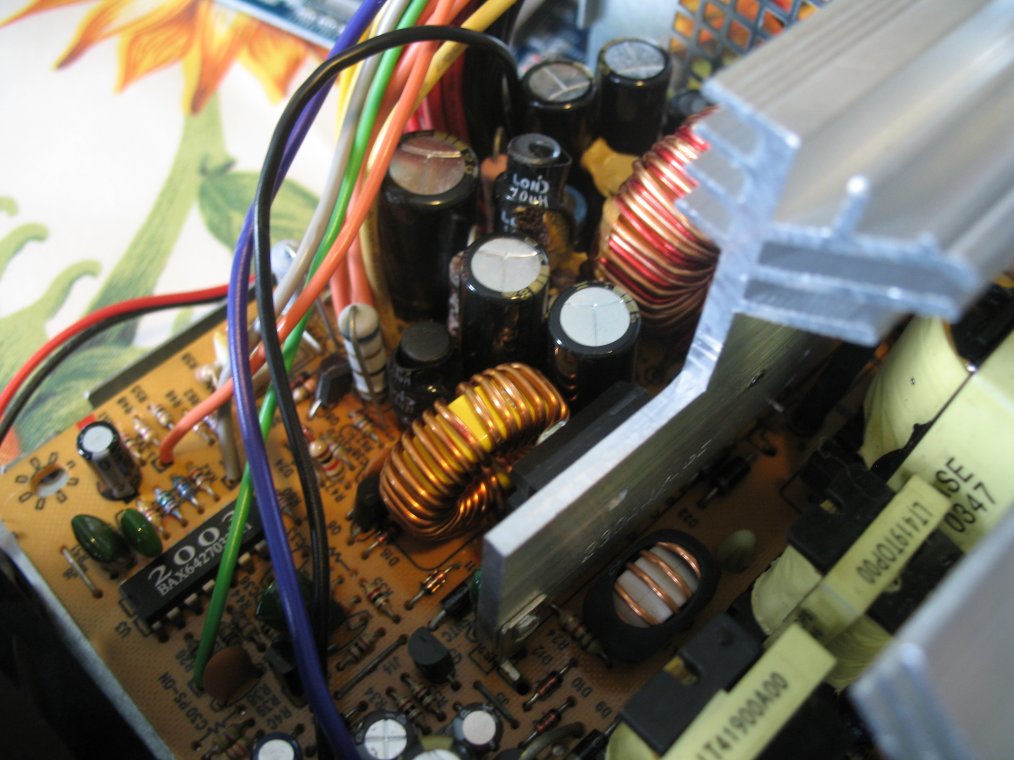

            The Deer PSU may be ok for a low-powered PII/PIII (though, even that depends on how well the Deer is built), but it certainly shouldn't be ran in a Pentium 4 machine as P4s pull power from 12v. Problem is, Deer/L&C/Allied are built to output more voltage on 5v rail, hence they often have weak filtering on the 12v, which may kill even the new caps on the motherboard.

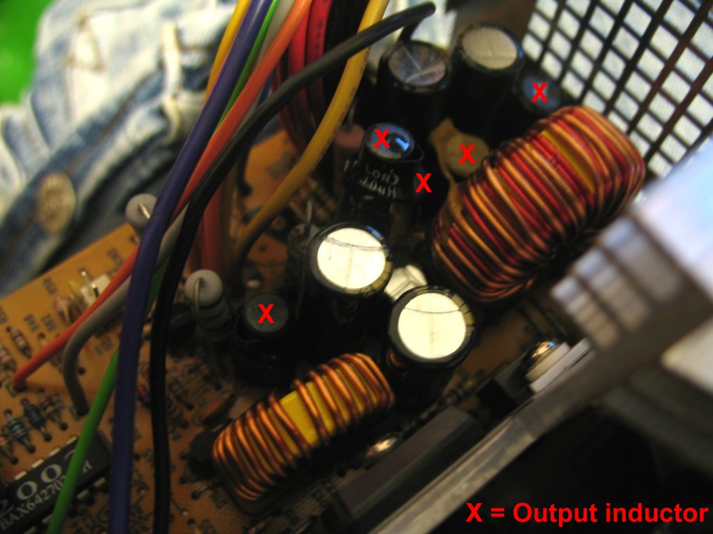

            If you must use that Deer PSU, at least make sure it has all the output PI filters (especially the 12v one), if not add them if you have any spare ones from other PSUs that you might have. Also, make sure to add caps on output in spots that might be missing any. Change the one 50v, 47uF / 25v, 47uF cap if it's from a bad brand since that's a critical cap to the PSU. Add X/Y caps and input coils if PSU is lacking them and you have some spare ones.
            ... Though I still strongly recommend to get a different PSU, like everyone else here said. That 2.8GHz Northwood probably eats more power than that Deer should handle.
            As for the motherboard, I don't really know if FM is a proper replacement for those GSCs (they are ME series, aren't they?). Nonetheless if it's working with those blown GSCs, chances are it will work with the FMs as well. The FKs might also work, but I'm not too sure. Hopefully someone with more experience than me can aswer that.

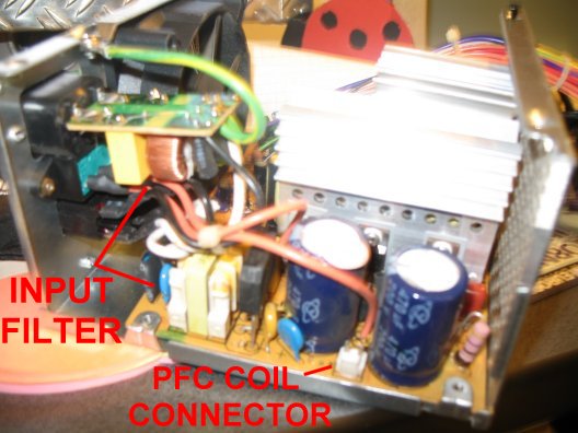

              the DEER PSU even if is not the best, it is complete: it has 2 input filter and all PI filters. It has also passive PFC, ok it is not very important but it is better than nothing.
              You can see some pics here.
              I agree with all of you it should be trashed but... it has been inside this PC for at least 4 year and there are not signs of problem. The VRM caps are blown because are crap, in the MOBO I saw last year the PSU was a Seasonic, good PSU, but the caps were all ruined just like this one; so I think all depends on this GSC crap caps.
              Anyway I have replaced most caps and I need some to complete it, in the picture you can see the top of caps have the Panasonic vent.

                In the second picture of the Deer PSU, there's an empty spot for an extra capacitor on the output. See which rail it is on and add it in (especially if it's on the 12v rail). Otherwise that Deer doesn't look too bad at all. Definetly one of their better units.
                About the motherboard - I doubt that Nichicon HE will work. Maybe use a combination of Panasonic FK/FM instead (FK to boost uF and FM to handle ripple). This is only an idea though, and I'm not sure if it will work (maybe it will if the FMs have much better ESR than the GSCs).
                You can slightly drop uF value if and only if ESR on the new caps are lower than the old ones. Such case can be seen when polymers are used in place of electrolytic caps.

                  about DEER you are right, the empty spot is there because I have to buy some caps, actually I wrote in the previous post "Anyway I have replaced most caps and I need some to complete it....".
                  About your suggestion I really don't know if it is a good solution: if you have 7 caps in parallel and 3 o 4 have lower ESR, those caps will work more than the others because the current is higher (I=V/R).
                  OTOH it will help to find a compromise about ESR and total capacity.
                  Here are the specs of the caps:
                  GSC LE 3300uF 6.3V 2250 mA 17mOhm 10 X 25 mm
                  Pana FK 3300uF 6.3V 2140 mA 25mOhm 10 X 30 mm
                  Pana FM 2200uF 6.3V 2470mA 18mOhm 10 X 25 mm
                  With FK the total capacity will be the same but ESR will be 50% higher and current a little bit lower; with FM the capacity will be 30% lower but ESR will be very close with higher current capability.
                  What I have seen till now is that ESR is the most important parameter to choose replacement so FM should do the job.

                    ESR is more important in the VRM than uF.

                      So PCBONEZ I have chosen the right replacement (FM 2200uF 6.3V)?

                        Yes, of those options you gave the FM is best.

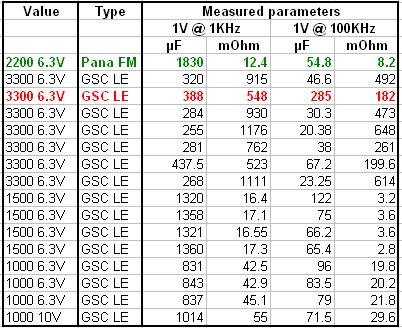

                          Yesterday I removed the caps around CPU and today I have checked them with a LCR meter.
                          Here you can find the table with results, I have checked also one Panasonic FM 2200uF 6.3V.
                          The leaking caps (3300uF 6.3V) are completely out of spec; one gave strange results at 100KHz.
                          The others (1500/1000) had still decent values.

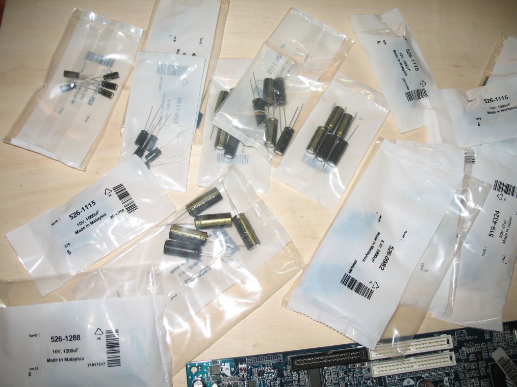

                          By the way, all Panasonic FM caps I received from RS come from Malaysia while Nichicon PS and Nippon Chemi-Con LXY come from Japan.
                          I will be back with some pics of the board during and after recap.

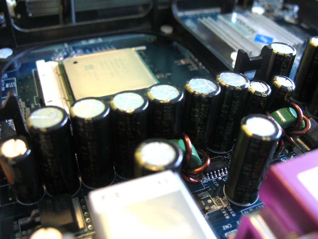

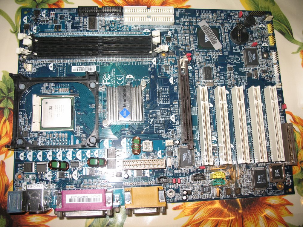

                            This time seems that everything is all right, this P4PB400 is running well.
                            I have recapped the board, rebuilt the PC and run memtest for 5 hours without problem.
                            I have reinstalled WinXP HE and some others SW and returned the PC to the owner.

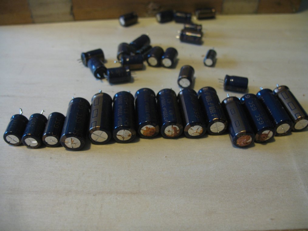

                            Here some pics: the Panasonic caps I received from RS, all 31 caps I removed from the MOBO, the cap-less and recapped MOBO, the cleaned HS and CPU FAN.
                            I recapped the DEER PSU and it seems to work properly.
                            Thanks all of you for your help.

                              Nice work!

                                Your recap is looking very good, and I do agree that the Deer even looks a bit ok as far as Deer powersupplies go

                                  Nicely done! The Pannies sure look proud in there.
