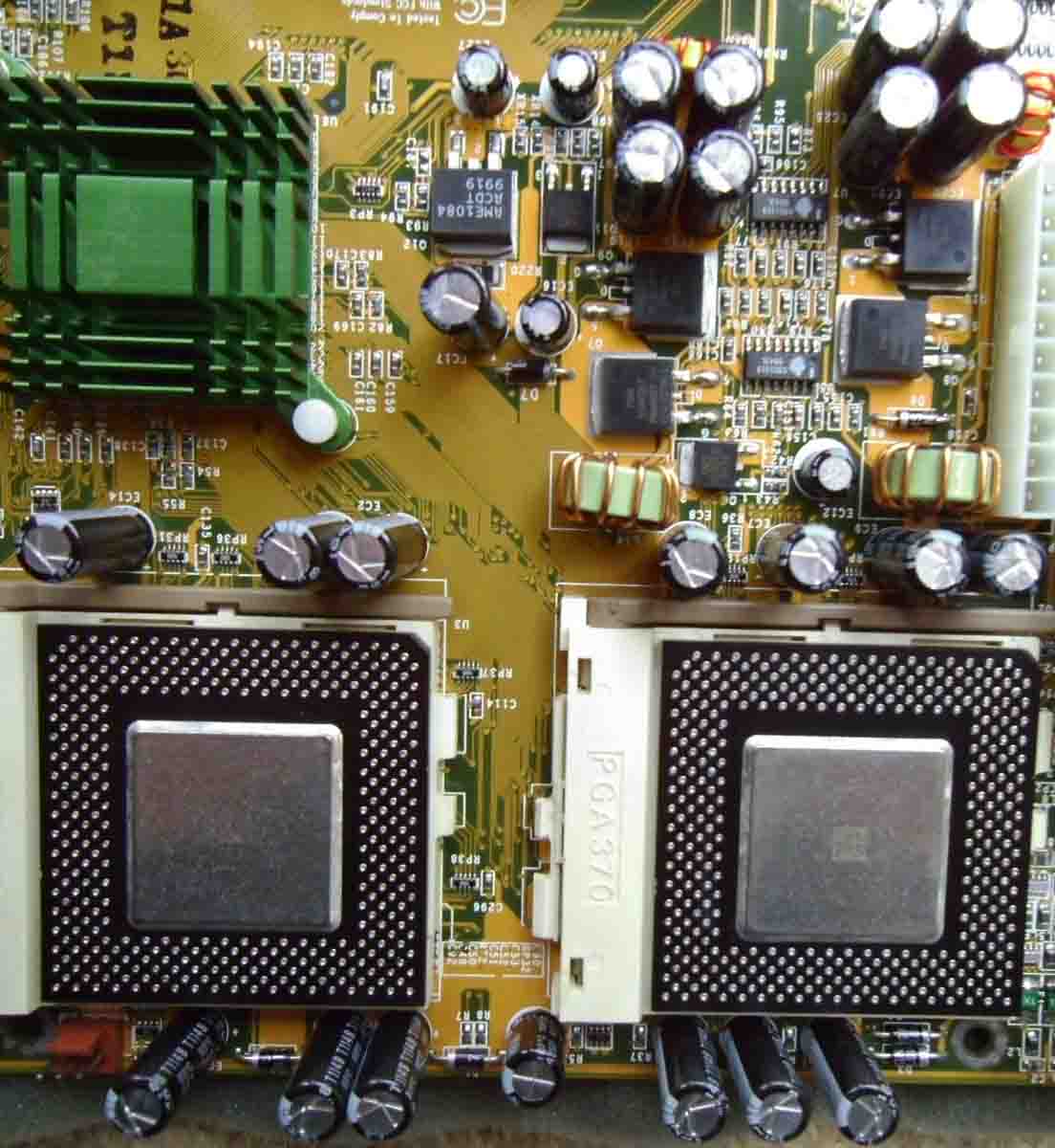

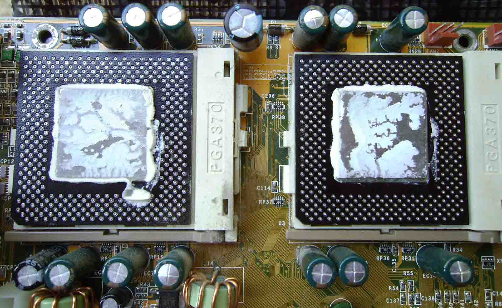

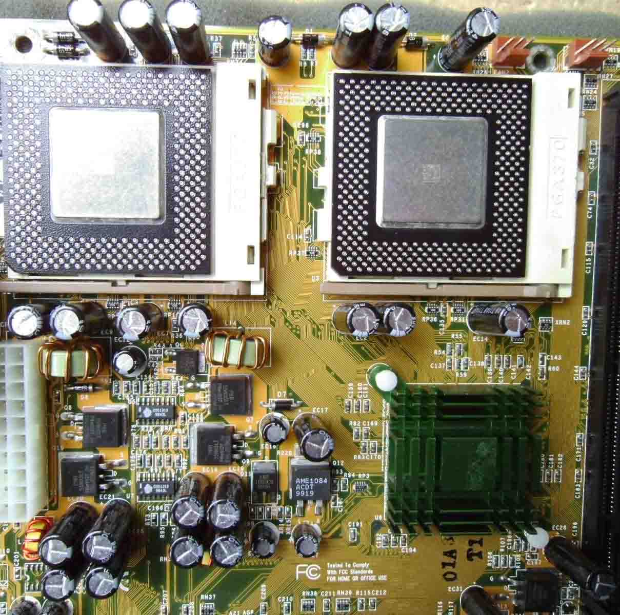

    Acquired this needing some TLC - original Tayeh bulging or about to, and oversize Jamicon 1000uf 16v used for EC10 mod

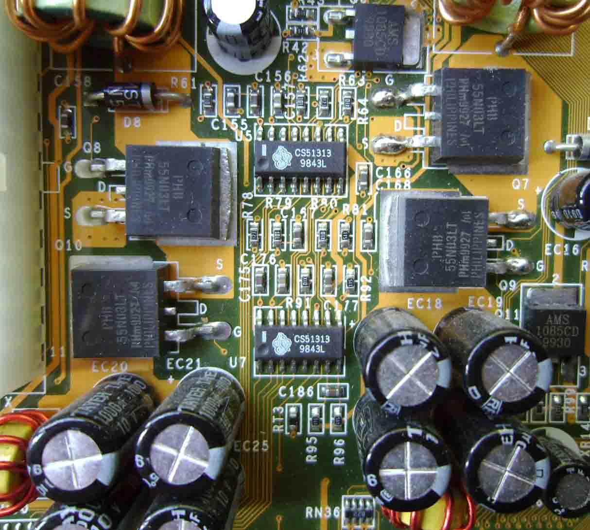

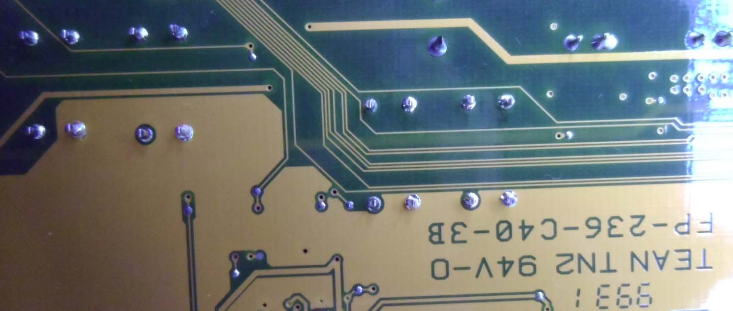

    Wondering about soldering of legs at Q7 & Q9, factory rework ? - Mosfets themselves identical to Q8 & Q10

    Tayeh 1500uf 6.3v replaced by Rubycon ZLH 1500uf 10v, EC10 now Nichicon HM 470uf 16v

      And Tayeh 1000uf 10v replaced by Panasonic FL 1000uf 16v
