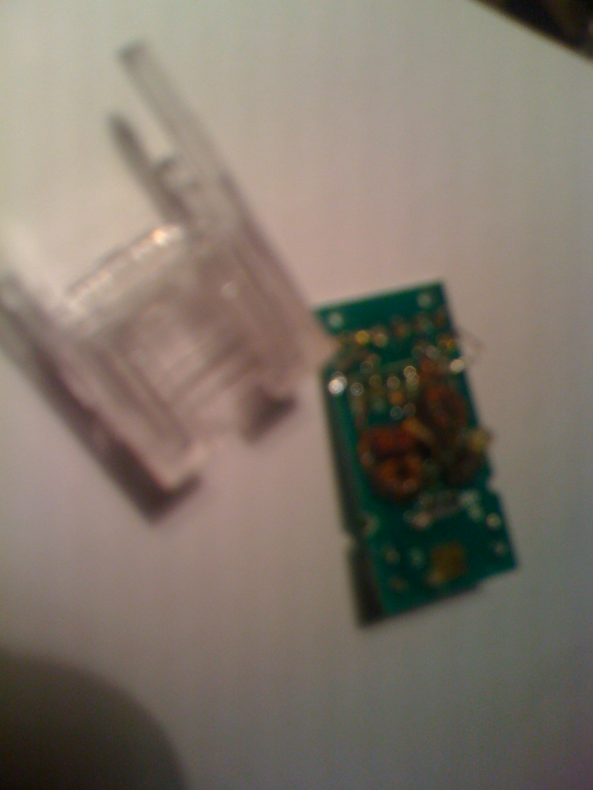

                I had to try.
                I removed the metal cover over the ethernet port on the motherboard and I was able to remove the ethernet chip by severing clean the connections of the chip to the motherboard.
                I put everything back together and plugged in the power..........nothing,
                I believe I did not damage the motherboard or the area around the ethernet plug, it was worth a try. I have a usb network port adapter and was ready to install it, but no change, still dead motherboard.
                I'm open to try something else, got any ideas?

                  Re: Dead Motherboard after storm
                  got a foto? i have never seen a motherboard wih a shielded ethernet PHI chip.

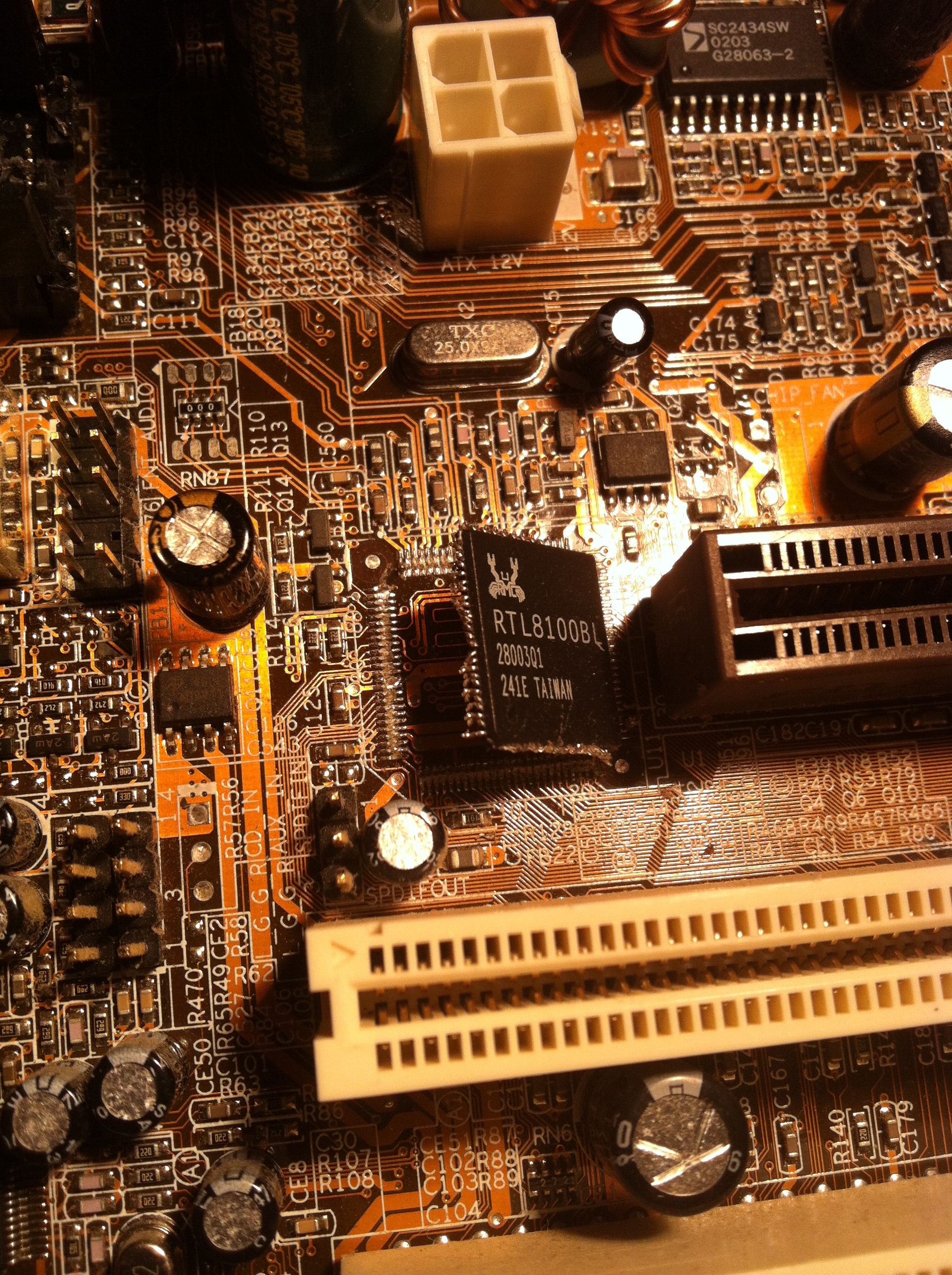

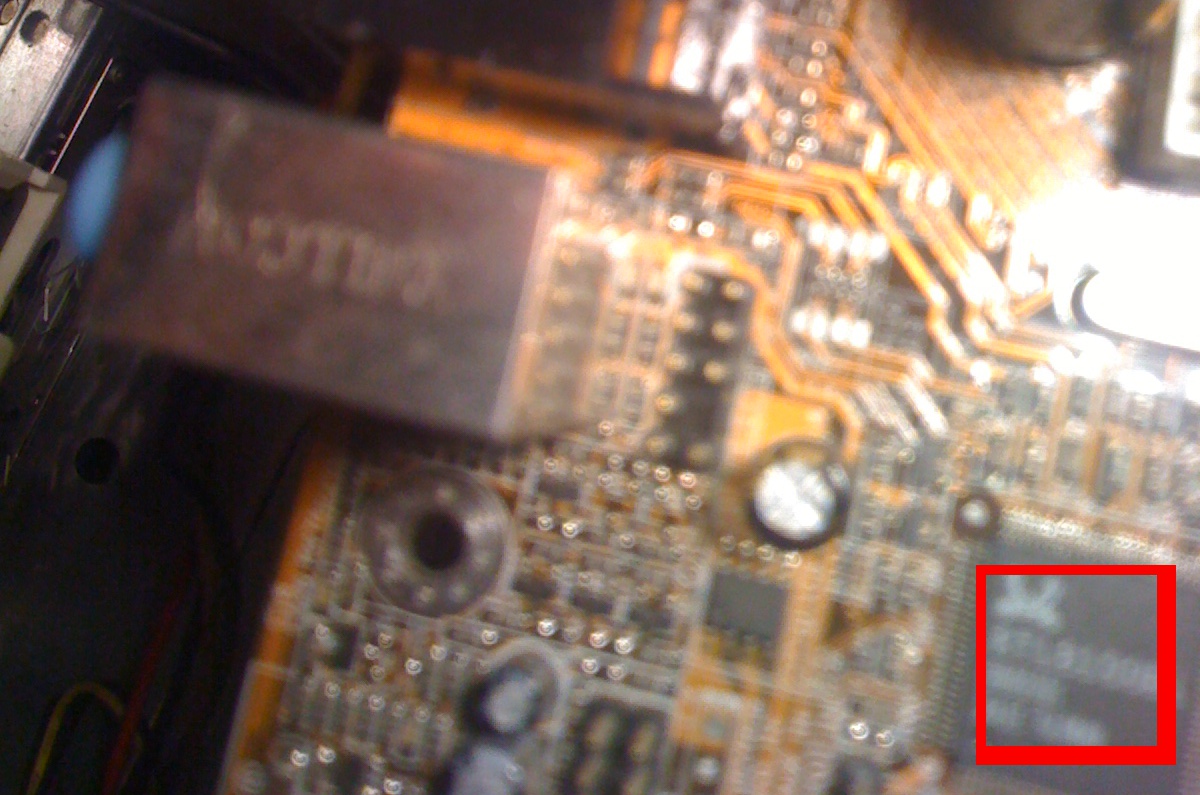

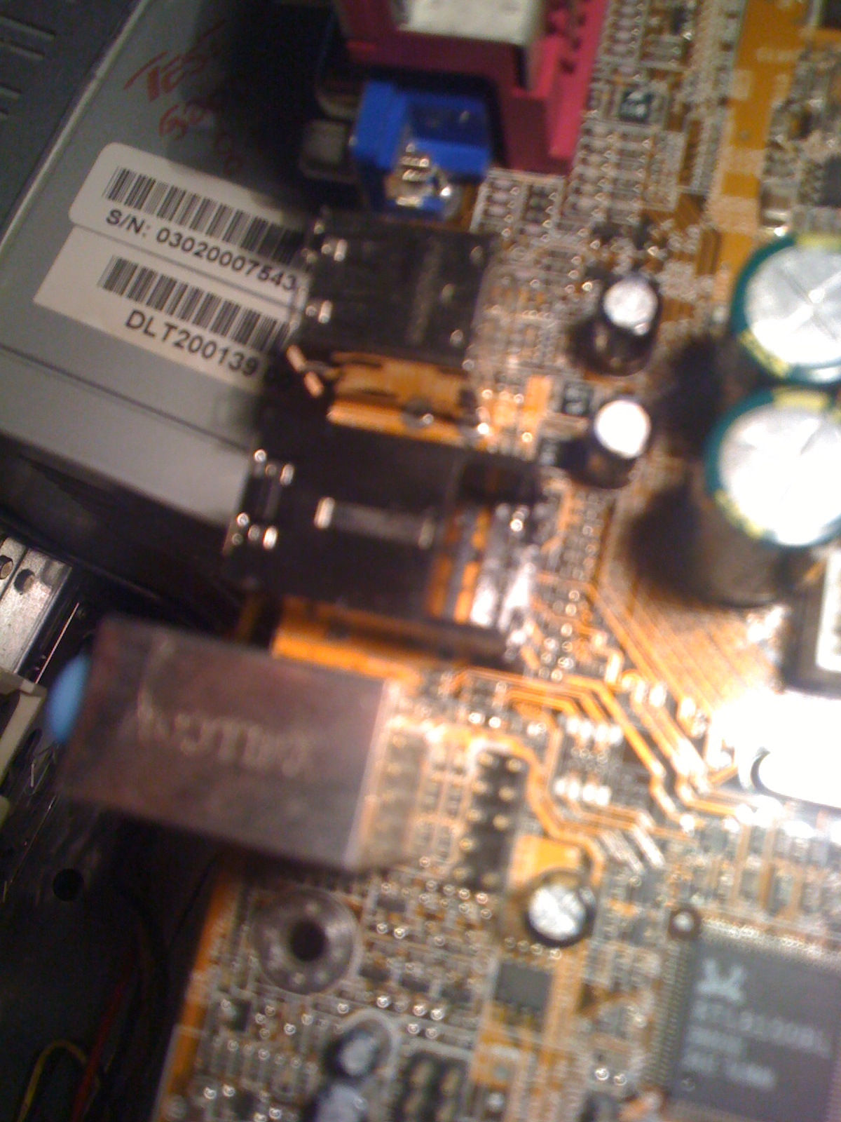

                    I took a pic before I put the system back together.
                    Don't tell me I pull the wrong part.
                    • goontron
                      5000!
                      • Dec 2011
                      • 4108
                      • US
                      From what I can see, it's the rtl813* But I can't see much, so I'm probably wrong about something. It looks like the board you pulled was part of the Ethernet, so no loss. A more complete job if anything...
                      Follow the white rabbit.
                        • 31248
                        RTL8100 network controller

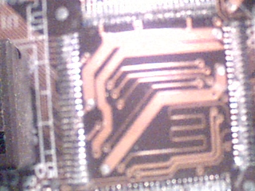

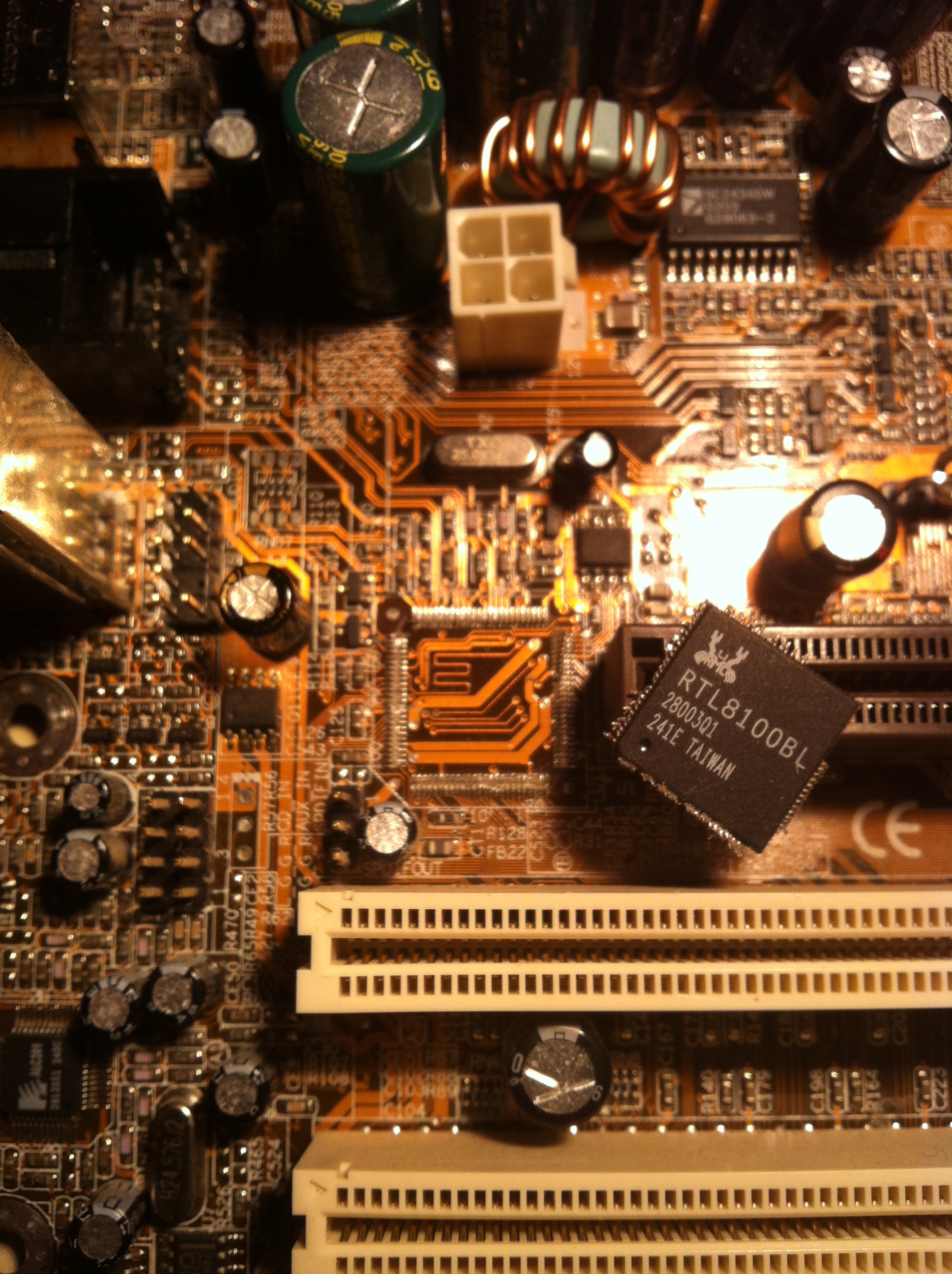

                                  • Bishop
                                    • Apr 2009
                                    • 99
                                    I was able to get the chip off the motherboard and it looks pretty clean.
                                    I tried to put a microscope at 10 power to the board but I could not get a real good focus because I couldn't get close enough.
                                    Take a look.
                                      Here's the chip off the board
