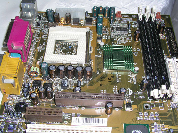

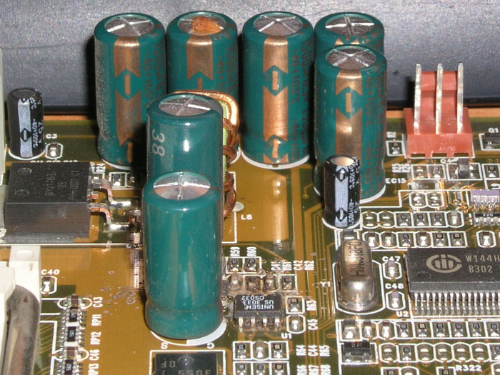

    recapped with panasonic FC. ran out of caps so did a few 1000uf 10V with 1000uf 16V.
    need to find a new european supplier to buy in bulk.

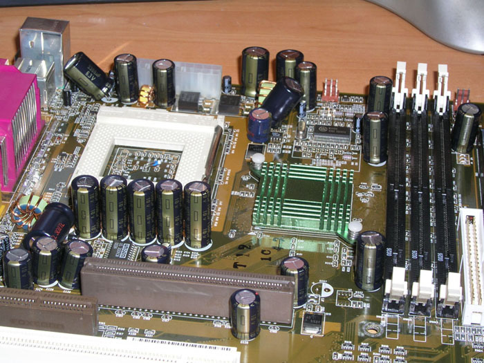

        willawake, you seem to be an expert of these VL6s
        I've got a piece of this mobo, doesn't even power up, the PWRBTN pins has ~2.5v on them. Do you have any idea what went out to lunch?

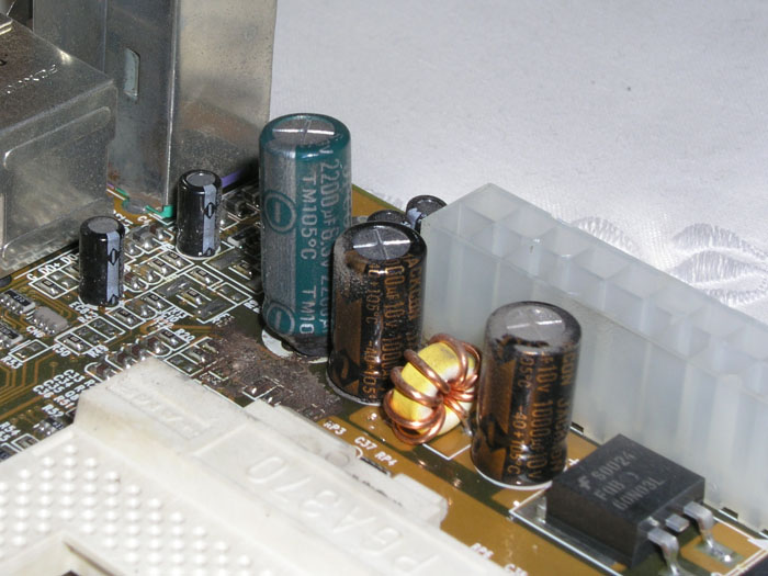

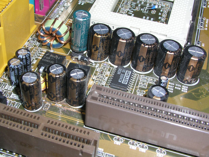

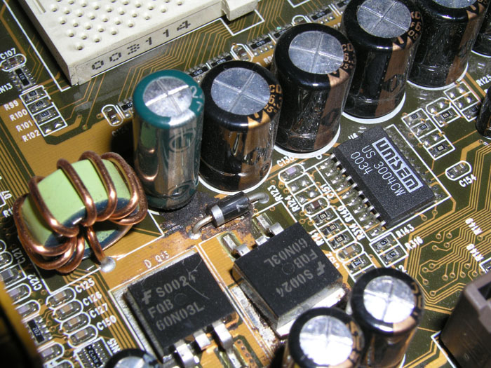

          hey wigyori...no i am no good for dead boards. better ask kc8/TC/Bushytails for that info. Did you recap the board already and it is still dead? The first board i did was dead after some cap(s) failed open. Those 2200s are nasty and leaking all over the smt components and Fets. anything looking burnt?

            Yep, I recapped it - some of it were already replaced with Yageo caps, seems like it was taken to someone at the first round earlier I'll ask them if they know something about these.
