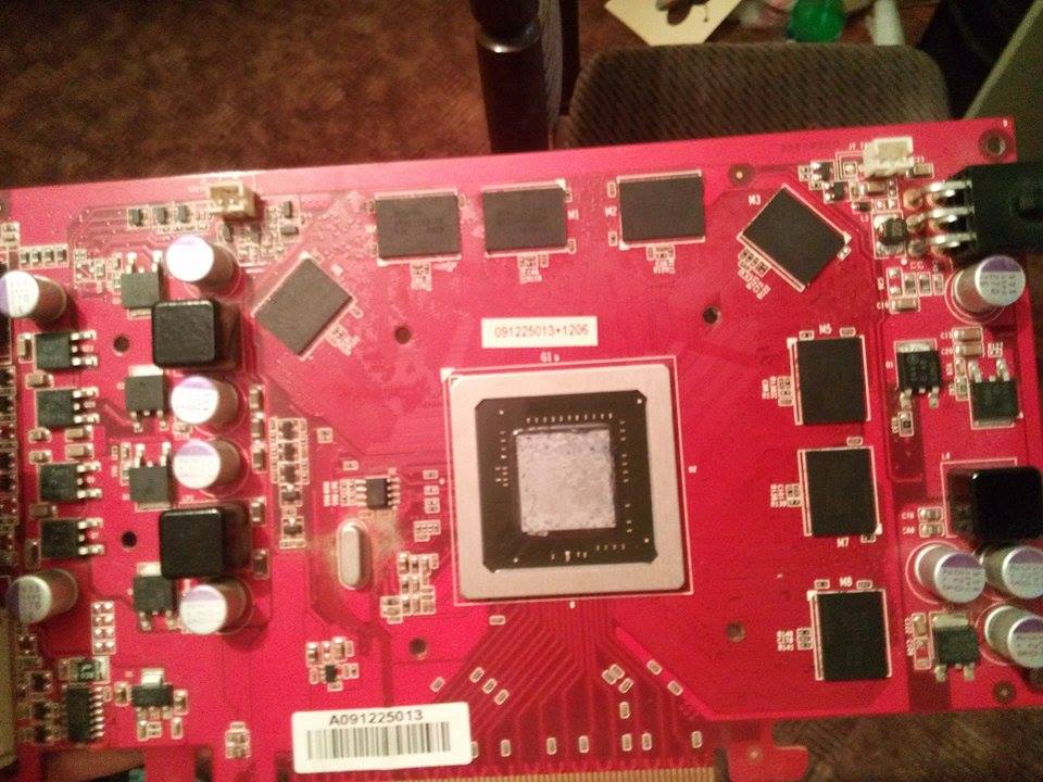

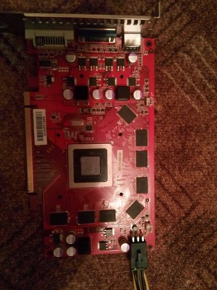

    hi, when I turn on the pc immediately burn the cables from psu to 6 pin on vga.
    • 31015
    Re: gts250 burn the cables from psu
    probably a shorted fet or shorted ceramic cap.
