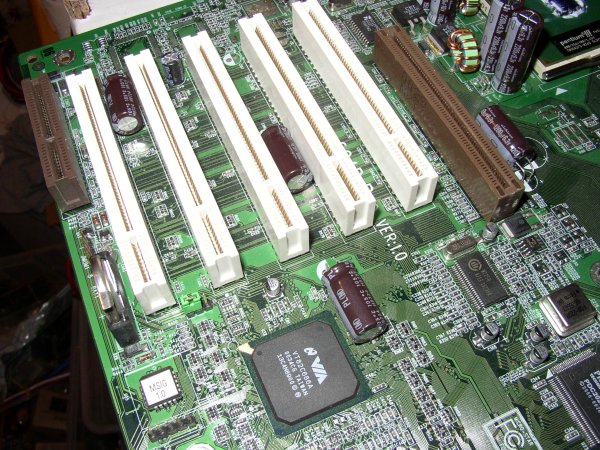

    6 Tayeh 2700 @ 6.3v. All buldging. Replaced with nichicon 2200 @ 6.3v PM series.
    1 Tayeh 1500 @ 6.3v. Looked OK. Replaced with same as above.
    4 Teapo 1500 @ 10v. Looked OK, but teapos tend to fail with no physical signs. Replaced with nichicon 1500 @ 10v PM series.
    8 Chhsi 1000 @ 6.3v. Half were domed. Replaced with nichicon 1200uf @ 6.3v PL series.

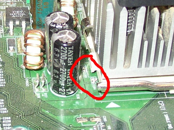

    After recapping, board posted perfectly with my testing cpu. Went to remove it to put in the real cpus, and noticed one missing smt cap and one damaged one next to the cpu1 socket. Was able to resolder the damaged one, but the other is lost for good. It looks like it's only a power supply bypass cap (in fact, it's in parallel with the new caps I just put in), and the board seems to work fine without it, but it still pisses me off. I checked the pics I took when I first got the board, and they're missing there too... so at least I didn't do it. still pissed off though.

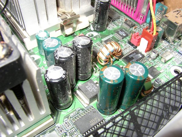

    Before pics:
    The tops of the black Tayeh ones are domed, even though it's not clear in the photo.
    Domed tops on the small chhsi caps.
    Damaged and missing SMT caps, visible in one of the "before" photos. Also another two slightly buldging tayeh caps and a buldging chssi cap.

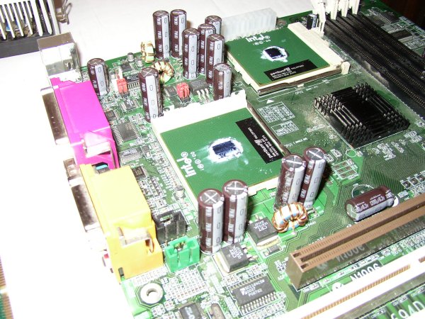

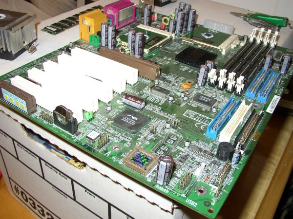

    Overview of the board. Yes, all 22 are visible. Mmmm, shiny!
    CPU-area capacitor clusters. Also shiny.
    Sideways caps... They'd stick up unacceptably if I put them in normally.

    Seems to work. POSTs perfectly and reliably with both CPUs in, and voltages appear solid. Haven't done any endurance testing yet though... that will wait until I put it in a box and set it on my desk.

    damn that really sucks, some clumsy bastard was installing the HSF or something. Is that yours or are you buying to recap and sell?
    what is that for?

      Bypass capacitors serve the same function as the large electrolytics, but at much higher frequencies. Electrolytics typically have a much higher impedance at high frequencies, and even the traces on the board have significant inductance when you're talking the frequencies digital logic runs at.
      Imagine an inductor between the filter caps (the big ones we all have seen way too many of) and the cpu. This inductor represents both the inductance of the traces and the inductance (non-ESR part of the impedance) of the filter caps. When there's a sudden surge in power draw (say, every clock edge, when CMOS logic draws virtually all of its power), the inductor won't allow the current to change quickly enough, and the voltage would drop. To combat this, a small ceramic capacitor (ceramics have much, much lower impedance than electrolytics) placed right next to the cpu (i.e. after the inductor in the example) is used to supply the highly variable load.
      If you look at any high-speed logic board (video cards are good examples, look next to the ram chips. On motherboards it may be a lot harder to find them among all the other components.), most every IC will have a ceramic capacitor next to it, to get around the inductance of the traces.
      And, when checking my 694d board to see how easy the other bypass caps were to find on it, I noticed a SMT electrolytic is broken off. Blah. I'll tack on a radial tantalum in its place.
