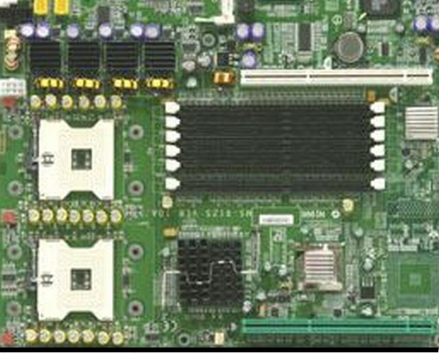

    Hi I have the following motherboard and it has a broke off capacitor the 2.5v 820UF yellow/black i have searched and searched for a replacement with no luck i came to a post on these forums suggesting "better to recap with reliable 1500uF 6.3v Ultra Low ESR E-Caps, instead of these old yellow Fujitsu polymers." im wondering if that is best for my situation and if im going to do this to the 2 capacitor will be be fine or will i need to do this to all 22? Thanks!

        I'm located in Kansas city Missouri I've got 24 6.3V 820UF caps I'm wondering if it would be alright to install just one or best to replace all 24?

          Not that it will probably make a difference but I mean replace all 22.

            Have you tried the board? With just one capacitor missing out of 24 it should still work fine.

              if same brand/series just 1 is safe.1 missing should not hurt either.does it still post?

                well if you just broke one off then you will probably get away with just replacing the one with no worries "preferably same type (brand series)"
                As harvey said it will probably work fine without it anyway, but ideally replace it
                Is that MB dual CPU with 3 lines of caps 2 X 7 ...1 X 6
                ( a crop below)
                They look like part of the VRM those 3 lines
                if your soldering skills are not the best then thats further reason not too...go read the FAQ's and learn how to use the needle for hole clearing
                (or dental pick) practice on junk first.
                Thats possibly a nice MB and you don't want to stuff it.

                  It is that exact motherboard from your picture. And looking at that picture it is the very bottom far left yellow cap 2.5V 820Uf like i said the best replacement i can find for it is the 6.3V 820UF. I need to do what ever im going to do with it in the morning because it needs to be in service by afternoon. so if anybody can tell me the best thing to do in this situation i would appreciate it. Thanks

                        Give me the numbers off both the wayward and prospective replacement caps.

                          original cap has a little m and then below that is... 34267. and the new caps i bought from jameco SKU number 607355. MFG# UPW0J821MPD

                              BTW I am assuming its the bottom line on the left hand corner as the cap that got ripped off
                              but any in those 3 lines should all be the same type, series, ideally

                                Too late to be helpful I'm afraid, but digikey has Nippon PSA polymer caps in those specs. They should be 8mm according to the datasheet, don't know what diameter your board's pads are laid out for. I have some 680uF PSA's, but not the 820's.
                                Jameco doesn't have any normal electrolytics that are very suitable for motherboards (unfortunately). The PW caps you bought are the grade you'd find on a Pentium-2 board, but not something this modern.
                                Not sure if it's better to add the PW in parallel with those polymers, or just leave the pad empty. I'd be inclined to leave it empty, I don't know what having that PW in there would do to it's behavior.
                                It looks like all those polymers are probably in parallel to filter Vcore, so leaving 1 pad empty out of that many total will most likely not cause any problems. It should be designed in anticipation of the caps degrading as they age, so the loss of 1 cap should be within it's tolerances for the time being. If the CPU in the adjacent socket isn't near the board's limits, then there'd be even less cause for concern.
                                Assuming reliability is more important than the money, the best solution might be to order a replacement board, quickly swap it out at an appropriate time, then fix the cap on the other board when you find the right substitute (or just sell it off).
                                Not sure what that number is, but the "M" sounds like Panasonic. If it's by them, it should have a capital M in a little box.
                                If it broke off like that, the caps might be surface mounted, not through-hole. That would make replacement more tricky/dangerous because you have to solder at the top of the board.

                                    The original cap is Fujitsu with a very very low ESR rating.
                                    The M = Tolerance = +/-20%
                                    34267 is only a date code.
                                    Historically Fujitsu does not mark the series because the ESR is so so low it doesn't really matter.
                                    ESR is probably .007 and Ripple between 5000 and 6000.
                                    UPW0J821MPD is a PW series which is barely a low ESR cap.
                                    ESR is .085 and Ripple is 730.
                                    You will need 10 or 11 UPW0J821MPD to handle as much Ripple as that one Fujitsu does.
                                    As gdement said, Digikey has PSA series polymer caps that will work.

                                        http://search.digikey.com/scripts/Dk...me=565-3057-ND
                                        APSA2R5ELL821MHB5S
                                        2.5v 820uF 8x11.5mm ESR=.007 Ripple=5580
