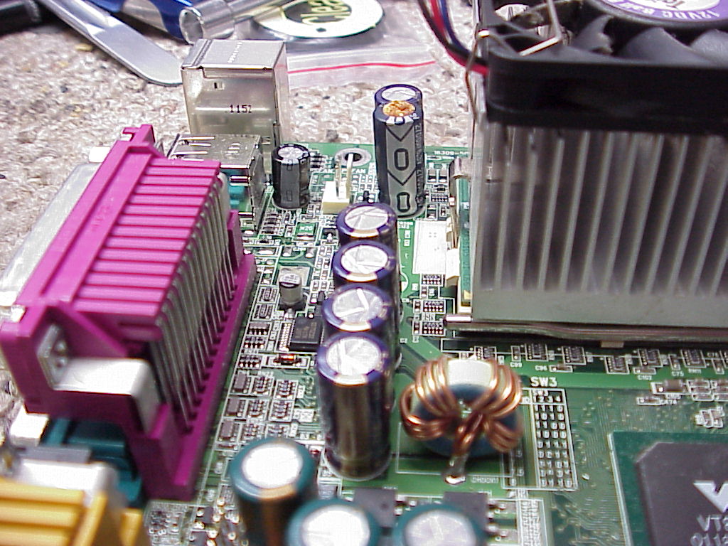

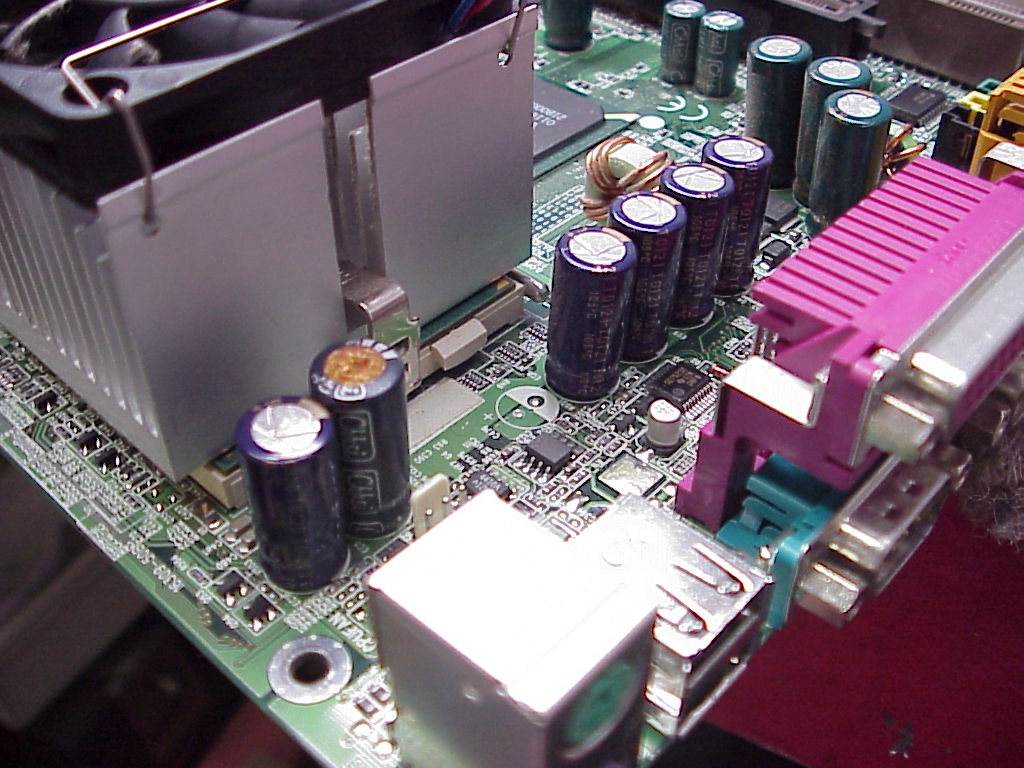

    Wtf?
    1 chssi in a row of mbz

    Re: Wtf?
    Never recapped before? Really stange ...
    Perhaps the board manifacturer run out of Rubycons and employed this Chssi: there are other chssi near the Agp slot.
    Zandrax
    Have an happy life.

      Re: Wtf?
      Which brand and model of motherbaord? Seems like MSI....

        Re: Wtf?
        iirc it was an ms-6309.
        and all the chssi got replaced.
        customer reported random reboots.recap fixed it.
        my guess is the lone chssi was in the machine still after being loaded with rubycons.

          Re: Wtf?
          Those Green/Gold Teapo SX (?) should also go - they've failed silently without bulging in the past.

            Re: Wtf?
            those were tayeh and were open.sizzled and stunk when i desoldered them.
