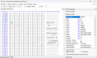

                i've found its original backup (The one that light blinking ) can you know which version is it ? and how to fix its serial and model data ?
                • m1ch43lzm
                  • Mar 2019
                  • 1126
                  • Peru
                  It's 02292
                  DMI 72E000-72E0FF
                  Copy/overwrite that range with hex editor to the clean BIOS
                  Attached BIOS with S/N inserted
                  5CD5253TW5
                  L1S95EA#BH4

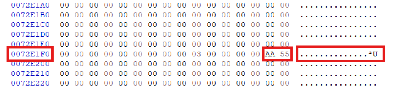

                    • hicham07
                      Programmer
                      • Jun 2016
                      • 10
                      The problem now FAN speed is not slow and not very high .. and display show nothing at all and even keyboard doesn't show lights ..
                      i think its due to the missing AA 55 its missing even in backup file and 02292 has it ... it add 1 kb to the bin file ... i hope this time it will show something really thank you for your help guys
                      Click image for larger version  Name:	image.png Views:	0 Size:	7.6 KB ID:	3709366

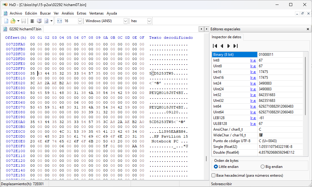

                      • m1ch43lzm
                        • Mar 2019
                        • 1126
                        • Peru
                        That's the issue, it shouldn't add anything when you paste the offset with hex editor, instead it should be replaced, Paste overwrite
                        Try post 9 as is, I already added the S/N
Name:	Captura de pantalla 2025-08-21 183717.png
