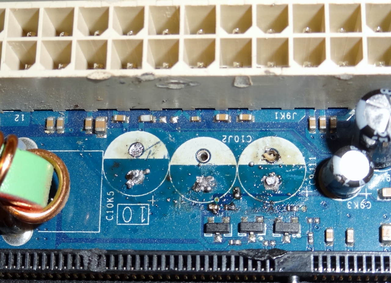

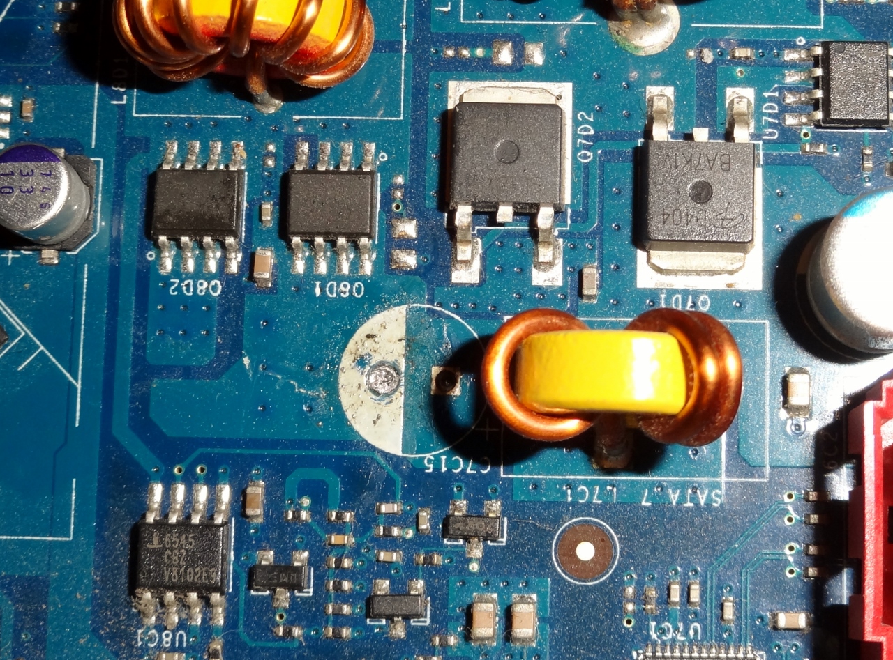

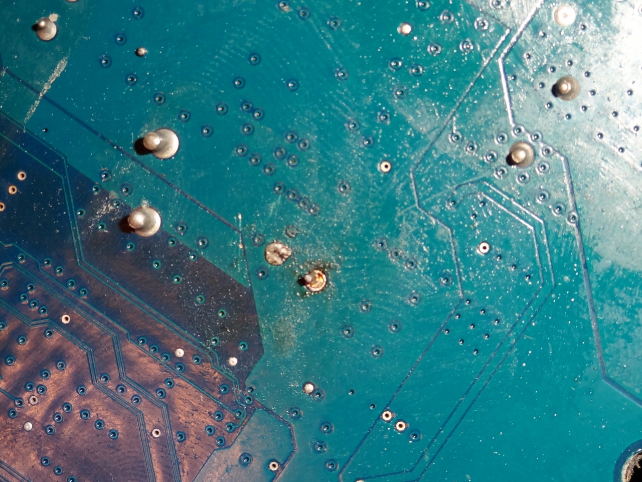

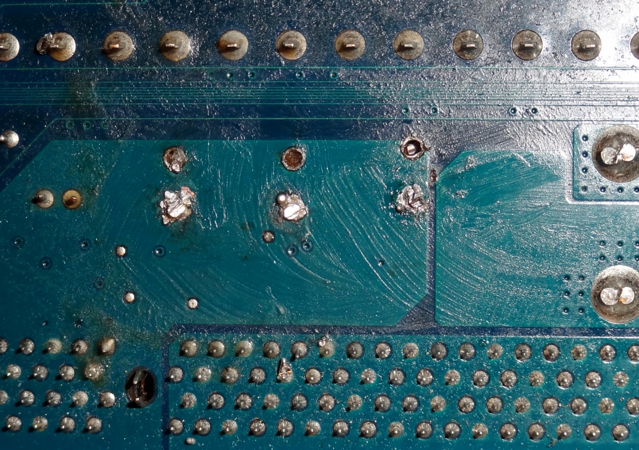

    Really struggling with this board, Dell XPS NVidia 790i 775, tried removing 5 caps but its been a nightmare. Ended up just pulling them out and most of the holes are blocked with fragments of the leg remaining.
    Don't understand why its so hard, its like the solder around it in unmeltable.
    Iron is 60w and desoldering gun is 80w
    Tried adding more solder but it seems to not stick properly to old solder. When I melt it seems just like its floating on the surface of the board.
    Tried putting delsoldering gun on one side and soldering iron on other end, which worked for about 3 holes but nada on the others.
    Don't know what to do, contemplating trying to drill them out now with a fine bit.
    Have ordered some super fine tips aswell in hope I can poke through but I doubt that will work.

    Try putting some flux on to the solder joints then tin iron and desolder.

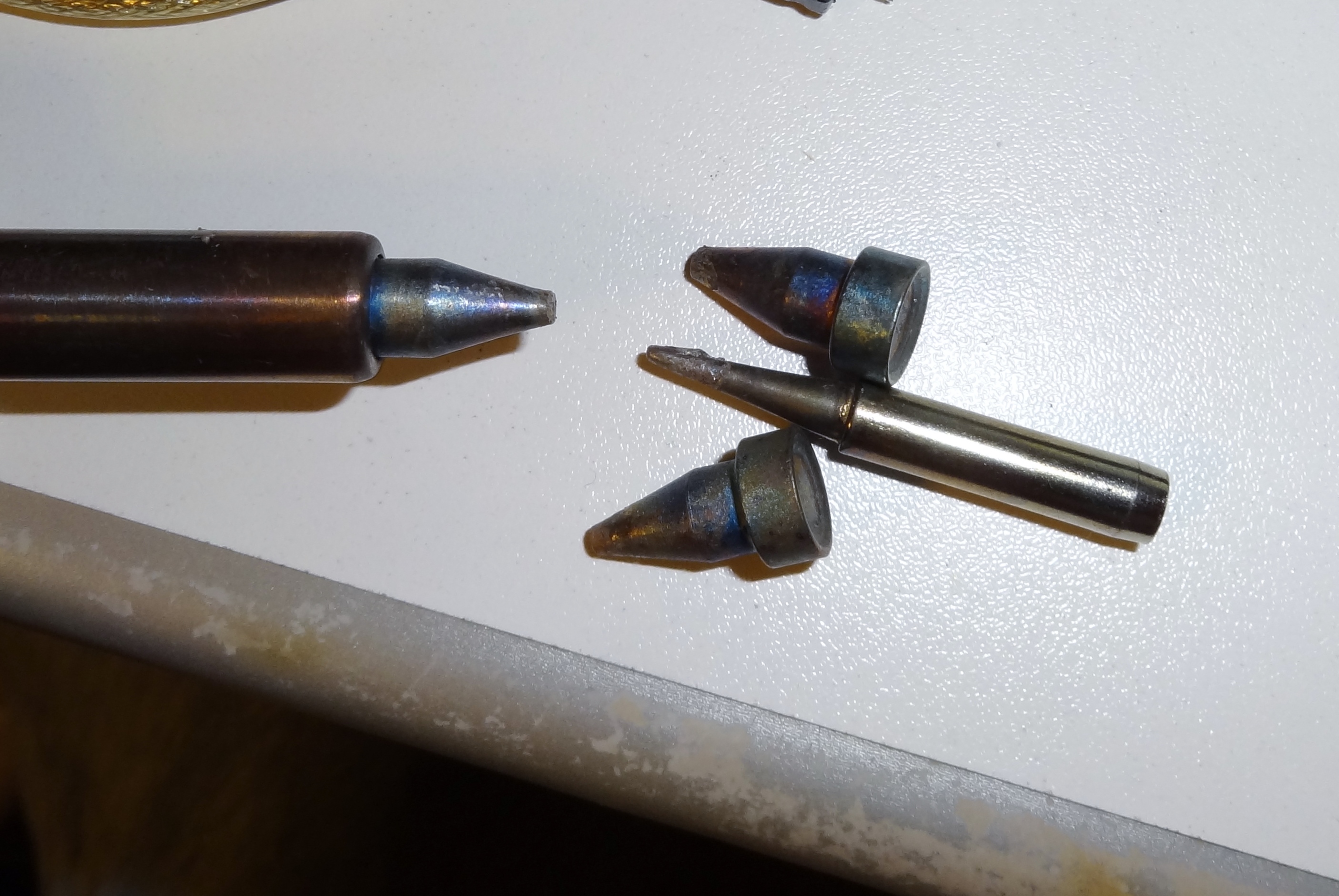

      Have been using flux, I think my tips have had it as I didn't know about tinning the tip. Will do on the new ones ordered.

              is it fair to say these tips are dead? and probably one reason why im struggling?

                  no such thing as a dead tip.
                  your temp is probably too high - you should never need more than 350'
                  put some fresh solder on the tip and then give it a good clean with a brass wool tip cleaner.
                  what solder are you using?
                  i never need more than 310' btw.

                            I don't think your tips are shot. They just need cleaning and tinning is all.

                                        i as refering to the oxidised blue tips.
                                        if your temp is too high the flux burns and the tips need cleaning.
