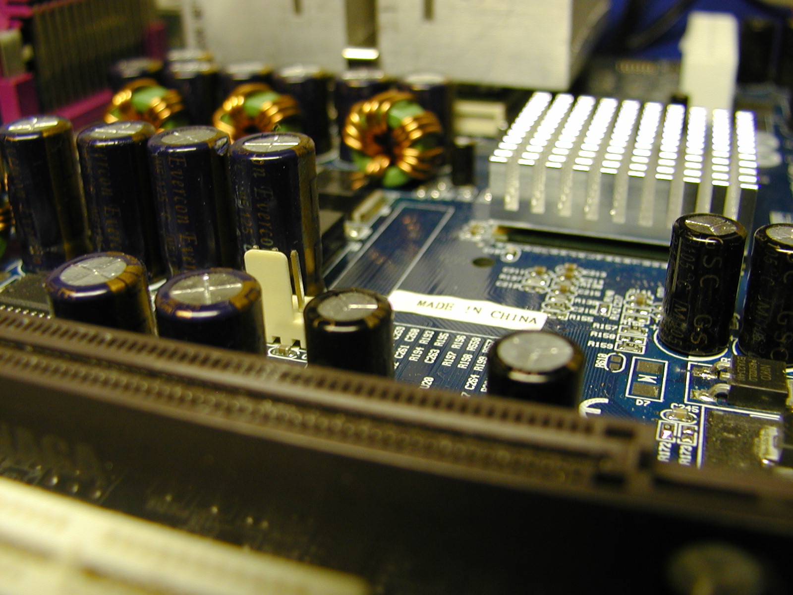

    The first thing I pulled from the pile was a Jetway V266B. First off, the caps suck.
    Only three brands of caps, Evercon, GSC and OST. To make it a little less appealing, both the north and south chipsets are VIA however it will happily support my Athlon 2000+ (at a speed of 1.66Ghz) AND it also permits you to use either Sdram or DDR ram and supports up to a whopping 2Gb of memory!

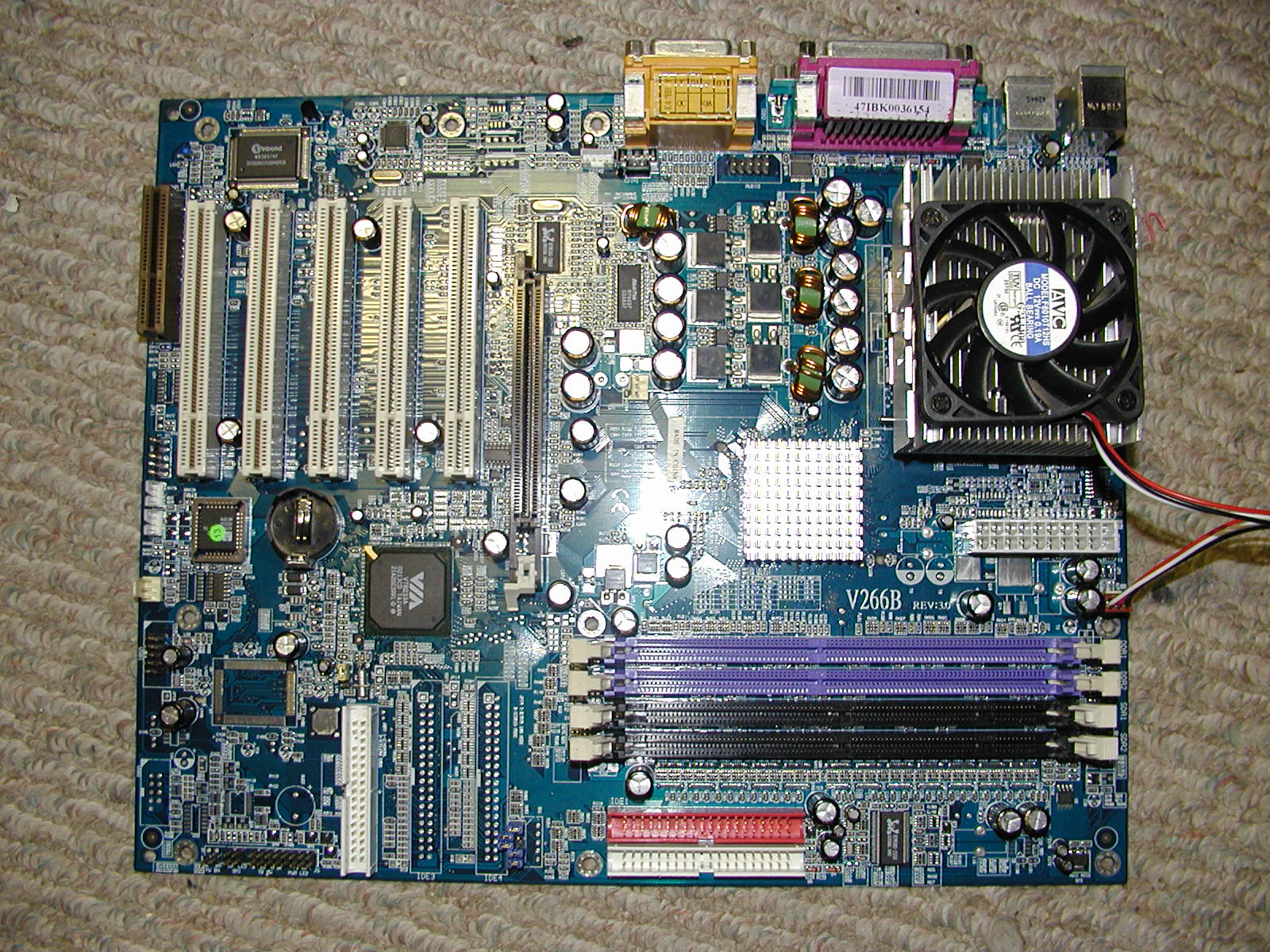

    Here are photos. I forgot to post them earlier.

                Anyways, so is this board really worth a recap or should I just give it a toss and hope something better comes along?
                a) Yes, recap it and use it.
                b) No, find and use something else.

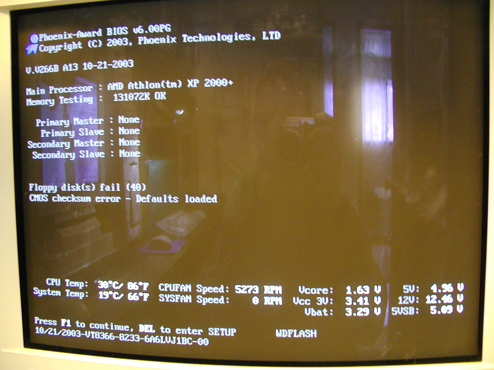

                  I am not convinced, that recapping may solve the problem this board has. So i would test it by resetting CMOS by jumper, may be you can solder just a few caps over the most bad ones to try it out (ghetto style recap)
                  If you can not manage it to boot it up properly, toss it.
                  Otherwise it should be a fairly stable Linux platform, kt266 should be ok especially when recaped.
                  • pentium
                    • Mar 2006
                    • 2778
                    Re: Jetway V266B worth the recap?
                    I reset the CMOS and tried again with a stick of PC133 Sdram and we got a post!
                    It can see the processor as an Athlon 2000+ (at 1.66Ghz) and I didn't have any lockups in the bios.
                    One thing I did note was the CPU warmed up pretty fast and the CAPS and the FET's started to get pretty warm as well.

                        I think I am using the old heatsink but the fan is completely new. (see the photos)
                        If it is going into the old Dimension I will be blessed with a rear fan and direction shroud that fits over the heatsink PERFECTLY!
                        Speaking of that, I did a test fit and I'm surprised that this board is fitting so well. Everything lines up and aside from a few adjustments to make the front panel work, all I need to do is swap out the PSU and knock out the second serial port on the rear plate and we are ready to go (after a recap of course).
