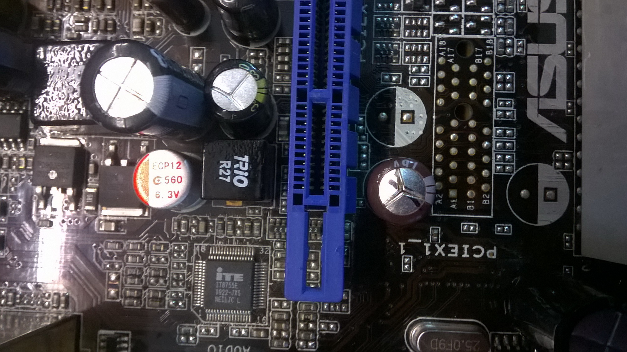

    Hello.
    I have a Asus P5Q motherboard. I replaced all the capacitors. motherboard will not boot. just a little shook fans. I disconnected 12v rail. motherboard lights up, the fans are spinning. but I almost immediately exploded capacitor 470uF next graphic slots. are something shorted near that capacitor?

    I have read in the forum and I quote "Be careful of polarity, Asus puts capacitors the other way around, the filled section on the pcb is the positive side of capacitors". Perhaps because of this??

      I looked at an old Asus board. I turned them wrong. Tell you whether it works when I replace them again.

        Re: Asus P5KPL blown capacitor
        unfortunately turning them may not be enough.
        You should really replace with new as they may be damaged.
        If one exploded think how damaged the others might be
          Yup. I've done that plenty of times with ASUS boards. All the more reason I hate them.

                  Also, when you desolder a capacitor and replace it, you can have the board sitting so the negative faces in one direction, like, to the right, for example - so you will know which way to put the new one in. Of course, if you forget which direction is the negative ... well, yeah. Just check to see which pin is which with the multimeter like kevin! said.
                  Also, you can take a few pictures of the board before you re-cap it
                  That way you can look back and see which caps are connected which way. And possibly even which value of caps go in which spots.
                  Muh-soggy-knee
                    always take photo for ref
                      always
                      round hole is negative.
                      square hole is positive
                          Always look which way old capacitors are mounted in motherboard. Just recently replaced some caps in Asus P5K and when reapplied power they immediately blowed. I took a closer look, and also searched some info from internet too - it seams that in many asus boards + and - pcb markings are wrong way. I can confirm this as I compared P5K with another (older) motherboard. Then I just replaced the blown caps with new ones, soldered them 'wrong way', and P5K worked again!
                          So it's important to check how the capacitor is mounted, not to trust on pcb markings.
