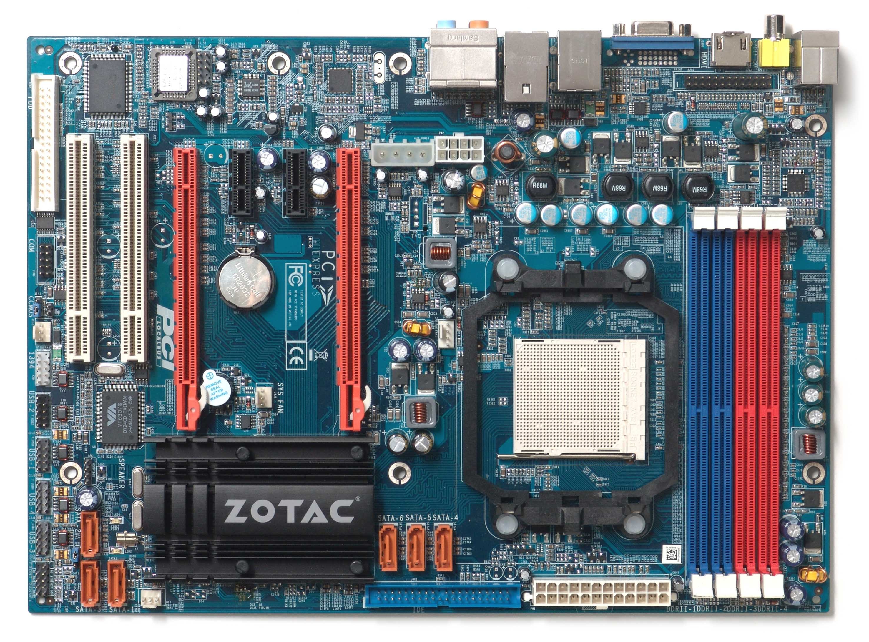

    Hi all.
    I am fairly new to replacing the capacitors on motherboards and wondered if anyone could let me know which caps i need to replace the following 3 on the board in the title.
    They show as
    Teapo (Green and Gold colored)
    1000uF
    6.3v
    SM105*c
    10/08
    A3T1
    If anyone could spec out a complete board recap that would also be great.

    Is this your board here?
    https://www.badcaps.net/forum/attach...1&d=1427245082
    What country are you from? And where do you plan on buying your caps from? That's going to have a big bearing on what options are available to you.
    Assuimng you are in the USA, you could use these to replace the caps in question - https://www.badcaps.net/store/produc...roducts_id=131
    There appear to be some larger teapo capacitors there too, which I would recommend replacing, but I can't tell from that picture what capacitance and voltage they are.

      Thanks for the fast reply.
      I am in the USA and that does seem to be my board (except it is blue and mine is brown)
      Thanks for the info on the caps. The bigger caps are 1500uF 16v.
      Would these work?

        They would, except it appears that they are out of stock. You can use these instead, though - https://www.badcaps.net/store/produc...products_id=38
