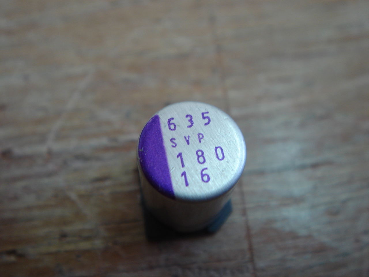

    I just bought a damaged EVGA 8800GTS 360MB Super Clocked card from someone online. All the silver caps were broken off apon other things that were damaged in shipping in the past.
    Anyways i need to know what these aluminum caps with a plastic base are called and were i could buy some replacements?
    The guy told me the numbers off the top of the caps.
    From top to bottom:
    648
    SVP
    180
    16
    Ofcourse i have no idea what any of the numbers mean..
    Please help me out.. i'm hoping i can repair the card and give it to my Godson for Christmas.

    I think they're Sanyo Oscon SVP series, 180uF, 16V, possibly manufactured in the 48th week of 2006.
      Hey thanks!
      So i could use any other brand Alumium Cap rated 180uF, 16v?
      Can you tell what the size of the cap is? heh i dont want to order caps of the same rating and they come in too large to fit.

          Yes, they are ok, but Oscon SVP series is probably the most reliable polymer cap.
          SVP series isn`t just an aluminum electrolyte capacitor, they are solid polymer too.
          I hope your have realized, that the broken black component is not an capacitor.

              You can buy Vishay/Sprague replacement 180uF 16V from Mouser

                        Don`t get me wrong, you can use this UCC caps, they are used on many components recently.
                        Mauser does carry the Oscon caps too. Just click on line pdf cataloge, same page.

                                  Are you want to find this one? OS-CON SVP 180uF 16V D8x12mm.
