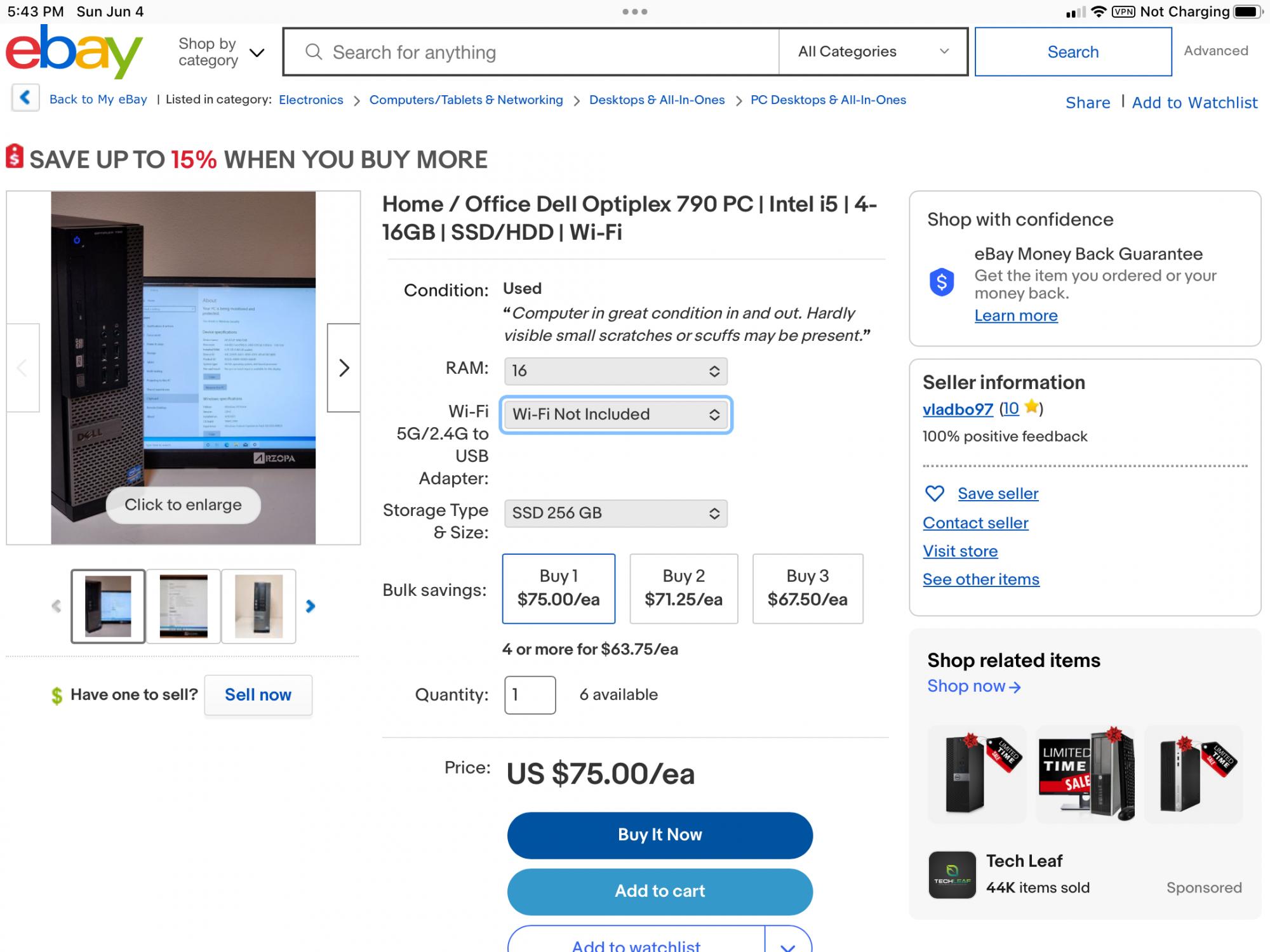

            I would love to use a Dell computer however I can not find restore disk like I can for the HP Elite 8300 because I want to have it like it was new but I am all for it but I am wanting a series that was used for business purposes not ones for home use I find that they are better quality
            I found this on EBay is this a good price for what the seller is offering
            I also found this for reinstallation disk
            https://www.ebay.com/itm/25604040776...Bk9SR7y_pIWRYg
            Are these two items a good combination choice for what I am wanting to do

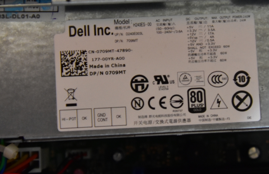

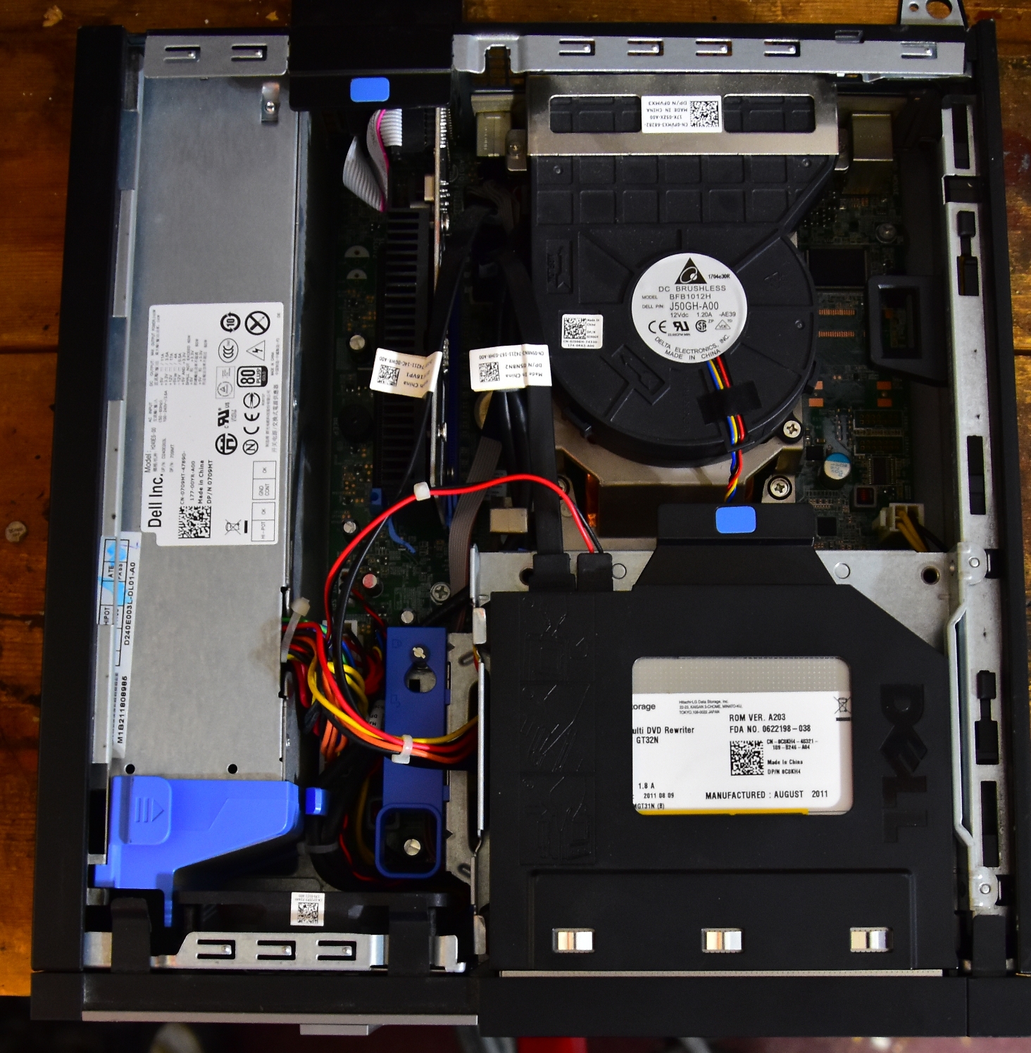

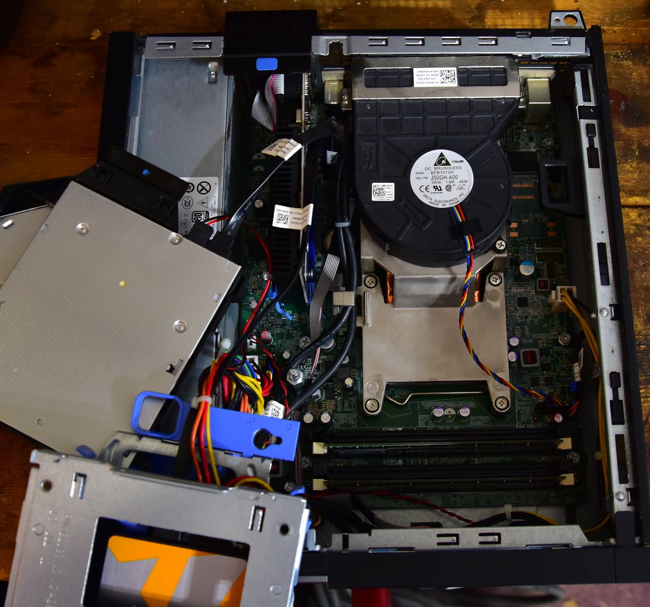

                If you go with an SFF there isn't much of an advantage of the Dell over an HP. While the Dell will have a standard 24-pin ATX connector vs the proprietary connector on the HP, the PSU is still a non-standard size, only the mini-tower is going to provide much of an advantage.
                Something like this would be a better option unless you need an SFF/Desktop form-factor: https://www.ebay.com/itm/29570777977...Bk9SR9TS14iRYg
                Given how cheap SSDs and DDR3 RAM are these days I also wouldn't pay a premium for a system that already has 16GB of RAM and an SSD.
                That Dell disc should be fine to re-install windows if you must have an "official" install (note these usually come with bloat-ware, though it usually isn't as bad on business systems), but otherwise you can just download the install images from Microsoft: https://www.microsoft.com/en-us/soft...load/windows10 and Windows 10 will install on anything with a 7/8/8.1 key. In most cases Windows 10 will install the appropriate drivers automatically, and you can generally get them from the PC manufacture's web site if needed.
                This is what the inside of an SFF OptiPlex 790 looks like:
