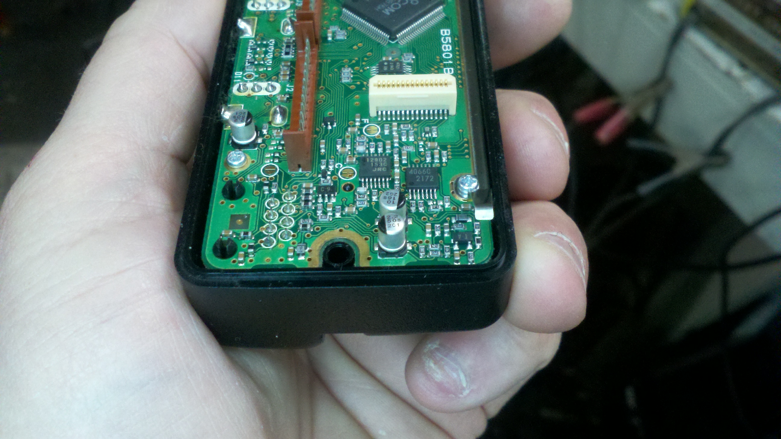

icom v8000 bulged smd caps
  • kc8adu
    • Nov 2003
    • 8832
    • U.S.A!
    in the face.
    first bulging small smd i have seen.
    • 31066
    Re: icom v8000 bulged smd caps
    what voltage is it, and dont say 50.
    i'm just thinking as it's only 2.2uf a tant may be better.
    • kc8adu
      • Nov 2003
      • 8832
      • U.S.A!
      i will use 25v tants.
      highest voltage is +5.
      • mmartell
        • Oct 2013
        • 3189
        Have you measure it ? I mean, is the device not working right ?
        • kc8adu
          • Nov 2003
          • 8832
          • U.S.A!
          it howls.
          • Agent24
            I see dead caps
            • Oct 2007
            • 4968
            • New Zealand
            How old is that thing? Might pay to replace the lot. I recently replaced all the SMD electrolytics in a Roland KR3500 because after many years they were ALL leaking, and for some it wasn't even obvious because the plastic base hid the evidence.
            Not one was bulged, either.
            -David VanHorn
              • 31066
              i'v never actually seen one bulged, just leaked.
              i didnt think the bung was good enough to let them build enough pressure to bend the can.
              • japlytic
                • Oct 2005
                • 2086
                Some of the early SMD electrolytics are prone to failure, especially in devices which can get hot inside.
                I am also curious if there were SMD electrolytics which were not solvent resistant.
                • yildirim05
                  • Mar 2015
                  • 11
                  • turkey
                  OK
                  +frekans and high power tx capasite termal uff
                  TA6ANO
                  • ben7
                    Capaholic
                    • Jan 2011
                    • 4059
                    Interesting. Also, they seem to look like they were made by Panasonic. The text font and clear (easily visible) lettering reminds me of them.
                    Perhaps there is a faulty circuit design? Or maybe the cap was manufactured incorrectly. (I see it's plastic base and band match the other caps, but maybe it was marked the wrong way around)
                    But, damn, looks like that thing is ready to launch!!!
                    How old is the device (radio?) that this was in?
